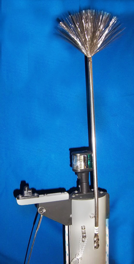

Curious as to why?
The use is to help dissipate static charge build up on your boat's mast that occurs just before a strike. Like grounding the static electricity charge when wearing a wool sweater.
I have one, but all I can say it is like my anti-Elephant charge whistle. I blow that whistle every day and still no Elephants, so it must work.:confused:
wool sweater.. oh no.. an analogy which has nothing to do with what actually happens but sounds good - another reason I dont like analogies... LOL
James, I know you like to understand what goes on with lightning so would propose that Corona current is whats involved with the static dissipators and Corona current is responsible for the shocks you can get by touching ungrounded metal on a sailboat plus the buzzing noise sometimes heard. Corona current explains all of this - and also is the only thing that explains all of this. Google has lots on Corona current - here is one link https://en.wikipedia.org/wiki/Corona_discharge
Well you get wayyyy in to the micro model of what might be happening. The Corona effect is taken in to account on the safe distance you can walk near a high voltage transformer or switch center.
For any arch to "strike" the resistance of the air has to be low enough to conduct. Many factors determine air's insulating ability and thus the near randomness of a strike.
The Corona effect is just a known ionization of nearby air by extremely high voltage potential, man or nature made.
I am not sure of the mechanism and from a Macro model, the "fuzz ball" has much more ability than your slick surface mast, to prevent a voltage potential difference between the water ground and your mast top. The concept is to make your mast the same potential as the water around you and never let a charge build up on the mast. It does work in the lab.
Air is a good insulator and ionizes (charged molecules) to allow current flow. No lightning on the moon, Corona or not.
All I know is make my boat look like the surroundings to minimize the potential for strikes. Ben Franklin noted that an electrical charge cannot be created, but only collected. Still true today.

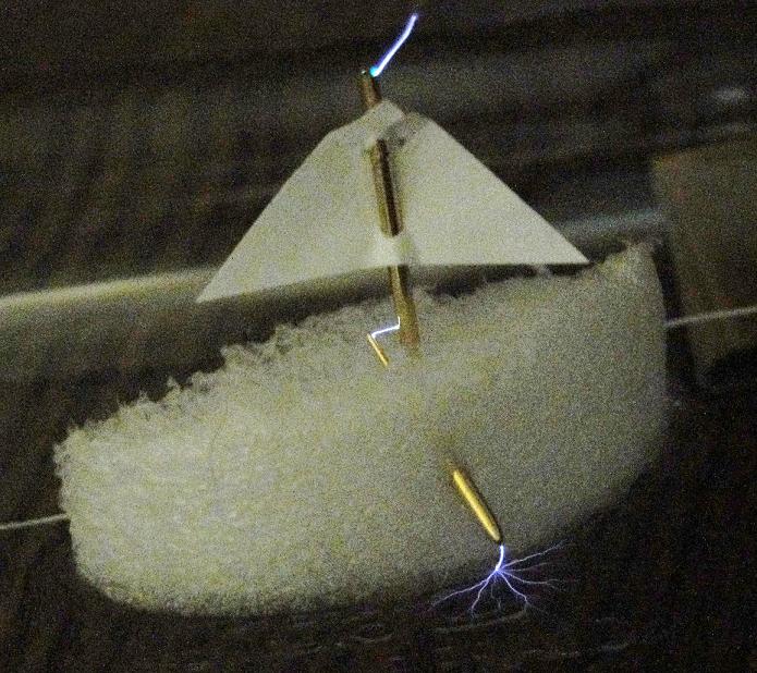

if you connect the mast and keel then they cannot be two plates of a capacitor. You have to consider the larger picture. to wit. clouds have a charge (top plate) and induce a charge on the very top of the water surface (read 1/8") (bottom plate) over a very large area with air as the dielectric . Your boat floats on the bottom plate of that capacitor with the keel sticking below the bottom plate and your mast sticking up into the air dielectric. If you route the lightning from the mast base to the keel you are going to get to a point at the water line level where there is absolutely no electrical potential to drive the electrons down below the water surface (lower plate). Electricity does not have inertia as we understand it and it WILL do a 90 degree turn toward the water surface (inside the cabin!~!~!). That would be through a wire or large metal tank in most cases as FG does not carry current well.

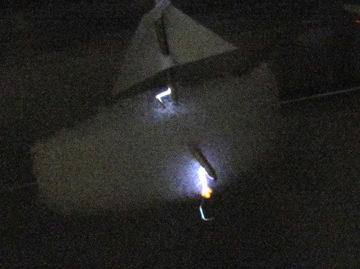

Bill, you are describing another case where the mast is directly connected to the keel and the keel makes electrical contact with the water. In this case, we have a 3D resistance from the keel to the water plus all capacitance.
I think you have posted this before but water surface gets charged positively by the charge in the sky. As the strike comes down, there is an intense electric field from the moving strike and this further ionizes the water surface (called "induced current flow" - this is also how current flows in a capacitor). This was in a "radials" paper and I have lost all these links now but it basically calculated a surface charging time that was dependent on the carrier density in the water. For fresh water, this charging time was in the micro second time frame. So a bunch of years ago I did a little experiment with an instrument (ESD tester) that generates 10K voltage with about a 10 nsec rise time. The first picture below shows a little mock sailboat with an ungrounded mast, then a spark gap to a second conductor just above the water surface. You can see the spark gap working but the interesting thing here is that with a 10 nsec rise time and fresh water, the water surface does NOT have time to charge yet you still see the spider web outwards flow at the water surface. What "we" think is happening here is that water has a very high dielectric constant (about 80 times larger than air) so water does not ionize and instead the charge still flows in ionized air just above the water surface as that is still the lowest impedance path. As you make the water more conductive with salt, the size of that spider web gets smaller. The second picture is the same exact test but in very salty water.
The point being here that the water surface is very important not only for the surface charge but it also may be the lowest resistance path especially in fresh water.
In the case you described of the mast connected directly to the keel, in salt water the keel to water is low enough resistance to apparently dissipate the current. Lots of folks in sailboat with good grounding do in fact safely dissipate charge from the keel to the water safely (in salt water).
But as the water gets fresher and the resistance of the keel to water connection gets worse (higher), now the side flash from the bottom of the mast directly to the water surface gets more competitive. And.. in fresh water, keel boats with good grounding between the mast and keel may still see the spider web flash on the water surface (someone did see this in a discussion from way back).

Exactly my point walt!!! the strike spreads out along the WATER SURFACE and does not penatrate the water to the keel and then proceed upward to the water surface. The thing to understand is the charge is not "in the water" it is ON THE WATER SURFACE. No amount of insurance wishing or prayer will make the strike go "below the bottom capacitor plate" It has to dissipate AT THE WATER SURFACE
