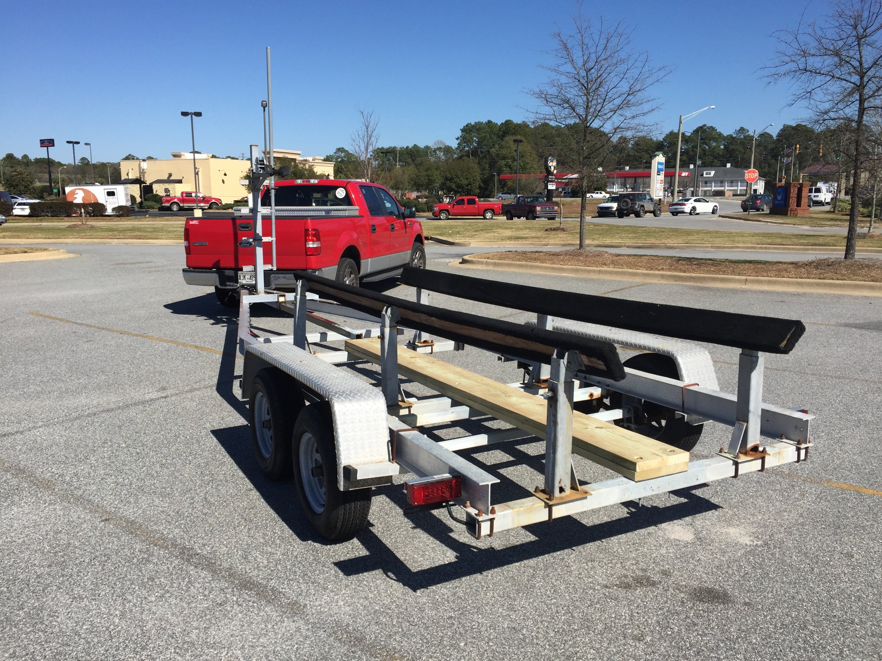

I finished repairing/modifying my new trailer this week. I also ordered the bow and stern mast crutches from Catalina Direct.
Could one of you guys please measure how far apart your trailer bunks are? I currently have a 3'6" spread on mine. I have them 22" high from keel support. Trying to set the trailer up to minimize adjustments in the cold water.
I still have some corrosion and hardware repair to be done on the risers.

Nice trailer. It'll be a trick to space the risers and form fit the bunks to the hull. As you know, the Trail Rite trailers only use four risers so the middle of the bunks conform themselves to the shape. I suggest you start there. Get the four corners set and then adjust the middle risers to take up the slack and some of the weight in the middle. My trailer is not a Trail Rite so my measurements would be helpful to you since they're different from the Trail Rite measurements you're likely to get from others. Unfortunately, my boat is on the trailer right now so I can't get an accurate straight measurement. But I can say that the front is much narrower than the rear and the middle wider than the others. There's also 15 degrees or so of twist in the bunks from front to rear. It will also help with launching and retrieval if you can get the position of the bow as low as possible to minimize the angle difference between the boat and the bunks when on a ramp. Otherwise, the bow can rise as you pull out and make it hard to get the bow in the V block. Good luck. I look forward to seeing how it turns out.

Seeing that trailer makes me wonder....I purchased #7575 in November and it sits on a trailer with rollers instead of bunks. I have no oil canning or visible depressions near the rollers and the keel is supporting the hull as well. Should I be concerned?
