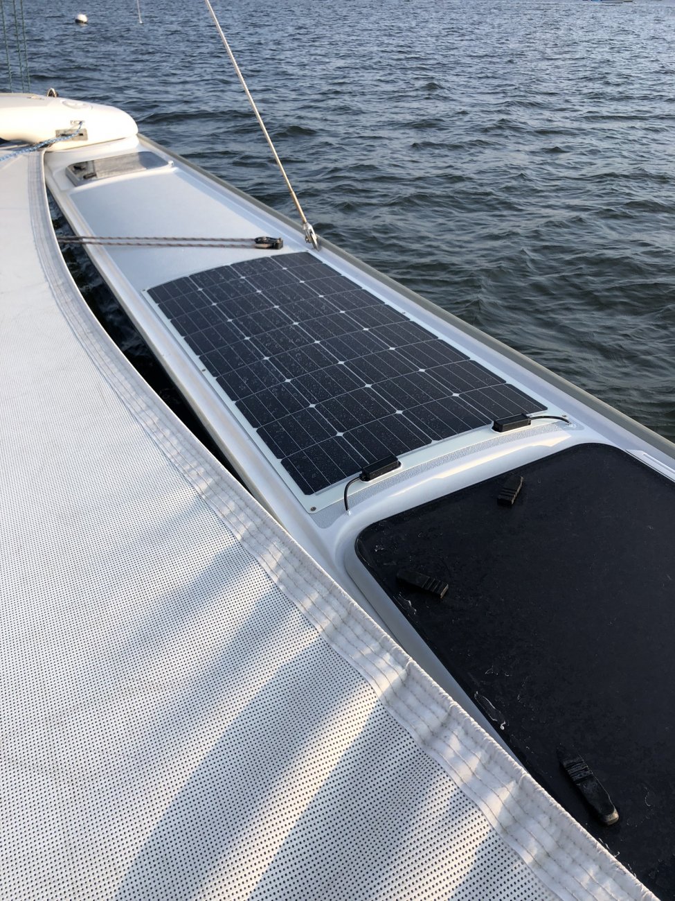

I just upgraded my solar from 210 watts to 370w. Huge improvement in recovery time - this morning at about 08:00 the ammeter showed we were charging the house bank at plus 8 to 10 amps while the fridge is running (it draws 3.2A with compressor on).
Jun 14, 2010
2,466
Did you do the install yourself or contracted out? And what was the over all cost? Thank you
I did it myself.
In 2008 I installed four (4) 20-watt panels on each side of my boat (the amas of a trimaran) for a total of 160 watts, and last year I added a 50-watt Lensun flexible panel on deck in front of my mast (210 total). That wasn't enough. I found 160 watt panels (made by Renogy) on Amazon that exactly fit the available space on the decks of my amas and decided to buy those. I had to upgrade my solar charge regulator capacity. I am using a Morningstar Sunsaver MPPT 15 Amp unit, so I added a second one and ran the panels from each side to it's own dedicated regulator, and the 50w center panel also gets its own regulator, a Xantrax C12 PWM unit. These regulators also feature a load circuit with a low-voltage-disconnect. I power my fridge from one of those, so it can't run the batteries flat.
This is one of the 160w panels (with sea salt crystals on it).
