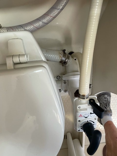

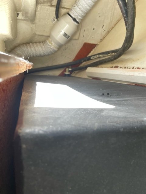

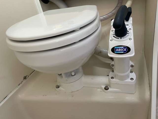

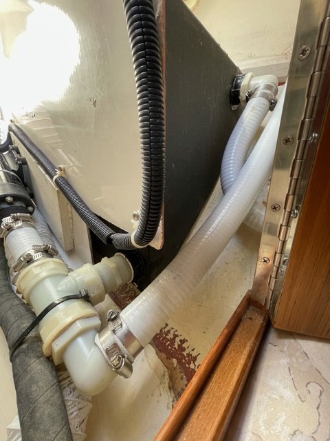

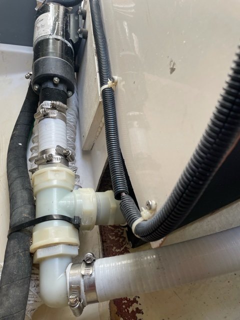

First, thank you all for the responses! Peggy, it's especially welcome to hear from you, and once we get further sorted out I'll take you up on your offer via a PM.
Yes, we have a 2003 Catalina 310, sailing exclusively in SF Bay. I just got back from cutting off the shelf that was over the holding tank to get a better look. I'll attach a few pics here as well.
After reading Peggy's book, Cathy (The Admiral) determined the head odor was most likely sea life, hence the desire for the fresh water head. We priced out the Raritan PH SuperFlush and the Raritan Fresh Head on Defender and saw the Fresh Head was actually a few bucks less expensive... but we are open to suggestions. I think once we replace the hoses and follow Peggy's maintenance suggestions we'll be 95% better off regardless - but that's just my sense.
The hoses/connections at the holding tank definitely seem to be permeated, as they fail the wipe/smell test terribly. It's gruesome when we open up the access door and the smell hits you. Looking at some paint stains on the hoses I'm guessing they are original, which makes them 18 years old.
The idea for a new tank came about as we looked at Catalina Direct and read that they had a tank that was a, "...heavy duty holding tank for use in the Catalina 310." And, "...It is 3/8" thick, twice as thick as your original 3/16" thick tank." We figured if we were going to replace the toilet, hoses, and add a quantity monitor, we might as well go the extra mile and put in an improved tank too. Thank you for recommending going to Ronco directly. I didn't notice any bulging today; however, it is empty at the moment, and it didn't seem completely supported; especially on the inside with the thin fiberglass partition. - Stu, if it were just you and I, I'm guessing we'd pinch our noses, skip all this work, and go sailing... but The Admiral will not be denied, nor can I convince her to tally up her flushes so we'll likely do the new tank and the monitoring system - lol.
The idea of pulling out the macerator appeals to us as we can't imagine a scenario where we'd ever use it, and the idea of removing a point of failure and capping a through hull seems like a good one. I don't know quite what capping through hull involves, but we are learning a lot quickly.

Thanks for all the insights. Here are pics of the current situation:

So if you remove the macerator, I would add a length of hose to the valve that use to connect to it that was above the water line, just in case. Otherwise you are talking remove the valve, glass the hole up, fill and paint.

As others have said, no need to replace the tank unless you have some specific issue or damage…
I pulled my 33 year old tank out of my1988 O’Day 322 and it was fine…you can always rebed or replace fittings as needed, but the tank should be ok.

I would seriously consider keeping the macerator. You do realize there's this entire ocean just west of you? I loved sailing out there. You might, too. And resale in SF could hurt if you close up the thru hull. Please, think about it a lot more.
