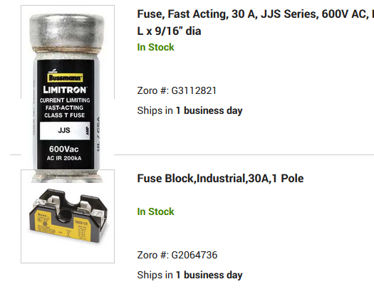

A Marine Rated Battery Fuse like the one Greg mentioned works well with LA batteries. The problem is with the LFP batteries, if there is a short the power of the battery will blow the fuse and then arc over the blown fuse, that's why a Class T fuse is necessary. The fuse is filled with silica which prevents the arcing. In the OPs case he is using fairly small gauge wire, in the case of the a direct short from the LFP battery the wire will turn red hot in seconds, presenting a fire hazard.
McMaster.com does have small amperage Class T fuses in a cartridge format. A quick look at McMaster did not reveal any cartridge fuse holders, but I didn't spend much time looking.
One workaround would be using a larger marine Class T fuse and holder. Take a short large cable from the battery to the fuse holder and then to a battery switch (which would be a good idea regardless) and then to a fuse for the run to the panel.

A possible supplier for the required fuse holder might be Del City, they have lots of harness type of parts. I have used them for a lot of items.

In regard to various questions and comments, most of the wire I have purchased to put into the boat is 10 gauge tinned marine-grade wire... I had some 12 gauge, too, that was going to go to individual devices from the panel. I have some 8 gauge to go from the charger to the battery and from the battery to the panel. I figured it was thick enough? It's possible I looked up the amp capacity for the wrong type of wire, too. It's also possible that I overestimated my power usage. As I went through devices, I rounded things up by a half-amp or so to make sure I was covered, and if you round up enough devices, the error could become significant. Basically, I hope to run 1) A VHF radio 2) A Raymarine wind/depth/speed indicator and small display, a compass light, nav lights, steaming light, deck light and anchor light (all used as needed and all LED), LED cabin lights (with a couple of LED reading lights near the berths), a couple of 6" fans, a bilge pump (1100gph) and MAYBE if I'm feeling rich and sporty, a small 2-speaker radio/stereo. Also, I may have found a fuse and block I can use...my plan is similar or identical to something suggested above... to have a short cable from the battery to the fuse block, then to a battery switch I've already installed, then on to the main panel and bilge pump.i
