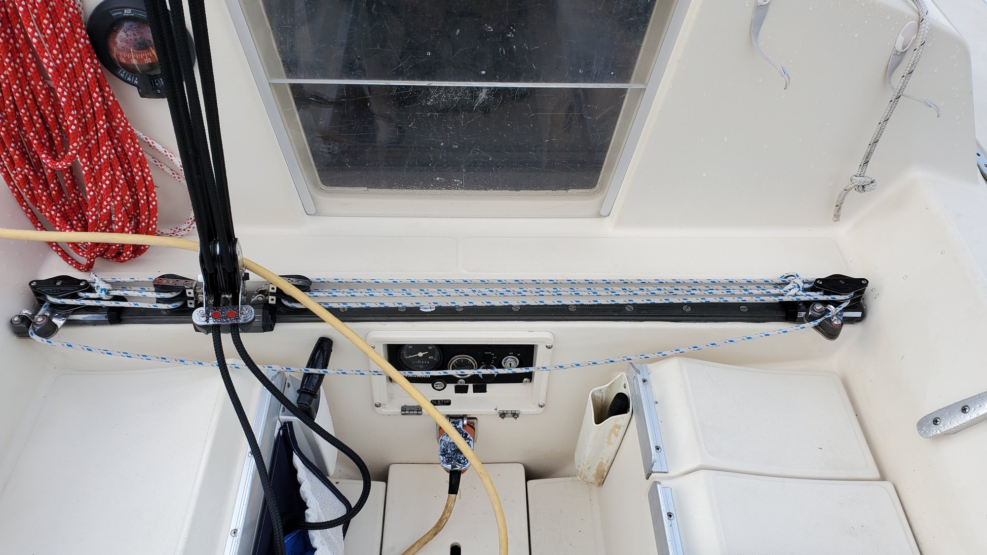

  • The traveler lines tie off to a vertical clam-cleat. The rope just falls out. The simple solution is to use a Cam-cleat. I'm curious what others have. Please send a pic.

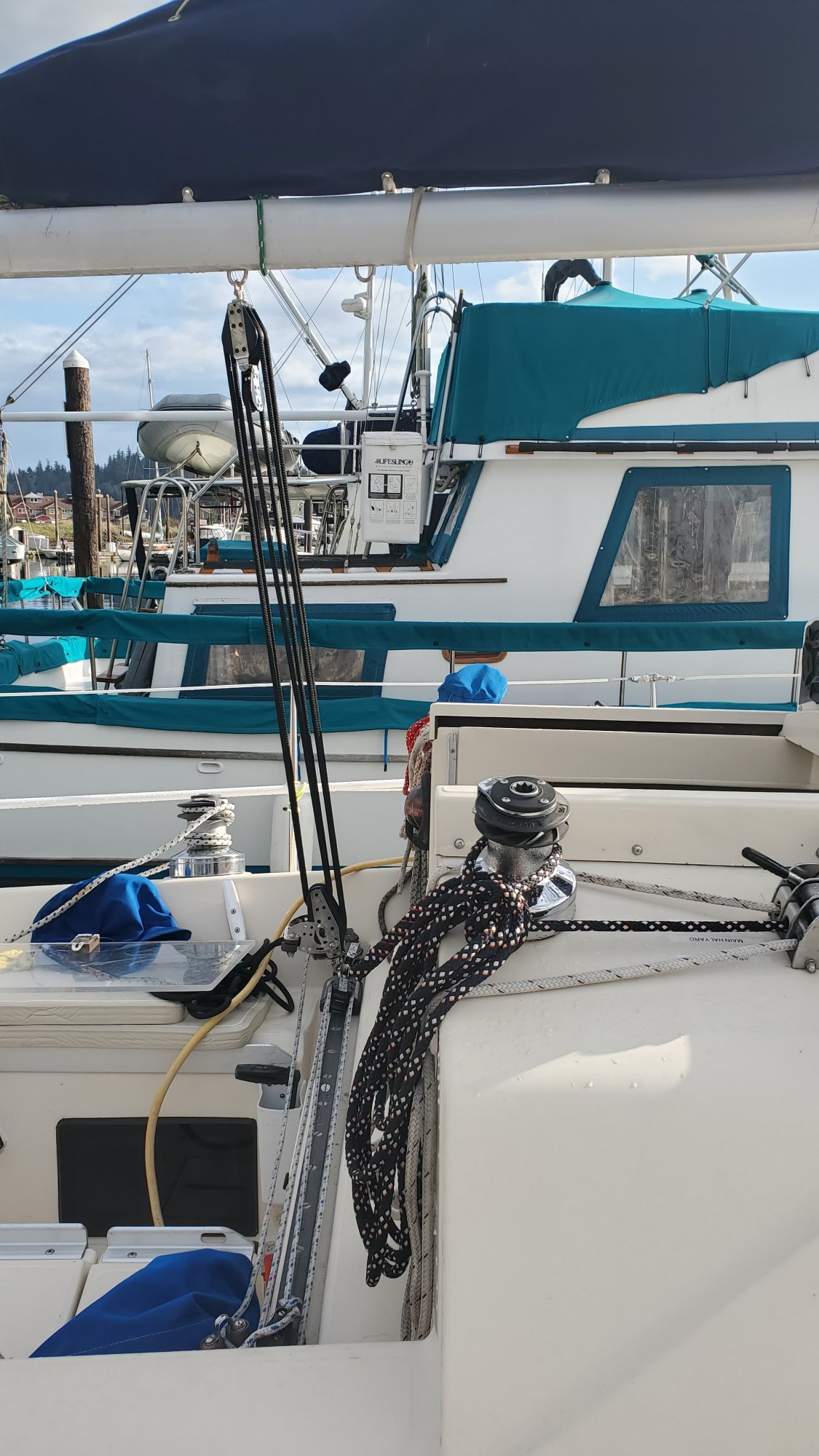

  • For the Boom, there are two metal loops for the mainsheet blocks. The forward one makes getting a dodger problematic. I haven't taken a good look to see what it takes to move the forward hook back. A new slit will need to be cut into the boom. Again, I'm curious if anyone else has done this.

On the dodger, I was thinking of moving the forward ring on the boom back behind the current-back ring. I have not taken a close look to see how much work this would be.

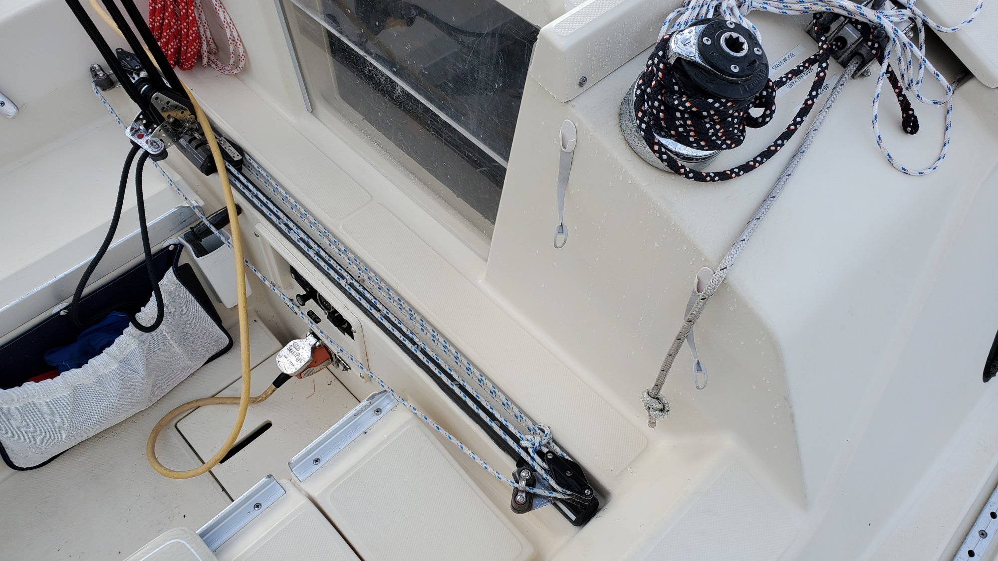

I don't have those swivel cam-cleats on the end. I just have clam cleats up the sides, with the traveler working in a loop. It's just asking to fall off and go flying.
You also moved to using just the back metal loop alone. On mine, the load is spread between both loops. I am worried that the single loop won't be able to handle it. Is this a common set up? It would be really easy for me to do this.

I've wondered that myself. The rigger didn't seem have have any concern about it when we switched to the new mainsheet, but I don't think that I specifically asked. I've thought about making a dyneema softshackle to span the metal loops.

Also, that kind of traveler setup is available from Harken (which mine is) and others like Garhauer. It works really well.
