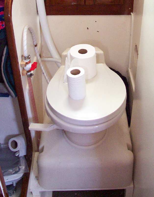

I had that exact same issue when we acquired our HC 37 back in 1999.
I removed the old tank by accessing it through the storage bin under the vee berth on the starboard side. Using what I had, I used a hole saw to make multiple overlapping holes to cut it up, and then just beat it into pieces small enough to pull out. A sawzall or grinder may be better. I recommend not cutting into the shower stall seat. (You just have to keep up the mutilation until it succumbs to removal).
I removed a whole bunch of hoses, 2 Y valves, and a hand pump. (The original system had facilities for going overboard directly, going into the tank, pumping the tank overboard, or pumping out the tank).
As a temporary measure I installed a Sealand 700 series and then found it fitted our needs so well, and has been so trouble free, I have never replaced it. The space under the shower seat is now used for storage.
