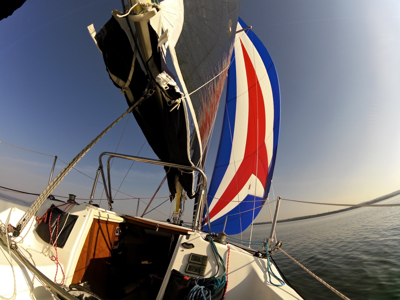

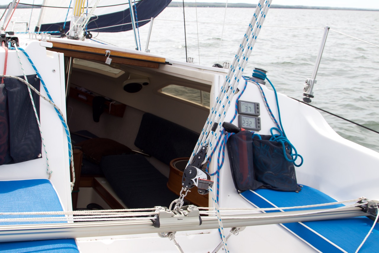

I'm going to go with a similar design with a fat-head mainsail to take advantage of the B&R rig, as well as vertical battens in the headsail.
Gota love that B&R rig and large roach mains. My new fat-head main gave me around 8% more area than the stock sail. To maintain balance, a slightly lager jib was needed. Vertical jib battens got me part of the way there and the rest was accomplished by adding length to the "I" measurement (which I had room to do).

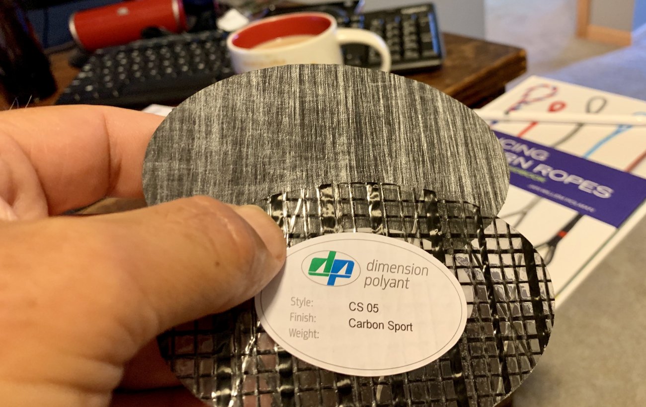

Judy,
Thanks for all the detailed info!
Question, are you sure that Lite Skin is not a laminate? I thought I read that it was, and I’m holding a sample (GPL14 LS) that I got from my Sailmaker next to one of their string laminates. While it doesn’t show super-well in the picture, in person you can absolutely see (and feel!) the string structure between the skins. It’s almost as if the light skin were acting as a taffeta. I agree, I doubt there’s a Mylar layer. I can pull a part with my fingers.
PS - totally agree about the shrinkage. Best example of that for the crew... have them wad up a piece of 8.5x11 paper. Then straight it out flat, and lay it over a fresh piece.......
It’s just a technical fine point.
By definition, Laminates have layers. They are not homogenous. Liteskin is a homogenous composite that is used as the outer layer in a laminated sailcloth.
In a strictly technical sense, LiteSkin is just the outer skin, by itself it does not have a layer of Mylar. LiteSkin is a direct substitute for taffeta skins. Liteskin provides superior UV protection compared to taffeta. (Taffeta is just a very light weigh version of woven polyester).
Liteskin is used as one layer in a laminated sail. made to be glued to a sailed consisting of a sandwich of Mylar (tm)film- fiber mesh -film. If you take some Carbon Sport (tm) laminate, and then glue lite skin (tm) to it, you have Carbon Sport Lite skin. (Tm) .

Now I see what you are saying; we're in accord. DP does not help, they call 'Lite Skin' a product but it really is a product feature... they do not sell just the 'skin', and it creates a new product when they use it.

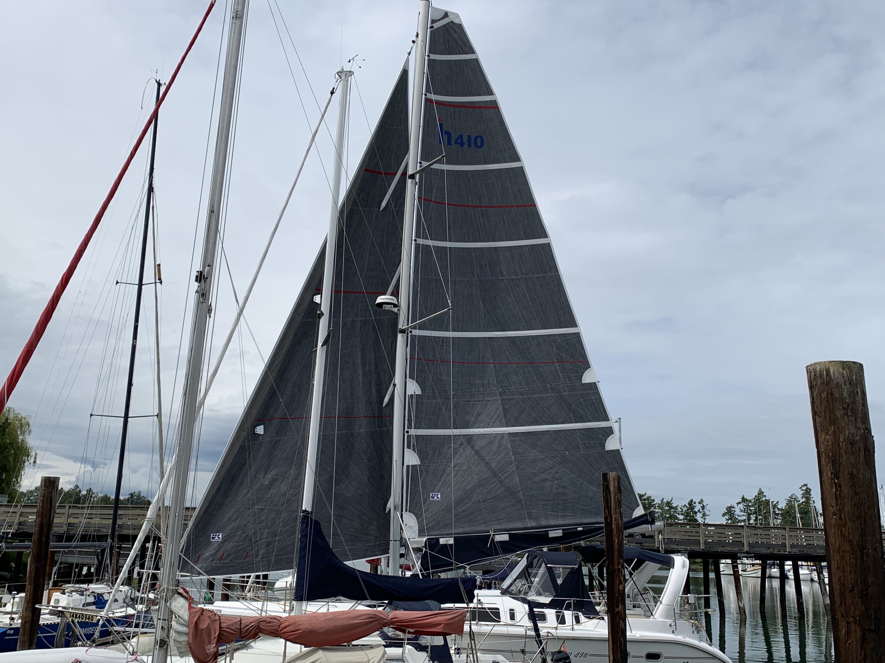

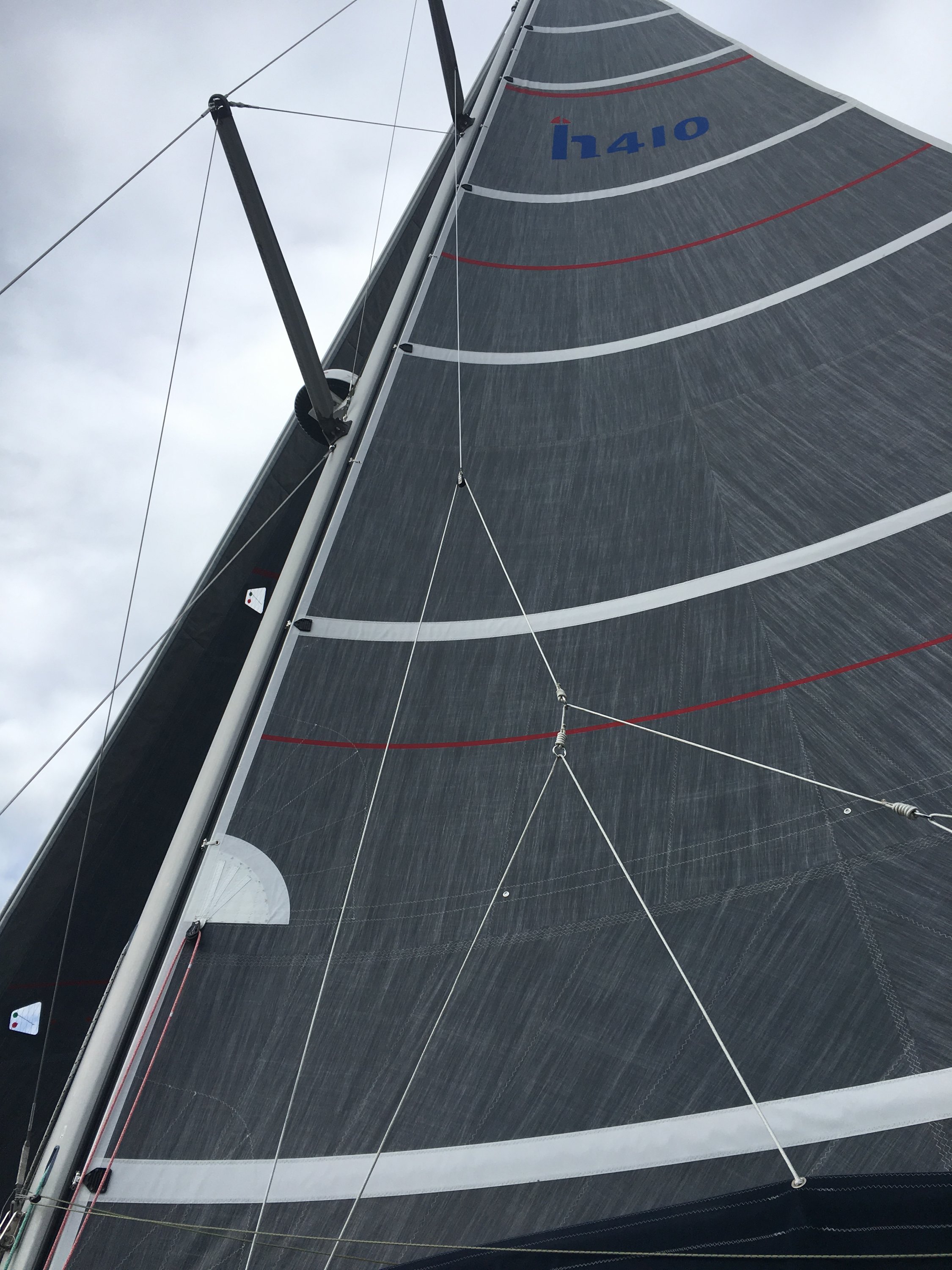

@Jackdaw,
Adding LiteSkin or a grey taffeta on the outer side layer makes it look like a carbon sail, but doesn't boost the performance a whole lot.
Grey color doesn't mean there's any carbon or aramid fibers in the sails. It's just a color that can command a small premium in price. Polyester/dacron fibers can be black or white, sandwiched between clear or grey colored mylar, with a shiney or a matt finish. Or black fibres could be carbon or black aramids, (such as twaron or technora). But you'll pay more for black and grey sails, because the manufacturers can get a premium price for them.
Judy B
Semi-retired Sailmaker
Our choice of this specific taffeta was not based on looks, but that locally it has been standing up the best against mildew, and moisture issues of all the cruising laminates. Especially for sailors that keep their sails on all year through the Canadian Wet Coast winter who want to be able to enjoy those quiet anchorages. We were looking for the toughest sail that still held it shape well for a long time, and weighed less than dacron. The tape drive sails were also considered but were just a little too much $$ for our budget.
