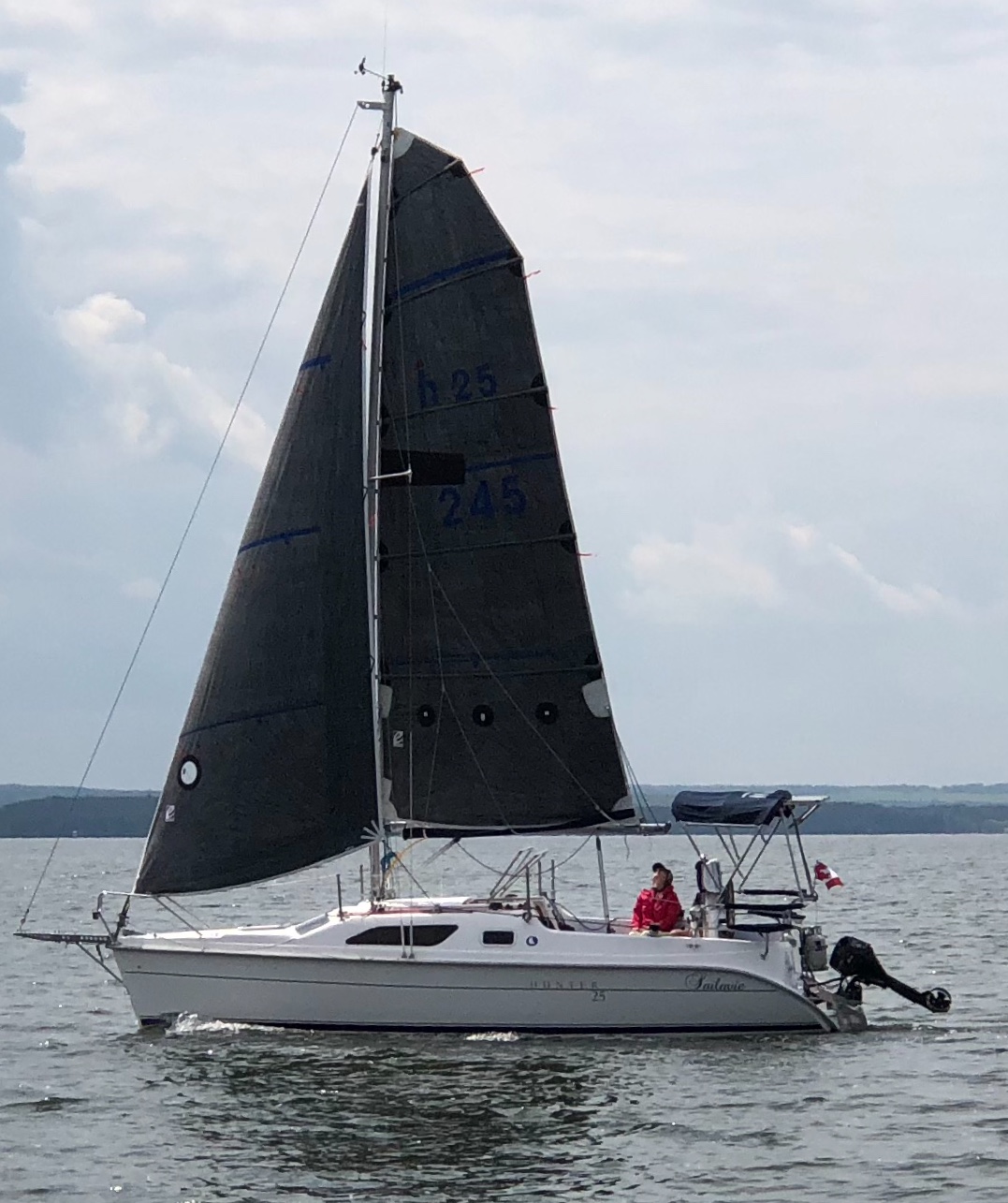

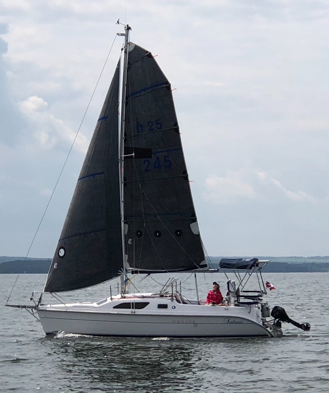

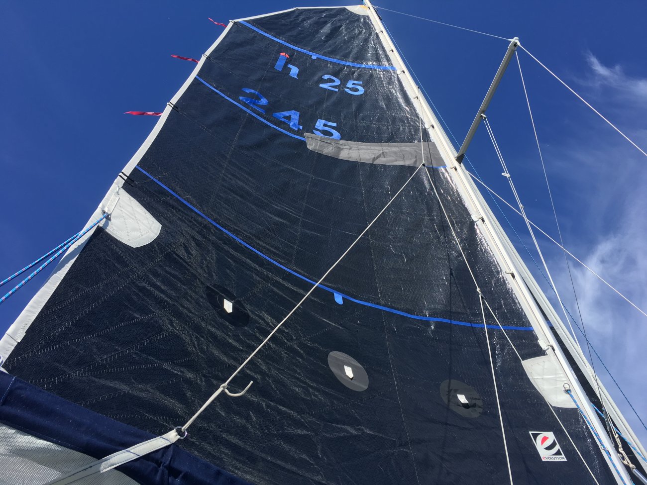

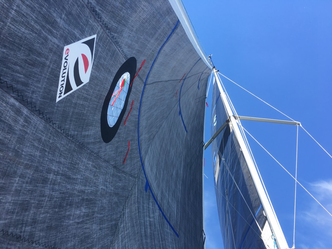

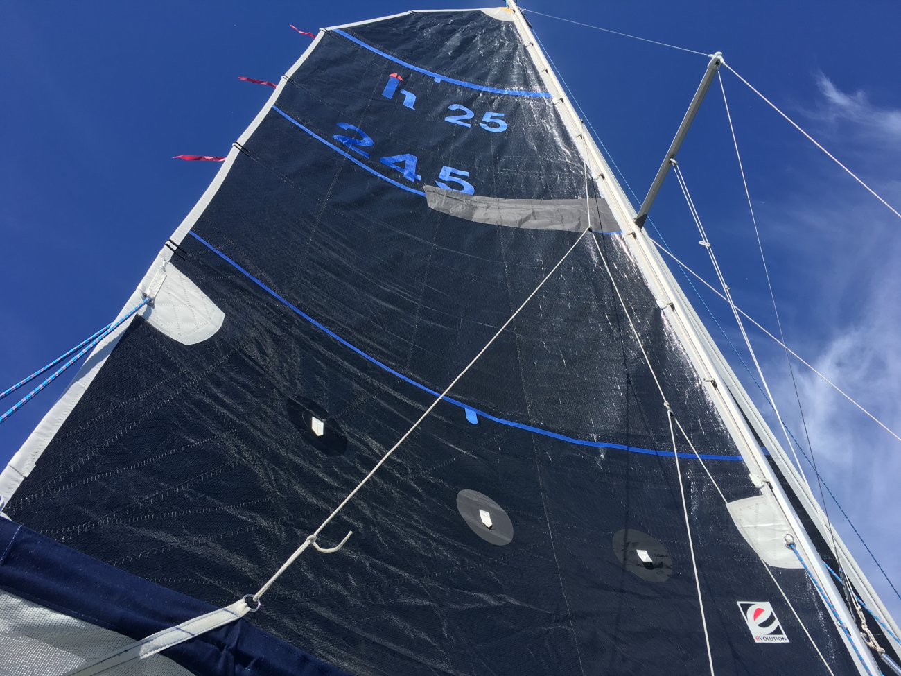

I purchase these Dimension Polyant with the darkish grey taffeta from Evolution Sails this spring. Definitely notice improved performance and additional power of the full batten high roach main and surprisingly, less heel than with my original sails.
I purchase these Dimension Polyant with the darkish grey taffeta from Evolution Sails this spring. Definitely notice improved performance and additional power of the full batten high roach main and surprisingly, less heel than with my original sails.View attachment 156345 View attachment 156344
Very nice! Now that you have that fat-head, a super upgrade for your boat would be a traveler. It would allow you to set the correct twist with the top half correctly positioned with respect to AoA. I'm guessing right now that most of the time the top half of the sail is not generating its full power potential.
