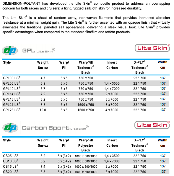

@DrJudyB , I'd be interested in your thoughts on the 'insert carbon. I'm assuming that the warp/fill(/ply)? are woven into a scrim, and the the carbon is strands that is laid on top before the stuff is sandwiched together?

Dimension Polyant GPL Liteskin is the same product as GPL GraphX but with with Lite skin laminated on the outside. It is a film laminate with Technora and Carbon fibers, no twaron .
DP’s “Aramid Sport LS” has twaron (a para-aramid) laminate with film, with the Lite Skin
DP’s “Carbon Sport LS” has a laminate of film, Carbon and technora fibers with LiteSkin on the outside

@Jackdaw
Hi Clay
I wouldn’t call them “threads”. Thread implies they are twisted. They are all “ fibers” or “yarns” or “inserts “ laid between the film in different orientations. Some look like parallel stripes in one direction (for example, Carbon), some look like a diamond shaped pattern ( for example 22 degree Technora) and others look like square grids ( for example Technora warp and fill at 0 and 90 degrees)
The Carbon fiber inserts are only on the 0 degree (warp) orientation, which is the most highly loaded on a triradial paneled sail.
The Technora “ grid” is inserted on the second most highly loaded orientation. It’s inserted "on the bias". which in DP's opinion should be at about 22 degrees to either side of the 0 degree (warp), and DP markets that as “X-Ply”.
The 0 and 90 degree orientation are aka “warp and fill”. On a tri radial paneled sail, the 90 degree (fill) direction carries very little load. In the GPL, the warp and fill is Technora, which is less brittle than Carbon, and less stretch than polyester. In the Carbon Sport, the warp and fill is polyester.
(Warp orientation is the "long" thread direction in woven cloth produced as rolled goods on a loom. By convention, we call that "0 degrees". The fill orientation for rolled goods is across the shorter direcition, and that's at "90 degrees". We use the same conventions for laminates.)
I wouldn’t recommend Carbon Sport laminate for a boat much bigger than 35 feet or so. GPL laminate can be used up to about 50 feet. Both laminates are available with Lite skin for increased durability.
Call me if you’d like to discuss it in more detail. :)

@DrJudyB - This is all gold. Thanks for the detailed reply. The insert deal makes total sense to me now. I never quite thought through the scrim vs insert thing before, but now it makes total sense. The over/under weave of the scrim material will guarantee some stretch as the the scrim tries to flatten under load. But the straight carbon insert 'fibers' ;^) pretty much take all/most of the load before they get the chance to do so!
Kind of like why the polyester cover of dyneema cored line has no effect on line strength. While it could, the dyneema loads up with so little stretch, that the much stretchier cover does not have a change to add any strength value.
