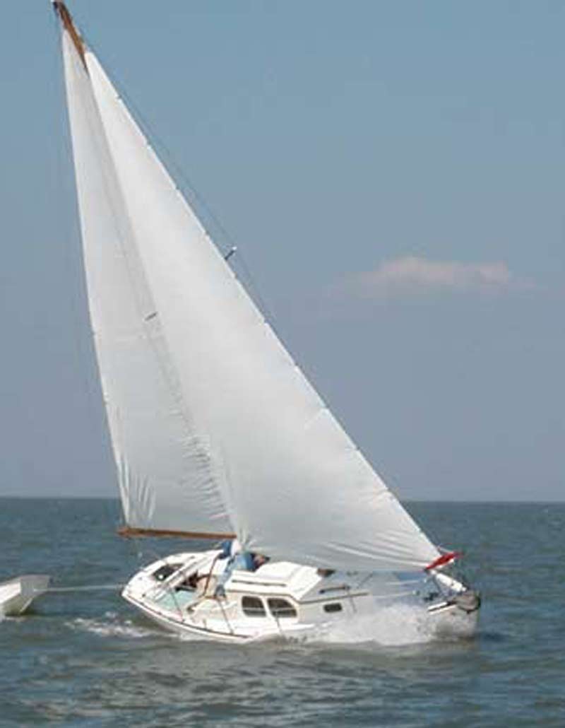

Mar 1, 2012
2,182
UI use a pennant on mine to raise the foot.. Sail is also cut high,, but I've gotten in trouble with a low cut jib, sailing short handed. Not safe to not be able to see to leeward.

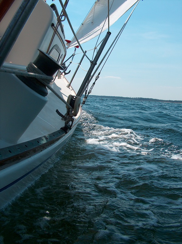

Another angle
23,508
Hi, Ken,
Mine is a standard C34 110% that I installed high off the pulpit by purchasing a ProFurl furler with long link plates. I have found no impact to the sailing ability of the boat. Indeed, I find it much safer. What you need to consider is where the jib fairlead tracks are and how that works with your clew, so talking with your sailmaker certainly wouldn't hurt.
I have an 85 and a 110. I haven't reefed either one. Your boat, your choice :) on whether you feel it's necessary on a 115, and on your boat. IIRC, you're a fractional rig, so would have different characteristics than my masthead rig when it comes to wanting or needing to reef the jib, as your mainsail would be your "driver" more than mine is. I often sail without the main upwind and do quite well.
No question about the UV, don't leave home (or your boat) without it! :)
A loose foot would be cool, just make sure your outhaul is nice and smooth.
Happy Thanksgiving to you both.
Stu
