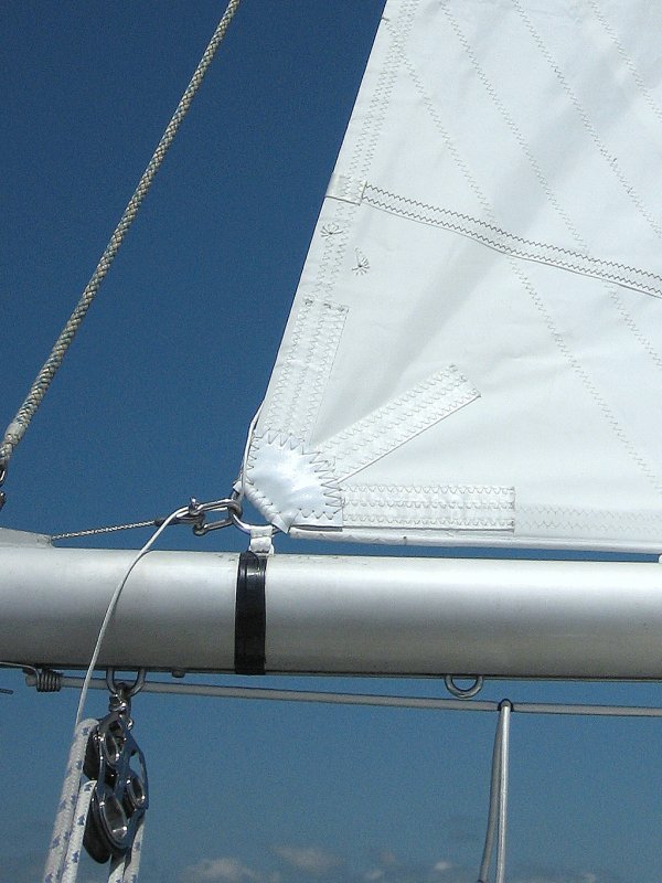

Hand Finishing
I think this is what Rich is referring to when he talks about chafe protection and hand finishing..
RichH
Feb 14, 2005
4,773
THAT is a 'quality' sail 'finished' with elegant 'handwork', Maine. That hand stitching was probably done with either a sailmakers needle/palm or 'automatic hand-awl' - NICE !
I'd add a sun cover over those NYLON webs, though.
