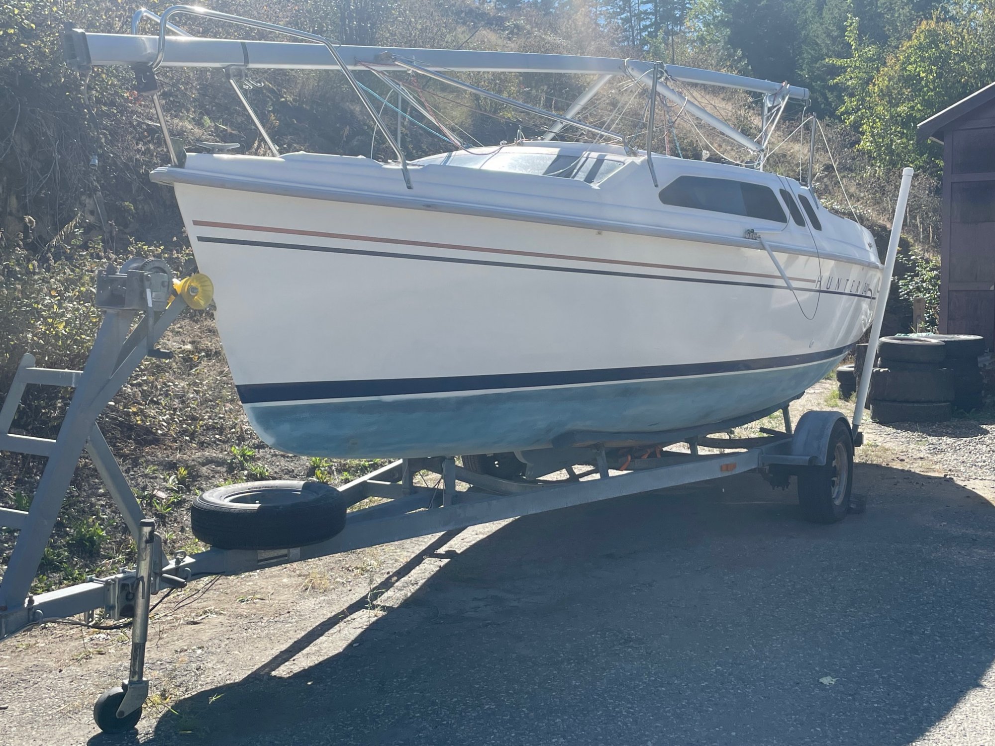

Small amount of progress to report. The weather has cooled down so we got started. I had a good look underneath while sanding the bottom. A number of the scratches were just through the anti fouling paint. That said, I found a few more “hits” in the bottom. I will have to lift the boat off the trailer, yikes. There’s a healthy bump right on the left bunk.
The large repair in the front port side is almost done. Multiple layers of glass with vinyl-ester resin. Then two finish coats. We made a few more repairs along the way. More to go.

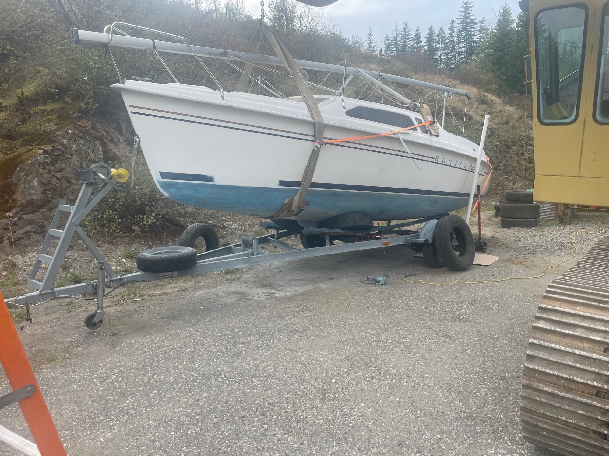

Looking for some advice re lifting. I'm hoping I can use just one sling on the front. If I hook the trailer up to the truck, block the back of the trailer and use one sling on the front to lift the nose. I can pivot the rear of the boat on the rear of the bunks. I only need say 12 to 20 inches clearance.
I do have a large steel spreader bar and 2 straps but no stands or anything to put it on once its up.
Any advice :)

What I am concerned with is tilting one end. The weight on the end with the other end poses two problems. The hull on the trailer will indent the hull
And secondly the strap lifting the other end can slip off You will have damage. I have seen it happen.
I would be willing to talk with you. Send me a private message with your telephone number. The plans for the 23.5 came from me to Hunter Marine.

We shared the same concerns. I am happy to report that the lift went very well. Next time, I would use two straps and just lift it. It was very smooth. I ended up using two tires (1 on each side) under the bunks once it was up. Tomorrow I'm going to finish the paint stripe and a add a decal. We're hoping to put it in the water this week or next.

The main lifting strap is only going to go one way, forward. I tied the main strap from going forward with the orange tie down. I figured I was golden?
