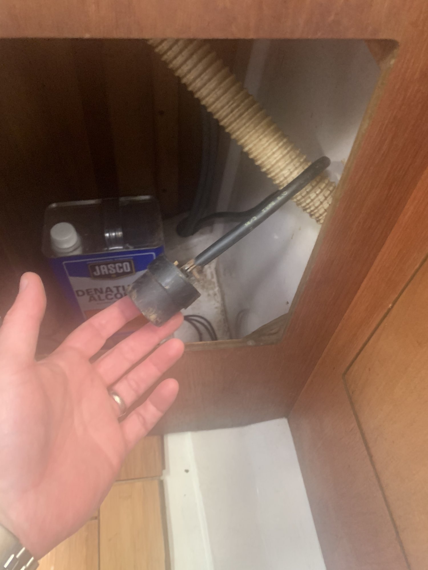

Just purchased 1985 28.5 and i’m not familiar with sailboats and diesels, so i have a lot of questions but i’ll start with this one:
under galley sink there is plug that i have no idea what is goes to - additionally, there is a 4” hole in same cabinet that has been covered with a piece of sheet metal (former vent?).
Thanks in advance!

As to your question, it looks like a 115v "extension" cord. So, is it wired into the 115 electrical panel and if so, is it hot?
Next question, is there a 115 water heater on board? Is there a battery charger or inverter mounted somewhere? Do you see evidence of some holes where some kind of 'box' might have been mounted. The possibilities are almost endless.
It is not uncommon for older appliances of the sort to be installed, then died and later removed by a previous owner as junk or to be moved to a different boat.

Thank you for your response - coincidentally, i have Calder’s book lying on my ottoman that i just received today.
I’m not on the boat right now and i left the manual there, but i thought i had, perhaps, a schematic showing some sort of battery bank located in that cabinet?
Hot water heater is in lazarette. I have not looked thouraghly at AC DC panel, nor traced wires. Although, there is a water heater switch on control panel at nav station. No indication as to anything mounted either

The plug you inquire about looks to me as a previous owner modification. It appears to be a 115V AC cord extension as suggested by @ggrizzard. When I got my new to me boat I followed an old as time new skipper tradition. Get a strong flashlight, new batteries, and open and look into every space and void on the boat. Have a camera and take pictures as you were searching for treasure. You may find some.
You should find where and what is attached to the other end of the cord.
I would advise, when you do, that you replace the extension cord with true Marine wire and properly connect the electric motor to your AC panel.
The extension cord is an electrical problem waiting to happen.
