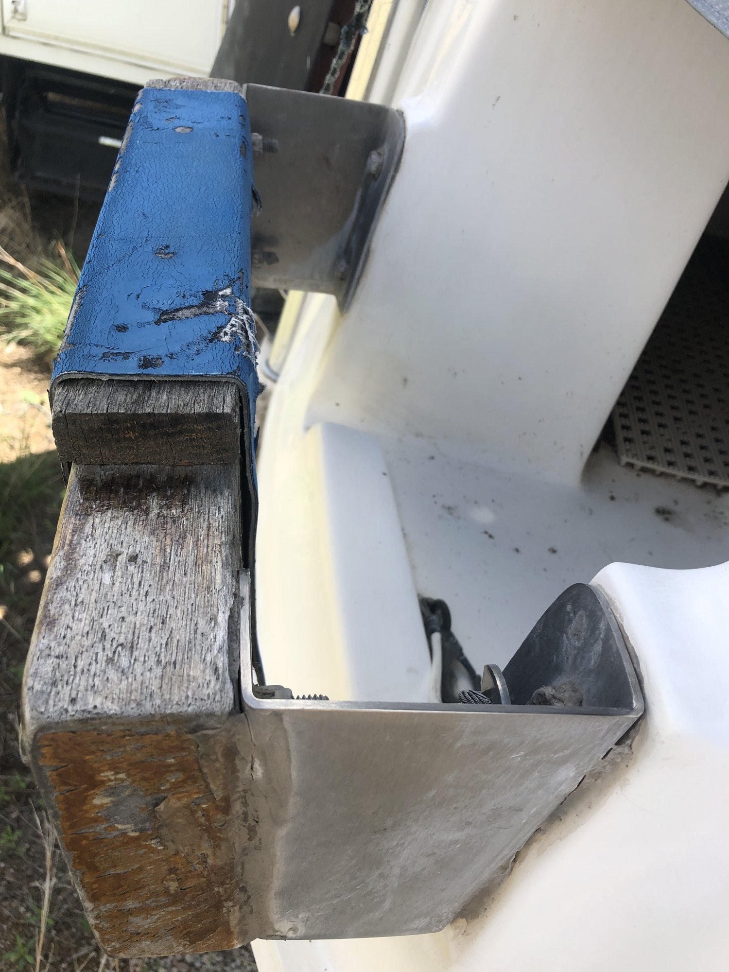

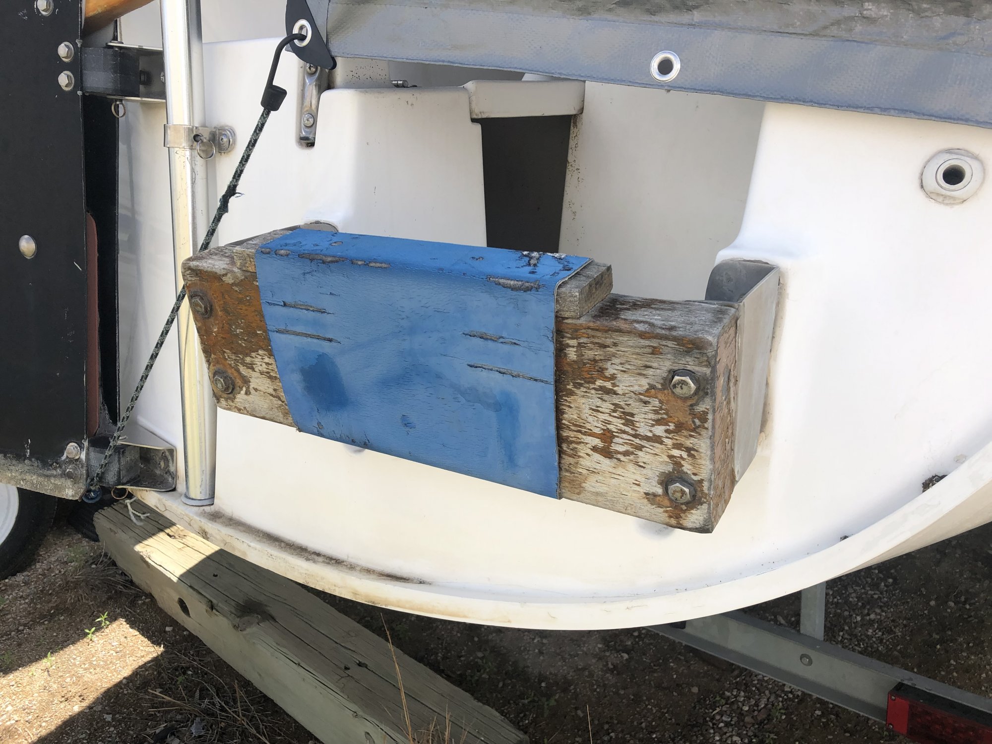

Here is why I am concerned about traveling long distances with the 125# Honda OB. Even if i tied the OB up I am still concerned about the bouncing an stress it would place on the motor mount
Could reinforced he motor mount if concerned. Mine has a 4-stroke 9.9 Johnson. Not sure what it weights but I've trailered the boat a few thousand miles with the motor attached at the mount (not reinforced). I do like to slow down for big bumps though :)
