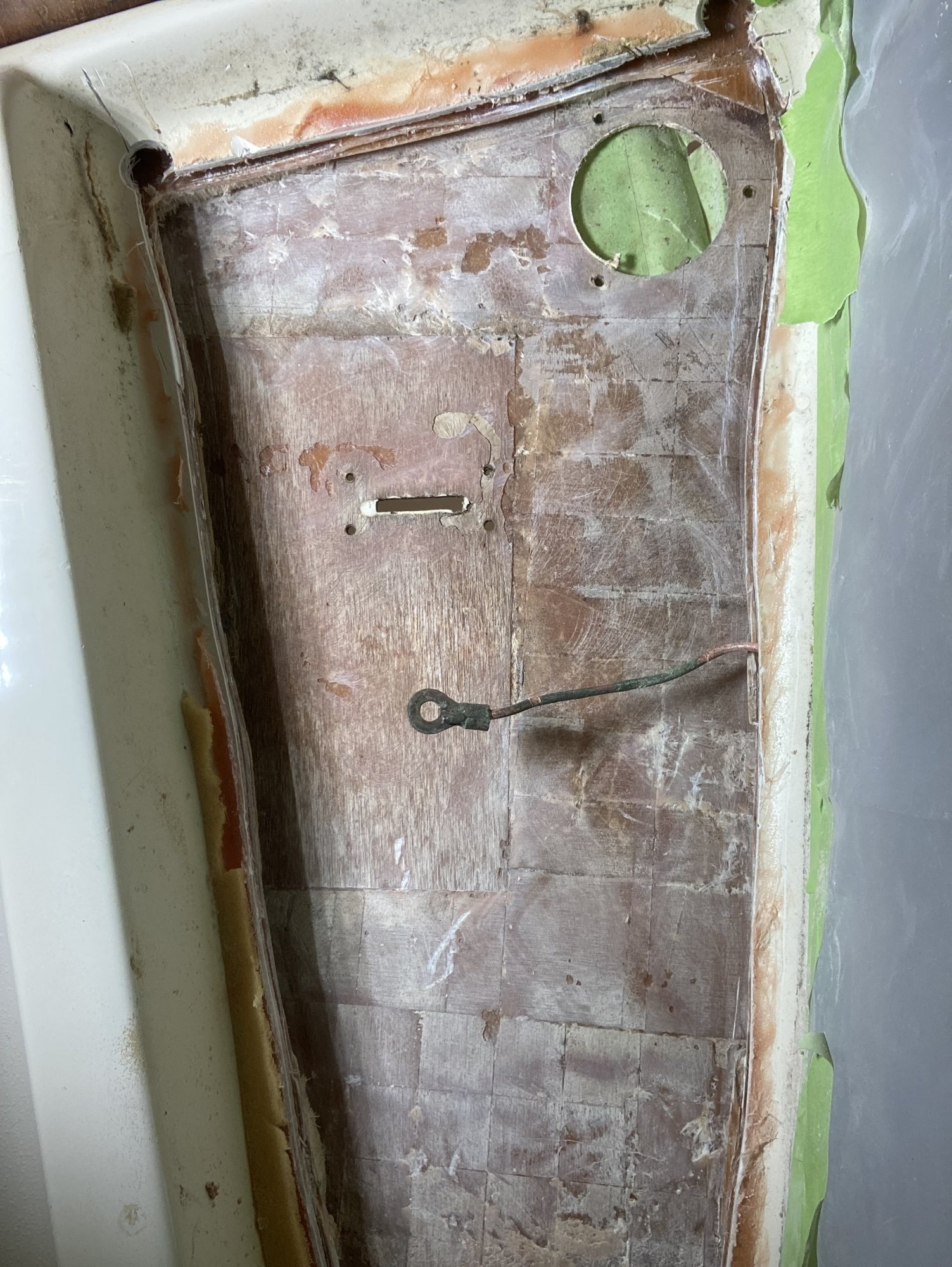

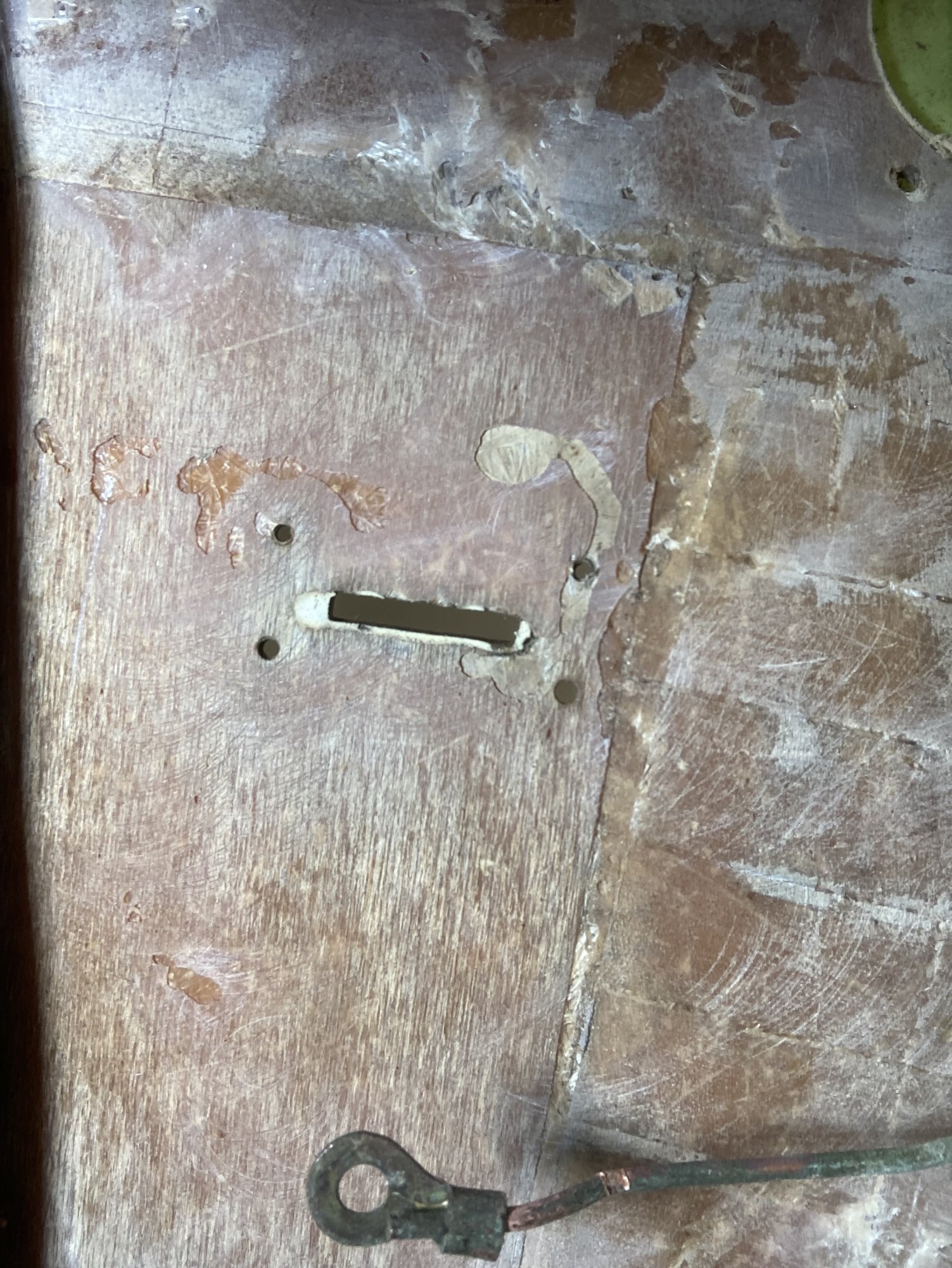

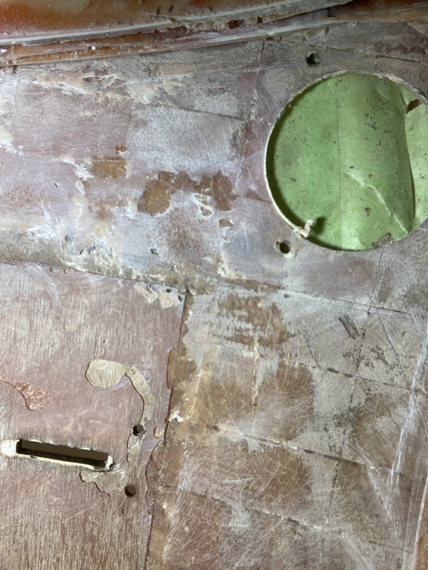

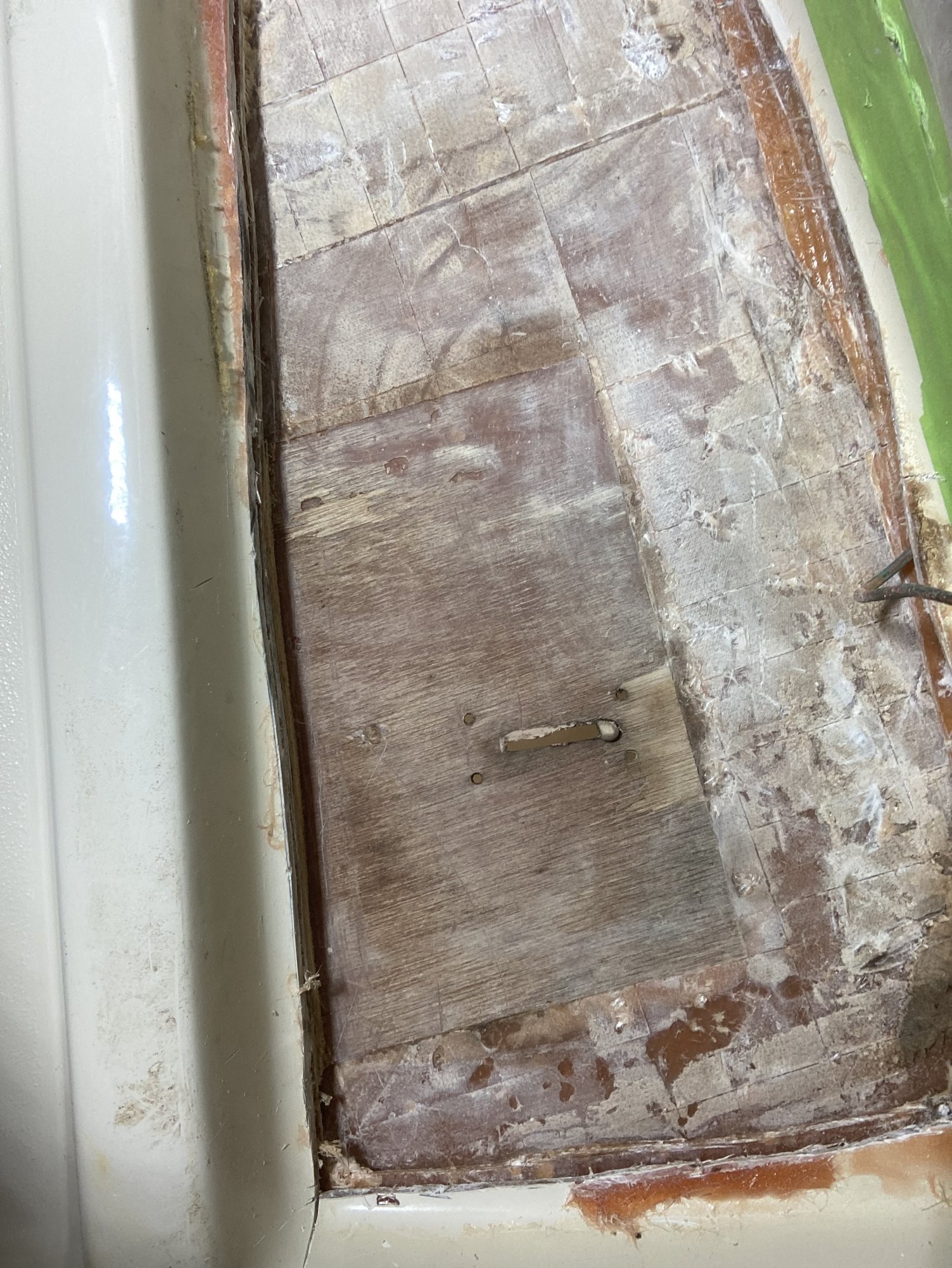

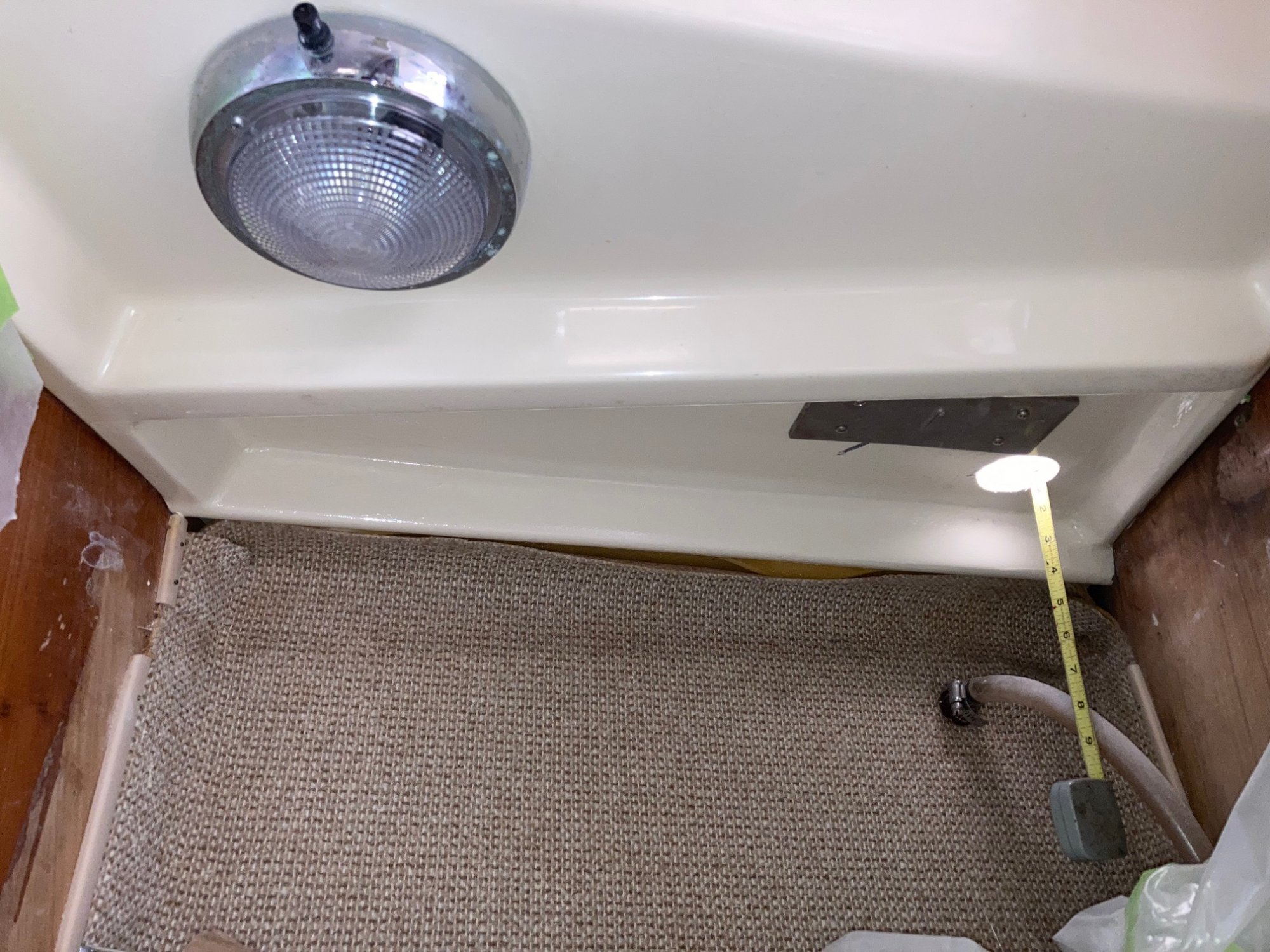

As promised, here are images from the underside of the deck where the FWD lower chainplates have been removed. As much of the balsa core has been removed and will be replaced with Coosa board. The chainplates themselves are pretty robust so instead of reinventing the wheel, we are going to reuse them. However, instead of being glassed in, they will be thru-bolted to SS plates on the deck. This way, if they ever leak again, A- the Coosa won't rot, and B- I can access, unbolt and reseal. The only tricky part is coming up with laminating schedule that will result in the padeye protruding the proper length through the deck. I will post more images once it is done.
Why didn't you make repairs from the deck down , of course there would be cosmetic issues to deal with
Aug 7, 2021
170
O'day 28 Casco Bay
WK, you answered your own question. When this is done, it will look like it has always been there.

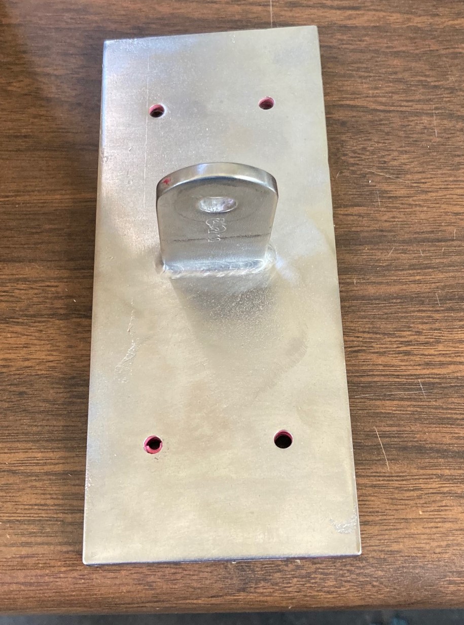

Clutch do you have any photos of the chainplate ? I will probably start work on the boat in a couple of weeks and wnated to backup with a SS plate but but sure what the glassed in end looked like

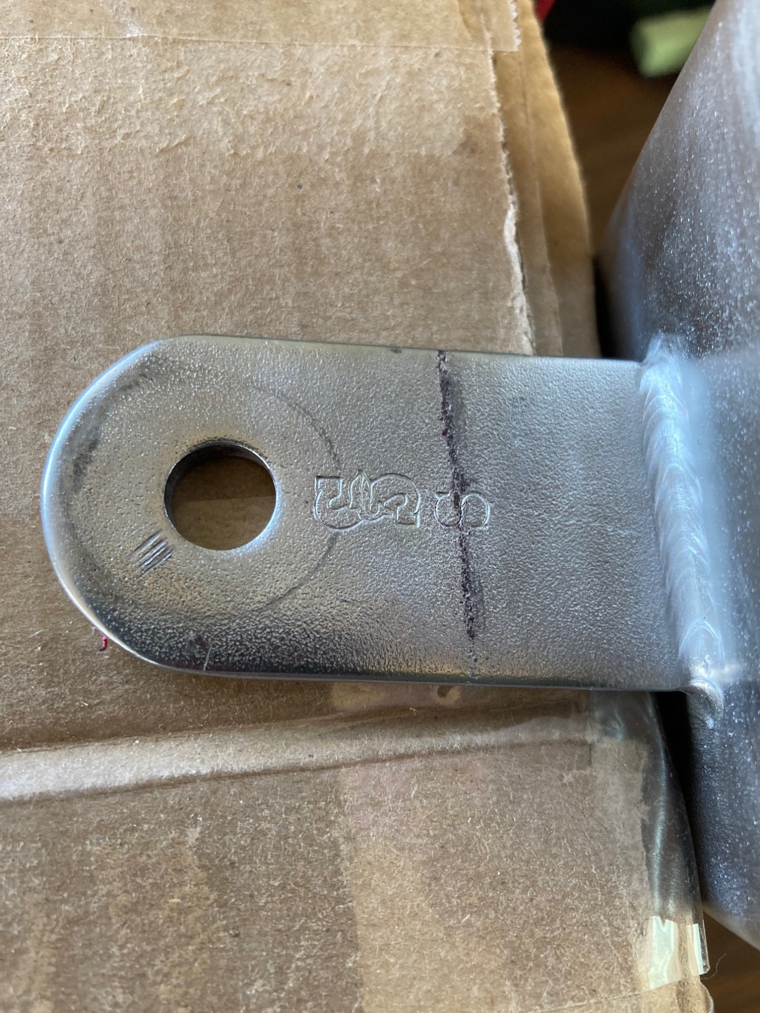

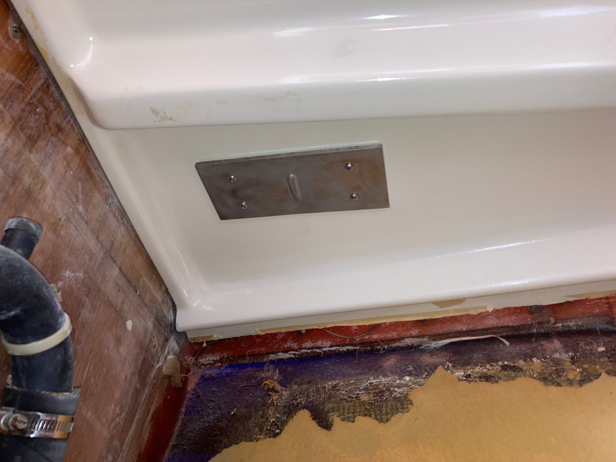

OK, sorry for the delays. This working for a living interferes with the important things in life, LOL. I'll make this in a couple of posts as I have a lot of images to share. I must tell you that the guys at Yankee Marina did an absolutely fantastic job. If you look at the shots I posted before, you can see how clean they got the underside. Wait till you see the finished product.
First, the Chain Plates. They are very robust so it was a no-brainer to use them again. The big diffrence is that they are not removable from the underside. We added 4 holes so they can be screwed in place prior to bedding. They are also marked port and starboard.

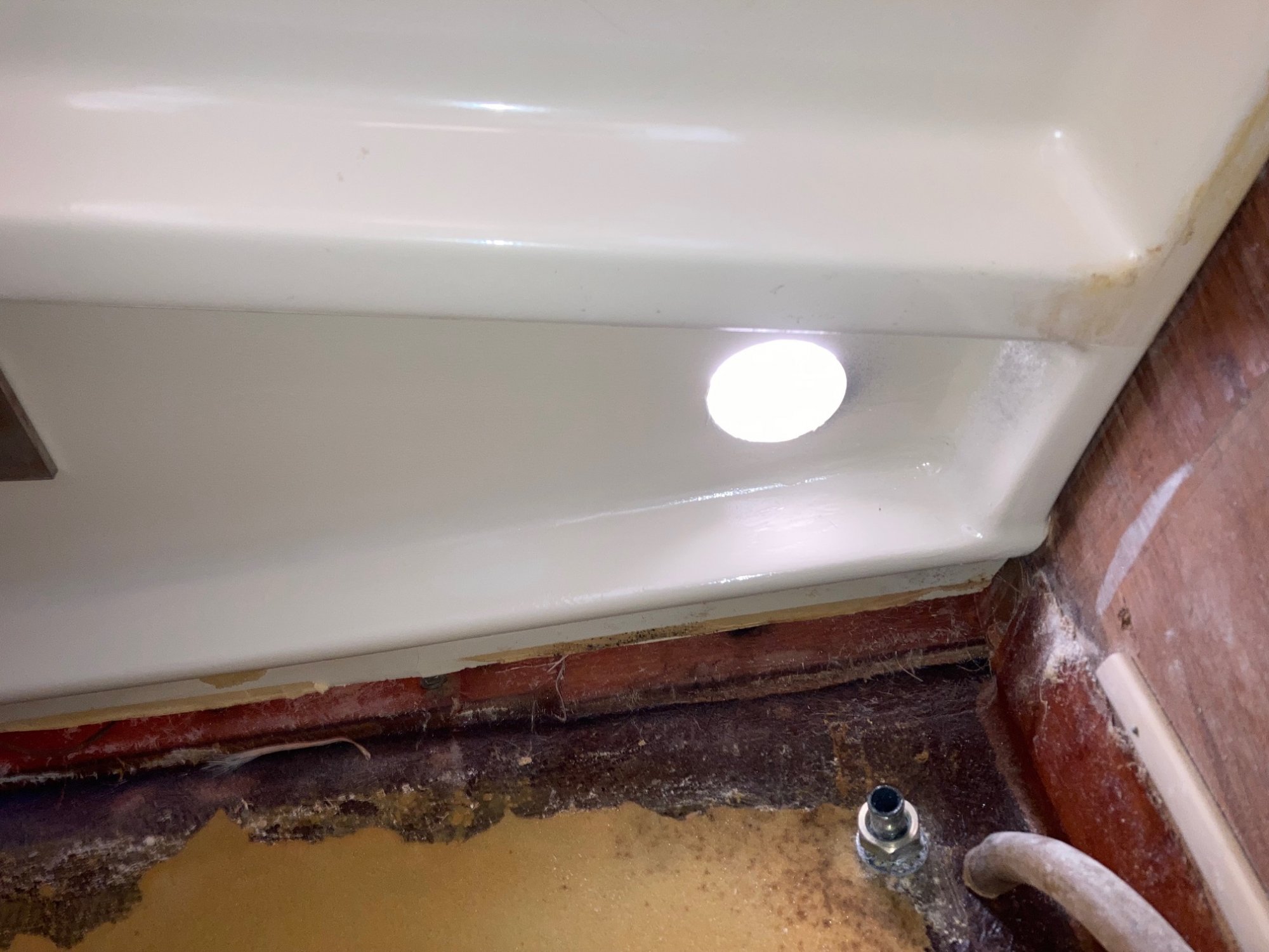

O'day 28 Casco Bay

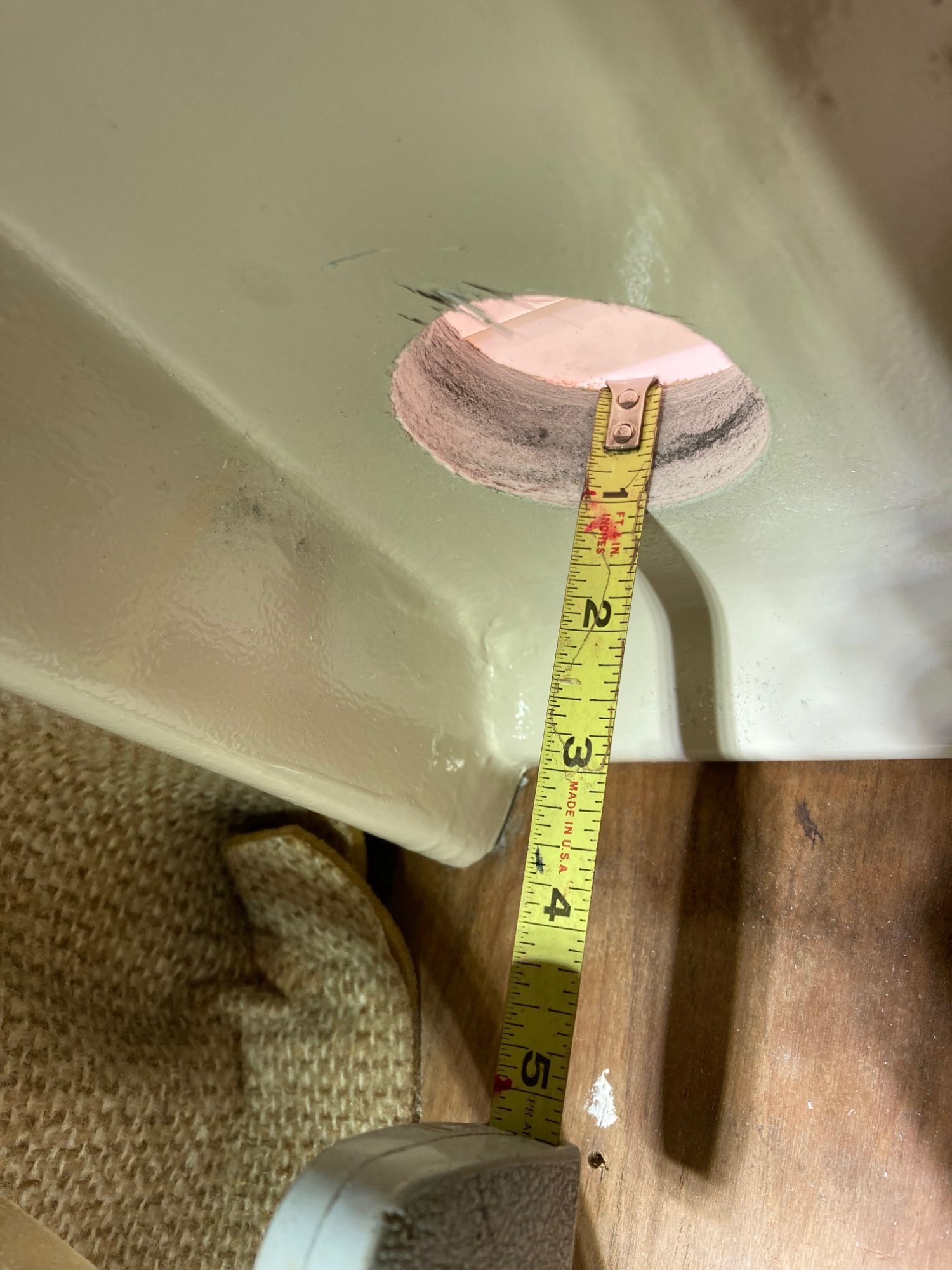

For those of you who had questions about the core, attached find a closeup. It is just a little over 1" thick. I have asked the Service Manager for the layup schedule and will pass it on as soon as I get it. I think it consisted of two layers of double bias cloth, a layer of Coosa and then two more layers of the double bias.

O'day 28 Casco Bay
The core shot gives you an idea of the finished repair. They feathered filler into the underdeck liner to make it seamless and painted it with tinted, waxed gelcoat. The result is something that looks like it has always been there. Unfortunately, when they were cutting the new slot on the starboard side, the tool slipped and scratched the gelcoat, but no one will see it. I liken the who process to getting a new septic system - when it's done, only you and the guys who did it will appreciate it.
