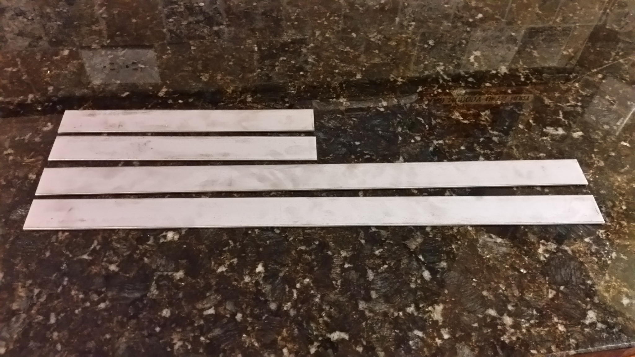

Thanks all, we are looking forward to the season. The leak and stuck center board have been fixed. I ordered SST plates to add extentions to the chain plates to make me feel better this season and will replace bulkheads next winter.

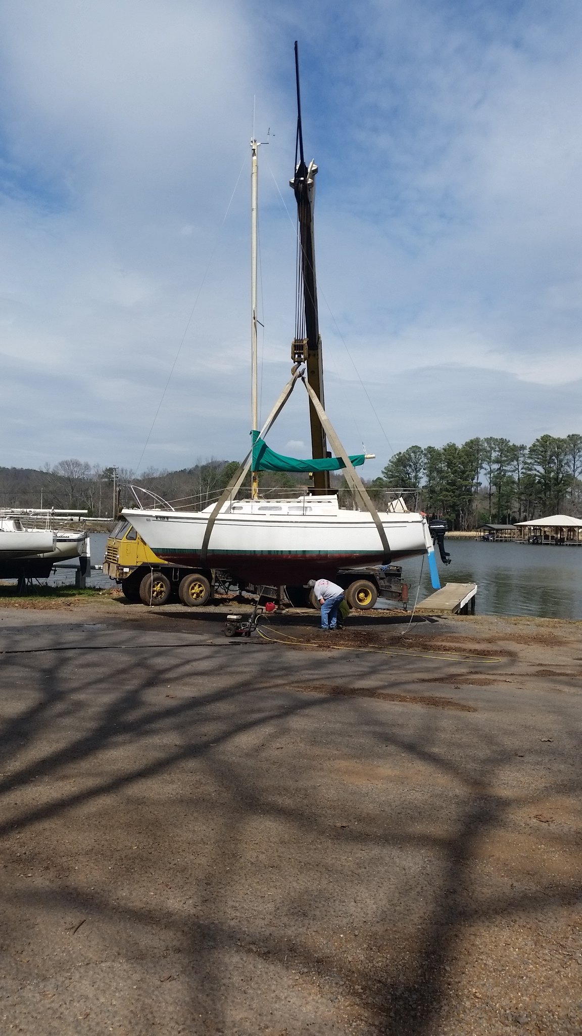

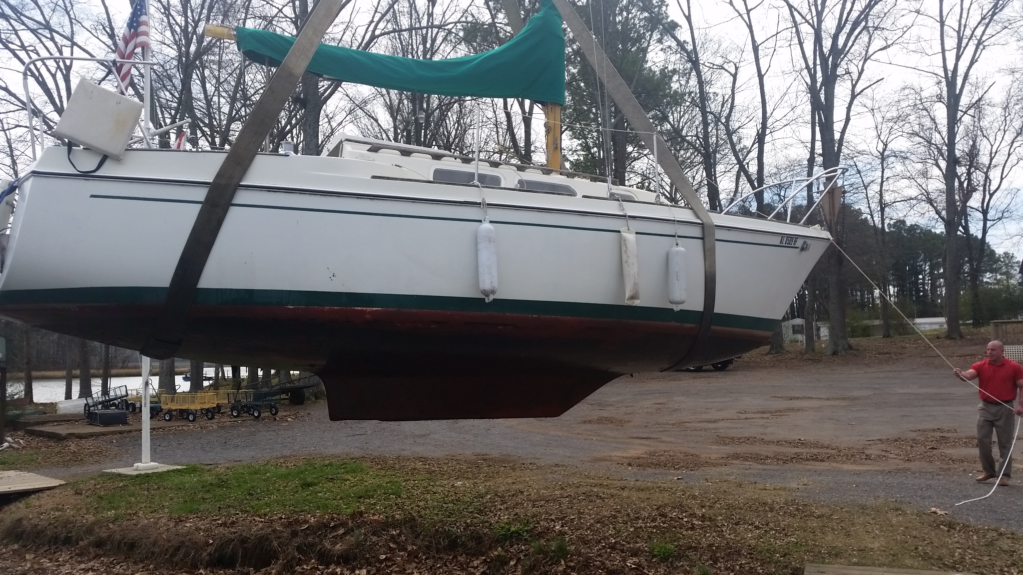

Some pics from haul out, hull was good to go with no issues to address.
JRT
Feb 14, 2017
2,060
Excellent, no screws in boat! I'm planning to use 3M VHB for mounting stuff to keep holes down to a minimum. I worked in a shipyard and we used it a lot and seemed to hold up very well.

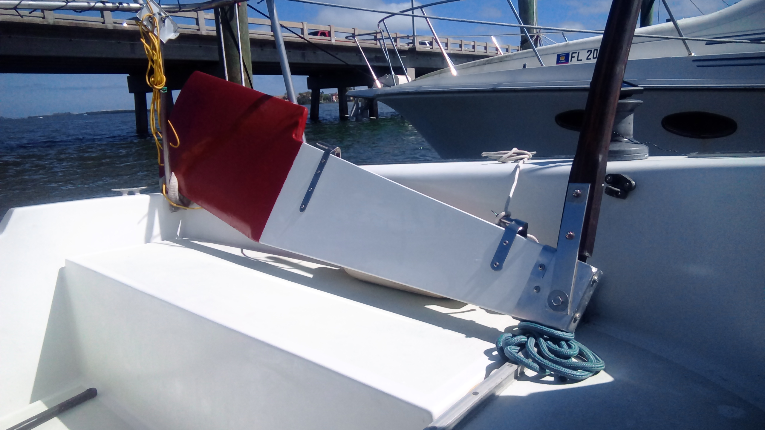

Does your centerboard drop? That can be an issue, trunk gets water into the glass and they swell.
It does now, during haul out they got it lose and checked it out. Should be fine for this season, in general I plan to leave it partially down and not all the way up in the keel. My sailing area has plenty of depth to even leave it all the way down all the time.

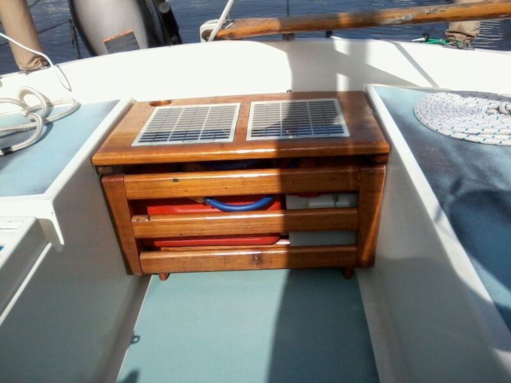

Captain Tubb, another place if I may say so is your rudder, they get water inside in different ways. I completely re did mine, when I removed bolts and nuts I looked for moisture on them, had a little but no rust. Then I proceeded to rebuild it. Mine looks bigger then yours wide but maybe same in depth. There's stories everywhere where coastguard rescues boat broken rudder and another rule is your batteries must be in boxes and firewall electronics covered. Fire with gas will blow the back of your boat off, poor ventilation down there. The no smoking lamp is on.

Thanks for the recommendation, I did review it after the pressure wash, but good point to do a check of the hardware. I know the previous owner actually spent the last year cleaning and fixing up the boat, and reported he removed and serviced it, which is why the paint was blue and new.
Is your O'Day the full keel? I actually think your rudder looks shorter but wider to me.
Battery is 1 year old and in box, gas tank is actually outside in the cockpit along the transom. Looks ugly, but well vented to say the least. I want to do this ASAP, still vented and a nice clean look.
