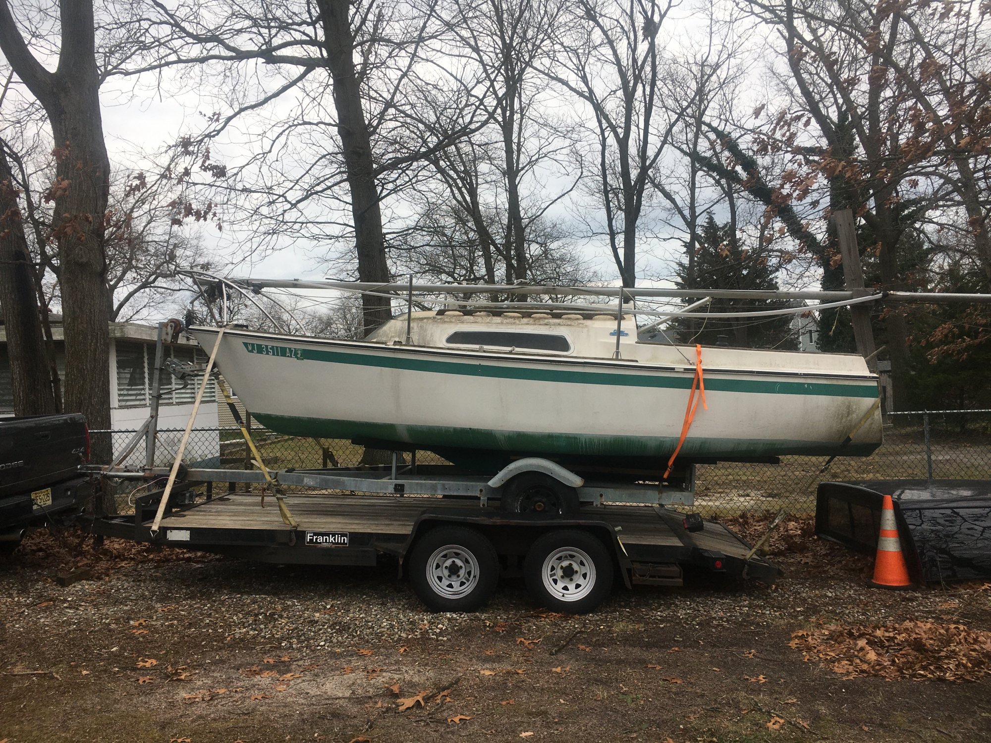

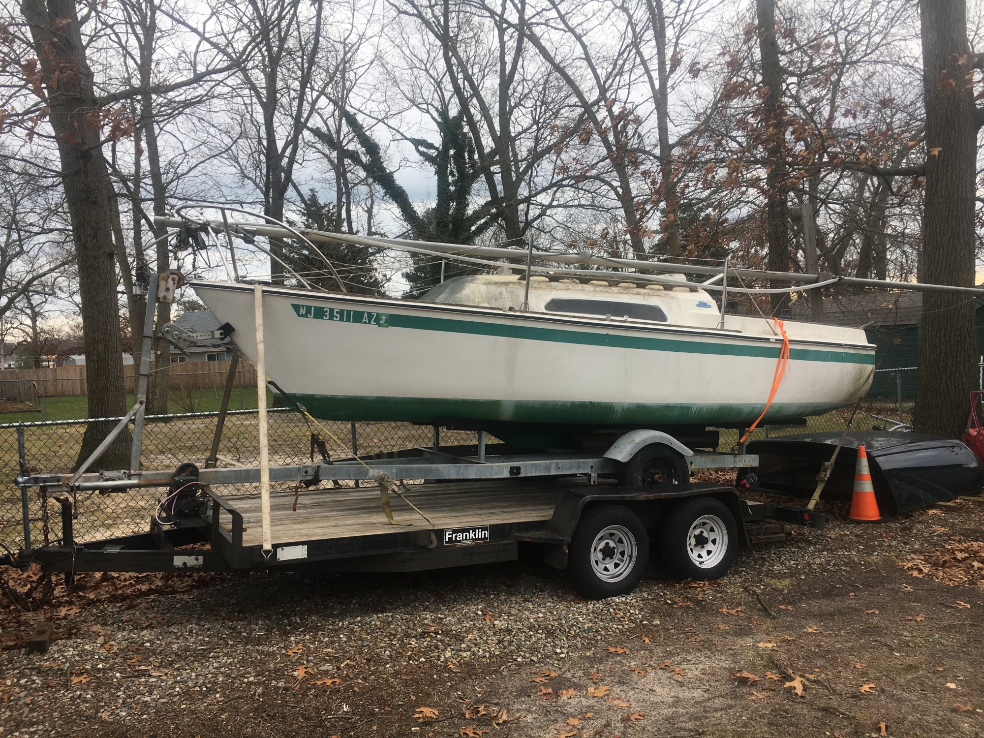

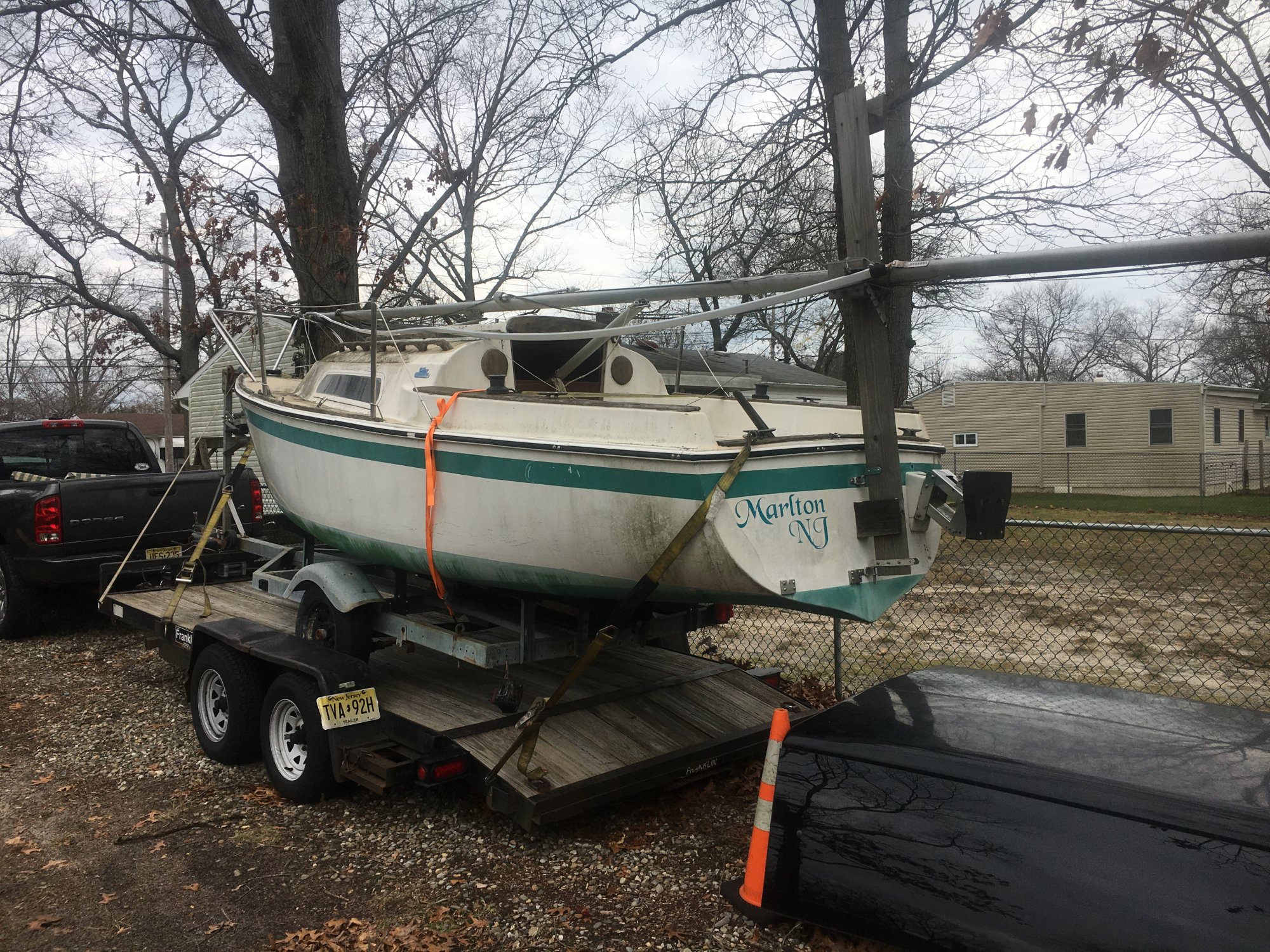

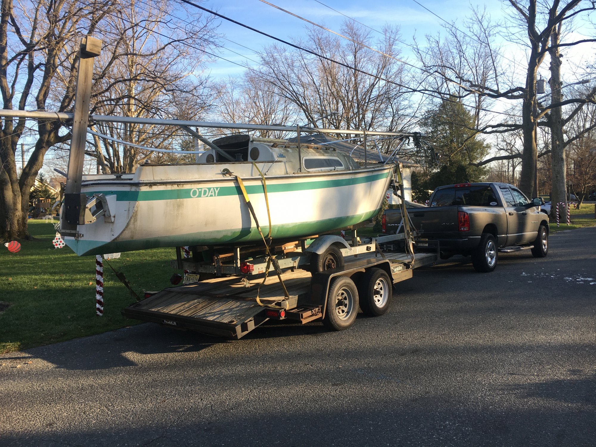

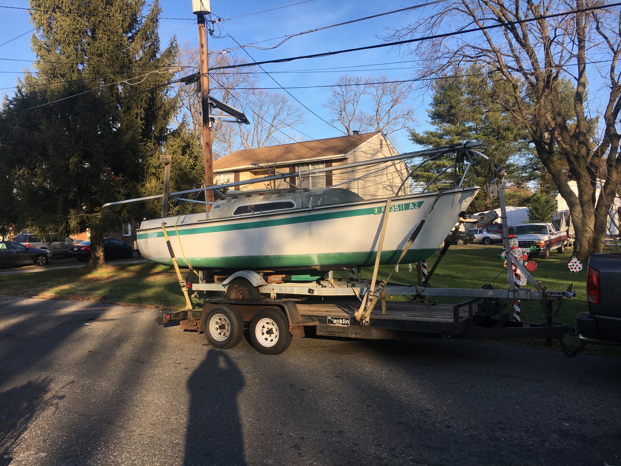

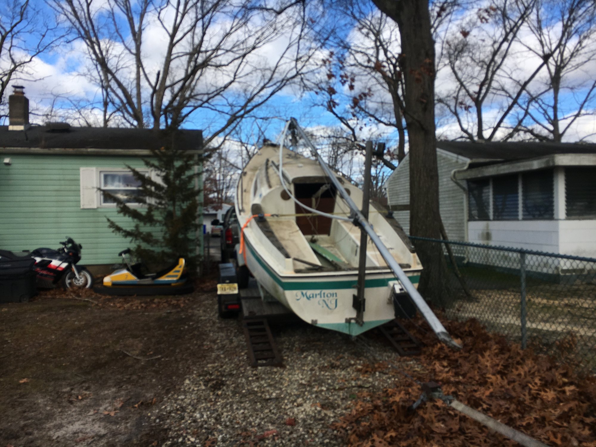

Hello everyone. I recently picked up a free 20 off a guy on Craigslist. I dont know what made me want to save the boat but I’m glad I did. Now I have this thing sitting in my backyard and I am a little overwhelmed on where I should start (besides a deep cleaning). The boat needs work. It probably had around 40 buckets of water in the bilge/floors. It didn’t come with sails or sheets but everything for the mast seems to be there. No electronics, outboard, PFD’s etc. I figured I should check the deck for soft spots but the hull is solid. Wiring is questionable and I am not sure how I am going to access where the battery is supposed to be. I’m a large guy and that’s a small space. But overall it’s not garbage, just a little neglected. The cheapest boat always becomes the most expensive though. When I picked it up, the trailer wasn’t fit for an hour and a half drive so I pulled it up on my car trailer. The trailer will need some repairs as well. Key thing with this find, the owner had a title and paperwork for the boat and trailer.
I’m not clueless to boats. My father had power boats since I was 8. I’m 48 now. First was a 1980 27’ Bayliner cruiser and then a 36’ Mainship aft cabin. I personally had a 20’ Four Winns Sundowner cuddy and a 17’ Whaler. I never learned to sail though.
When I went searching for info this site kept coming up so I joined in hopes to gain knowledge and wisdom from some seasoned sailors. Thank you for having me.

Welcome, JT.. Lots of good info here on the site. The boat looks like a keeper under the "patina".. You will enjoy the game !

Before doing anything conduct a thorough inspection of the boat swing keel, keel raising and lowering mechanism, rudder and tiller, standing rigging wires and fixtures, hull integrity, condition of gelcoat, operation of motor mount, integrity of mast and boom. etc. I would borrow an outboard engine and put the boat in the water to check for leaks, the keel and the rudder. Make a restoration budget, find out what work may be need and the parts required. Price any work you may not do yourself and price the parts required, used and new for comparison. Put down on paper a restoration schedule by order of tasks, obtaining parts and the time anticipated for the work. The big ticket items for sure are the sails and an outboard engine around 4HP. Once you know what you need , how long is going to take (anticipated time X 3) and the cost then you decide whether the project is worth it. It is not free to get rid of a free boat but you have already taken a gamble on that. I got to say the boat looks good and with a lot of patience looking for used parts and hard work you may have a nice sailer. It is not hard to find similar boats in ready to sail conditions in the $3,000 range but if not careful you may spend much more restoring the boat. This leads us to use and purpose; the amount of investment on your part should reflect how you intend to use the boat and what reliability and safety you desire.

Thank you. Cleaning it up isn't an issue for me. I have detailing experience with a fully stocked detailing shelf in the garage. As soon as the weather starts to break, it will get done.

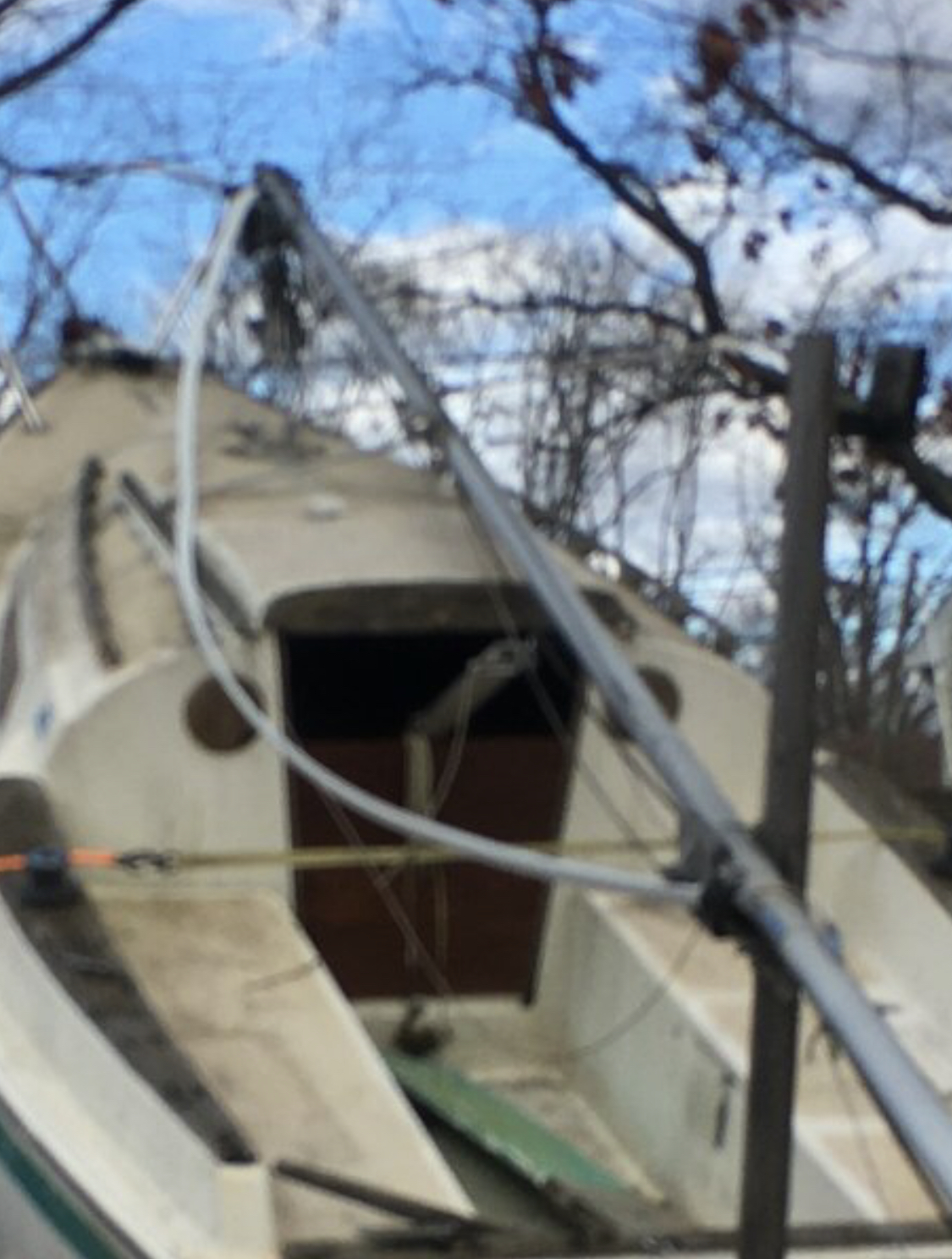

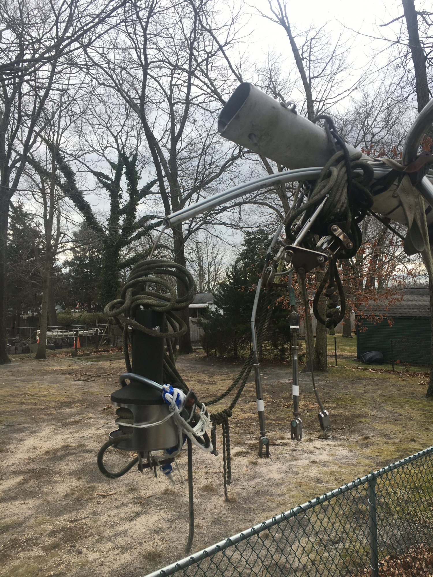

I’m not sure what the grey coloured component is - arc shape in the photo but if it’s a furler “foil” you should take it off the mast and lay it out flat so it doesn’t take on a permanent bend.

I don’t know what a furled foil is but I’ll take your advice and straighten it out. It looks like it’s slotted for a sail?

Furler foil: Google furling jib. You'll find plenty to inform you. That's a very desirable $2000 upgrade. I don't have one!

The idea is the “furler” device lets you roll the sail (jib or headsail) mounted at the bow of the boat either in or out making it larger or smaller depending on how windy it is. There are other benefits as well. The “slot”is where the sail attaches to the furler,if the grey part gets warped it won’t work.

Yes, now I know what you are referring to. I don’t think that’s what it is but I’ll try to sneak a peak under the tarp tomorrow. I don’t recall the lower round unit on the boat or rigging.

That's great, but you need to get it off the boat and straighten out the track portion. It is not doing it any good having the weight of the reel hanging there. Half an hour's work will do it.

Looks like a CDI furler. As mentioned, you should make sure that the plastic foil has better support and doesn't kink.

I have to be honest, knowing how bad dealing with a poorly maintained old furlers, I'd pull it off entirely and just switch to hanked on jib to make it simple to learn and deal with. We aren't talking about a huge sail in a 20' and for learning since you need new sails I would stick with nothing bigger then a 110 size in a basic sail. Save those boat bucks for down the road for when you really know what you want out of this new and exciting journey.
