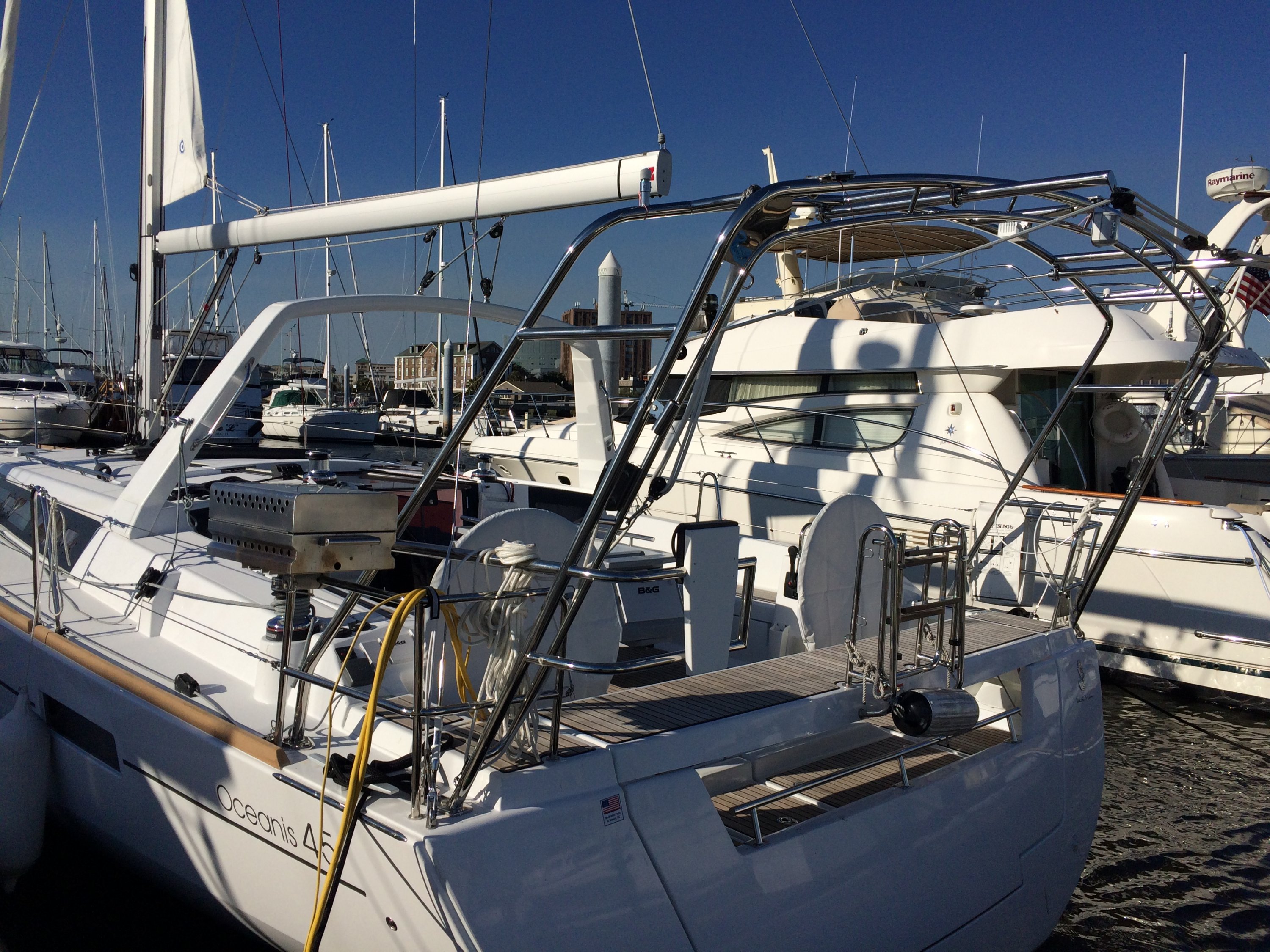

Got the 45 a few months ago. We decided to add the arch. Got ours from Kate marine. More costly but really excellent arch and much stronger than factory install.

Why not the factory one?
Is it too weak?
Is Kate's arch better? How is mounted? Can you upload some pictures?

KATO marine.
Keevers, you should send that glamour shot to Keith at KATO. He will post it on his website.

Arch is from Kato marine out of Annapolis
The Arch looks beautiful. I also have an Oceanis 45 and am shopping for an Arch. I'm up in Annapolis and walking distance from Kato. Do you know yet what you are mounting on it?
