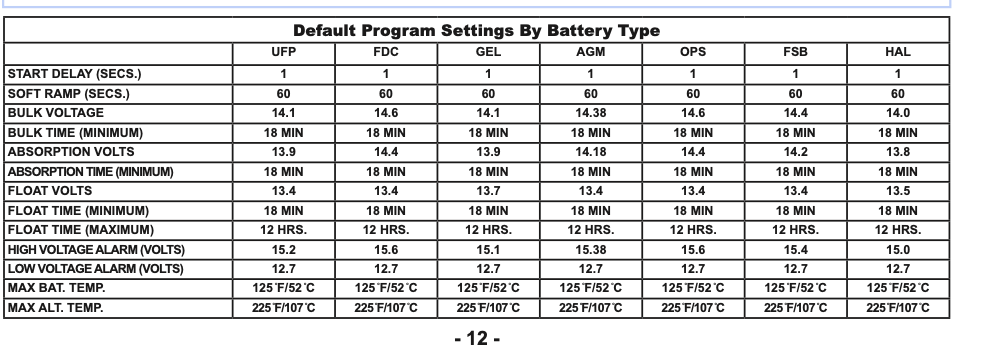

Have you checked the Error Advisory codes?
The following advisory codes can be used to determine possible system errors or to identify specific operational modes. Note that E codes are cumulative and will be held in memory until cleared. Codes can be cleared by entering dSP and letting it save. Display settings DO NOT need to be changed. See basic programming for more info.
E40 BATTERY VOLTAGE TOO HIGH. OVER 16 VOLTS
E41 FIELD VOLTAGE TOO HIGH.​
E42 STATOR VOLTAGE TOO HIGH.​
What did you do about programing the unit?
13,970
Go back through and check the settings on the 614. They are a PITA to program. It would have very easy to set the bulk charge voltage to the wrong voltage.
There is a good set of instructions on programming the 614 ( which also works for the soon to be discontinued ARS-5 and the MC-618) on MarineHowTo.com. Also, if you have a 12v DC source at home (a small lawn tractor battery works) it is much easier to sit in a comfortable chair and program the regulator.

well....you guys nailed it
the darn thing is difficult to program
think i got things sorted out will do more testing
