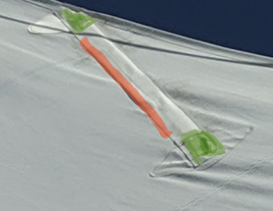

Our 2014 37 came with a Neil Pryde RF main with the flat partial vertical battens. No significant issues from the battens. Occasionally we’ll have a jam unfurling the sail but only if we’re not careful about keeping the wind off it.
We don’t have the non-Velcro batten pockets BigEasy mentioned. Our pockets have Velcro along the leading edge and are not great. Need to have at least two pockets restitched every couple seasons. I asked a Neil Pryde rep at the boat show a couple years ago if there was a better design. He said no, but maybe he didn’t understand the system I have.

The opening slot for the batten is midway along the length of the vertical pocket; the batten is flexible enough to enable it to be inserted and bent into the upper & lower length of the pocket. Once the batten is in place, it lies flat and sort of locks into the pocket without the need for Velcro closures. Results in a very flat profile.
Mine goes into the pocket the same way as yours, but the front of the pocket is Velcro (except the top and bottom, which is stitched). Looks like this -
The red highlight is where the Velcro Is. Green is the top and bottom where the batten flexes in. Problem is that the Velcro lets go, and then the place where the Velcro meets the stitching begins to tear.
I’ve tried using some sail tape to hold the Velcro if it starts to give up mid-season. That still isn’t a perfect solution though, and eventually it ends up looking like this -
Still, despite the unsightly appearance it worked fine and didn’t jam in the mast; it just needs repairs every couple winters.

Mine goes into the pocket the same way as yours, but the front of the pocket is Velcro (except the top and bottom, which is stitched). Looks like this - View attachment 177749
David,
I have no vertical pocket opening & Velcro depicted on the forward edge of the pocket as shown in orange on your photo.
My pocket has a horizontal slot is midway between the pocket ends shown in green on your photo. As I mentioned I had the modification done about 6 years ago and haven't had any problems whatsoever. If I can get a decent photo next time I am on the boat,
I will forward it to you.
