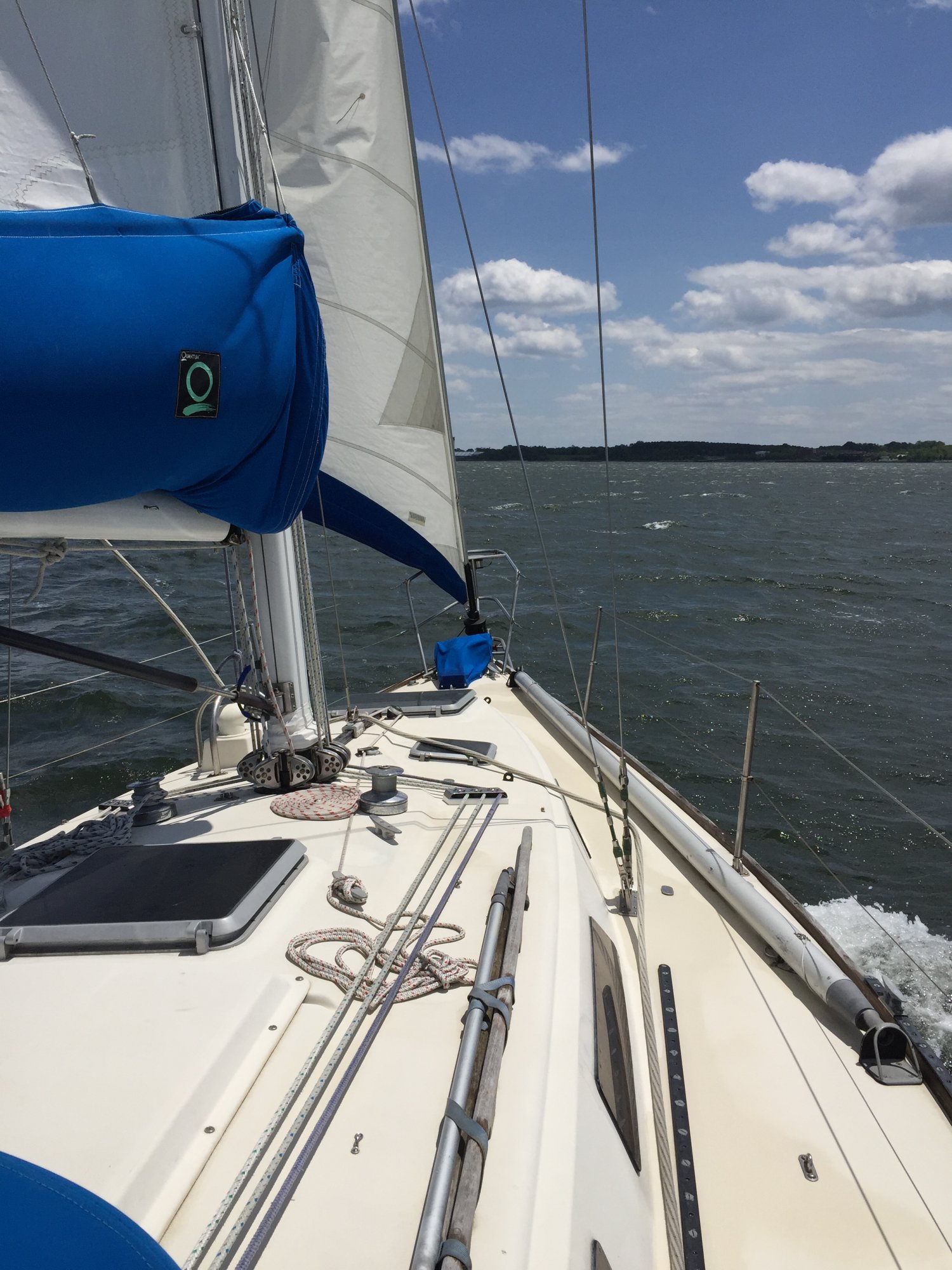

Probably a "stupid" question, but how do you do a sail pack with a loose footed sail?
Not stupid! The tack and the clew of the sail are attached to the boom, as is the sail pack. I couldn't find a good photo of my setup, but here's a shot of the forward portion of the sail pack.

So, does the sail pack foot "float" with the foot of the sail and is it attached to the foot or is it attached to the boom?

No, not attached to the foot of the sail. The sail pack has two or three cars or slides that go into the track on the boom.

Seems that would restrict the movement of the foot of the sail away from the boom when the outhaul is loose and the sail attempts to move away from the foot? :huh:

That was my thought. I see no way for the sail pack to not effect wind getting to the foot of the sail. But I LOVE the ideA

There is enough play in the sail pack so that is not an issue. If it were, I could loosen the lazy jack lines and drop the pack so it's level with the boom. There is a fiberglass rod that runs the length of the sail pack.
