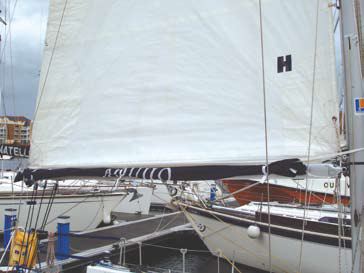

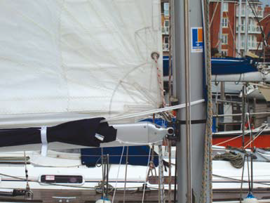

Here's a picture of a sailpack in Race Mode. Lazy jack lines are retracted and pulled to the front of the mast, and the sailpack canvas is rolled up and strapped to the boom.
This is not something you want to do for every day sail, because it's time consuming. For a day sail, you will want to leave both the sailpack and the lazy jacks fully deployed.

The photographs that DrJudyB posted with the sail cover wrapped to the boom is how I set up my (first) sail pack for distance races. That pack was a PITA though, and I ditched it for retractable lazy jacks. However, a few years ago, with most racing in my past, I purchased a new sail pack that is far more convenient, although I still do need a TIDES system. I'm short and the boom is high.
