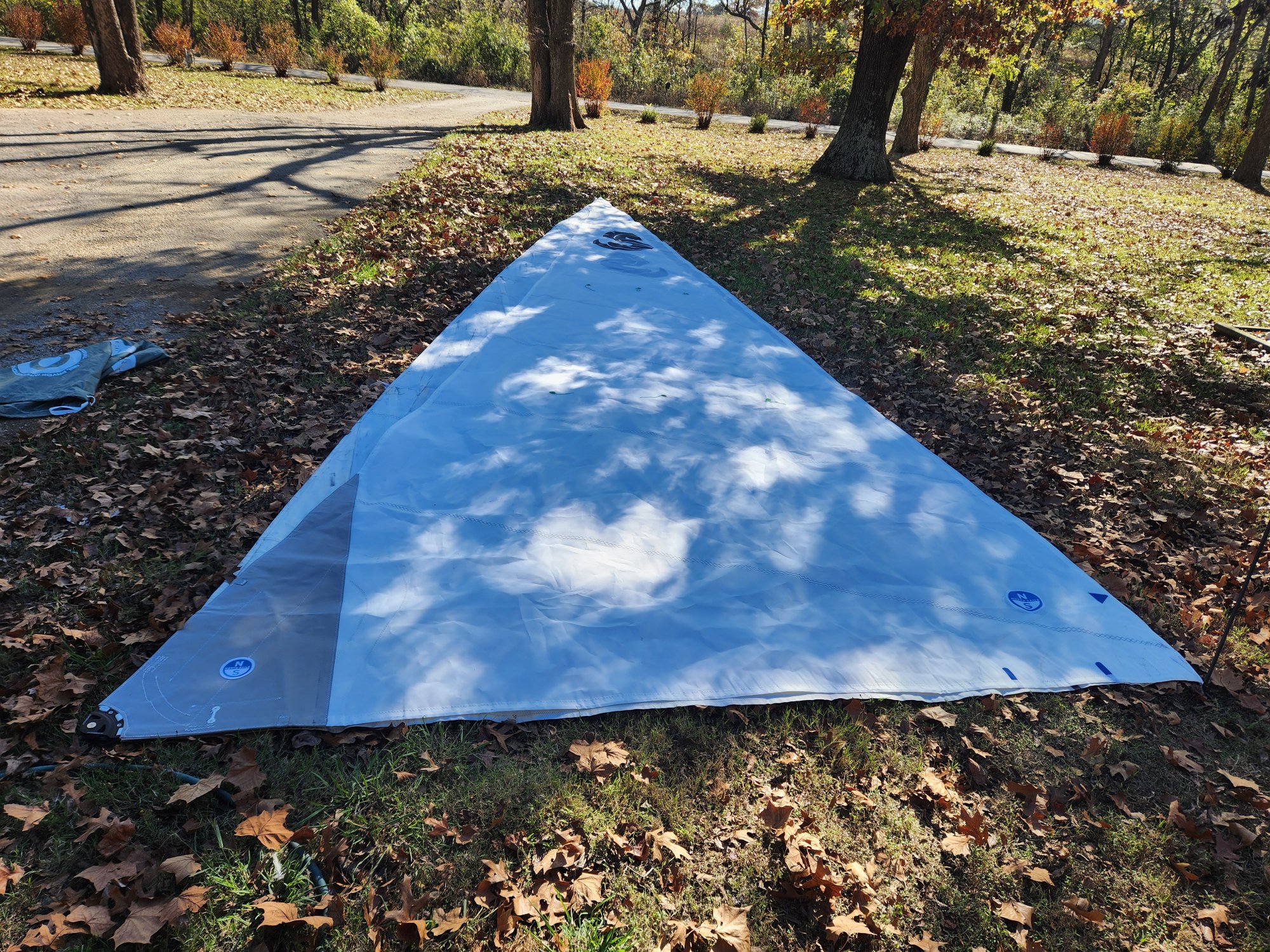

Approximately early August I contacted North Sail about a new main and jib. After a little back and forth my salesman said they, NS, had plenty of measurements for my Beneteau 31 and that I didn't need to measure my boat. The sails arrived about 6 weeks later, all good so far. The jib fits and looks good, sails good too. I install the main about 2 weeks later and I could not get the luff tight. So a month later when the weather permitted i removed the sail. Today I finally got to lay the new sail on top of the old one. This new sail is definitely too tall.
I've sent North Sail 2 emails. Hopefully they offer some assistance, but it's been my experience that after the sale most business customer support is terrible! I've been battling with my phone provider now for almost 2 weeks, they are totally incompetent. The place i bought my prop from didn't impress me either, I just decided to live it under pitched.

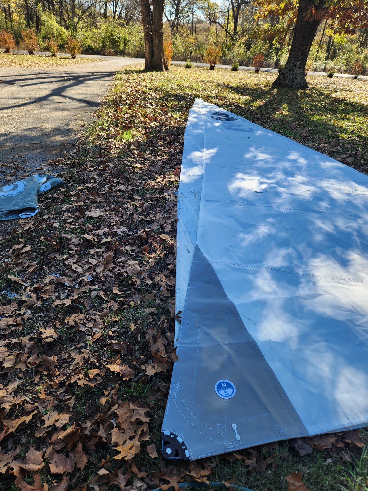

That happened to me aswell, eventhough I had measured the original sail luff. The sailmaker said that I had measured it wrong. I layed the 2 sails on top each other and sent them the photo. I sent my sail to them to measure themselves. I guess I was lucky that they sent me a proper size main sail.
Typically they do not custom make the sail, but ship you a pre-made one.

Approximately early August I contacted North Sail about a new main and jib. I install the main about 2 weeks later and I could not get the luff tight. So a month later when the weather permitted i removed the sail. Today I finally got to lay the new sail on top of the old one. This new sail is definitely too tall.

Does it fit from head to tack without bunching up? Not tensioned, or even with all of the wrinkles out, just without pushing it into the space. Is there a Cunningham hole?
It is possible that it is a full size sail, intended to have more area when the Cunningham is eased, and then tensioned with the Cunningham for up-wind. Not sayin' that is what you want, but see what they say.
I would also measure your boat. It might not be stock dimensions. Not that unusual. Every sailor needs a 100-foot spool tape.
I got a new sail 2 weeks ago. It measured 6 inches longer than the old one. But the new one was a lower stretch material, lacked accumulated micro-wrinkles, and when pulled even reasonably snug (50 pounds?), they were the same size. (I laid them out before I bent it on the first time). The foot measured the same.
BTW, the sail is designed to fill the space from masthead to boom, and then be tensioned with the Cunningham. If it measured right with tension, I would be giving up area off the wind.
It's a roller furling main so it really needs to fit correctly. I'm not set up for a cunningham.
There could be something odd going on. The original owner, the 2nd ower and myself have all had difficulties furling the main. I bumped into the salesman that sold the boat to the original owner this year at the Miami boat show. He told me they had to replace the drum and bearing unit due to aluminum cuttings getting into it when the mast was assembled. So this appears to be a long time issue.

My dealings with North Sail involved the local sail loft manager. He visited my boat and we measured. Upon delivery of the main and genoa the extra guard cloth for the mast radar was positioned 6” high. I took the sail back to the loft and the error was corrected. No hassle.
I would encourage direct communication with the nearest North Sail loft. Emails are convenient but they can get lost. It sounds like, from your post, that a problem occurred. It is an issue that they can fix and should fix.

I did a little digging online today looking for the main sail measurements for my boat. All the dimensions that I found were for a traditional sail not a roller furling sail. Then it occurred to me that might be way my sail is too tall. The top swivel/bearing assembly needs about 6 of space. I'll run that by my contract at NS and see what he thinks. I plan to hoist a tape measure this weekend, maybe. I already know the sail is too tall.
I have, so far, been impressed with the response from NS. I hope it continues on this trajectory.

I had a problem with my North Sail main, which interfered with the backstay and topping lift way up high. Their first response was to get a rigid vang so I could ditch the topping lift….i asked them if they were paying for it:poop:
I finally got them to replace the head board to a smaller one (the one they used was too big) and they had to reshape the luff at the top. It seems ok now. But I figured they came out and measured, they knew I had a topping lift, etc. so I was not going to let them off the hook.

If North used the non-furling length ...
  • Was the boat available with a traditional sail?
  • If yes, did the order state that it was for a furling sail? It surely must have, from the lack of battens and hollow leach. Thus, they knew. The sail is obviously designed for furling.
Good luck. It sounds like a good case.

One can't just put an old sail on top of a new one and get any information out of that. For measurements, sails need to be pinned down and stretched. Old sails almost certainly have shrunken bolt ropes that will make them shorter than when they were new. They also will definitely have a different (stretched out) shape.
This doesn't mean that your sail isn't too long - it just means that what drove your assumption isn't correct.
The biggest takeaway here is ALWAYS have your boat measured for new sails. Always. Unless it is a club class where every sail and rig is exactly the same by force of rules, even identical brand/model of boats may have slightly different rigs or different rig tunings or different gear like furlers - North may have measurements for a different furler model than yours. Never assume anything when getting new sails.

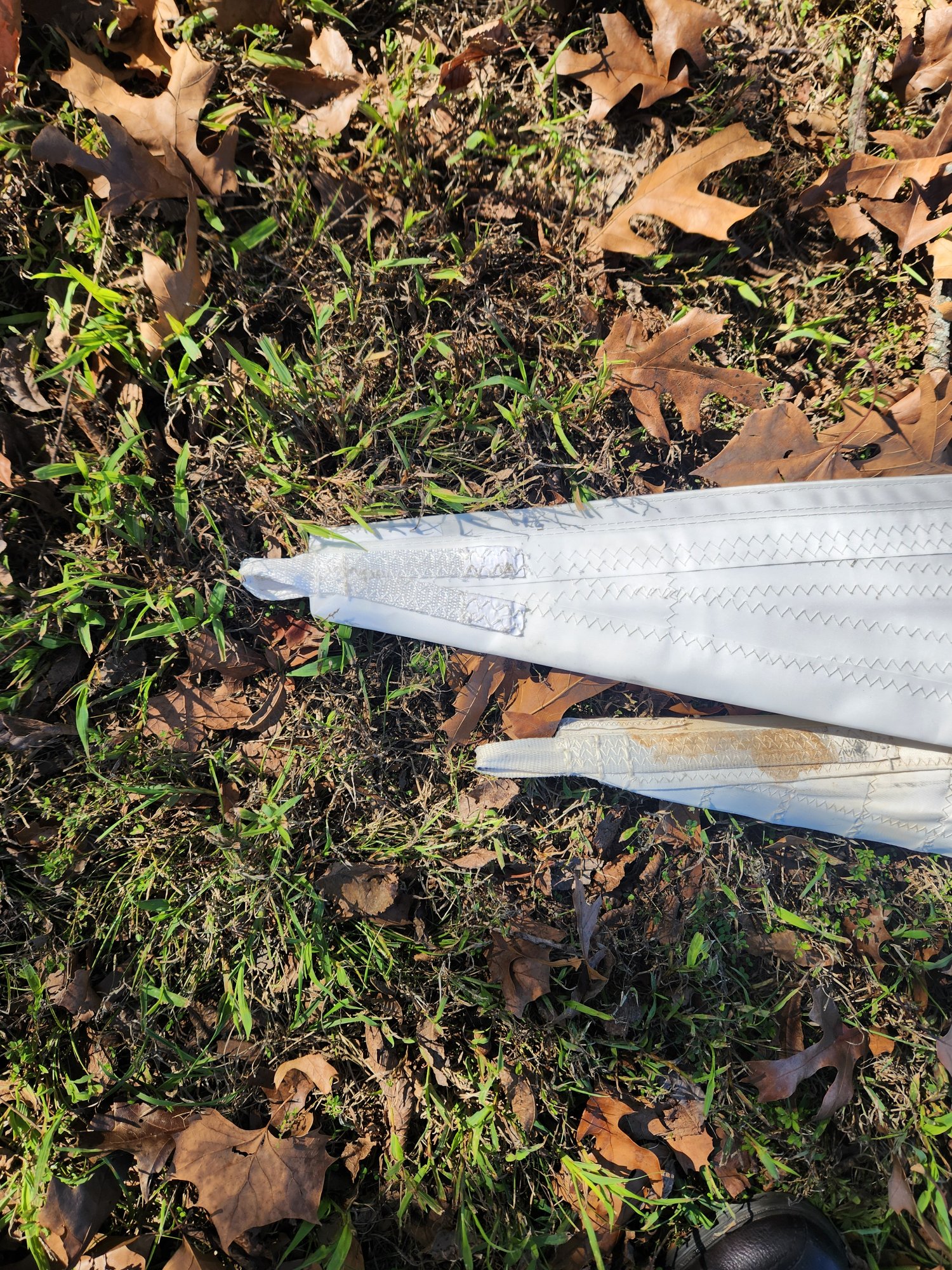

As for the troubles with furling, that old sail has a lot of positive roach and what looks like removed reinforcement points for batten pockets (pictures are blurry at that level of zoom). Are you sure the old sail was originally built for a furler and not the standard sail with the battens and pockets removed and stuck on the furler? If the latter, then I definitely would expect furling issues.
Mark
It does have more roach, but the pockets look vertical. Syclone has a Beneteau 31 and I’d bet that sail is the same Neil Pryde “power batten furling” style Beneteau put on my 37.
Jul 23, 2009
931
Yes. The sail was originally equipped with vertical battens, I expected the new sail to have them as well but I didn't ask and I'm not complaining about that.
