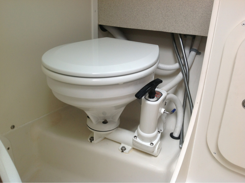

Hi All
Just bought a C 310 and love it. The head literally died.:eek: Fell apart. I'm looking at replacing the Wilcox, primarily because you can't get the parts anymore. I've looked at the new Jabsco and wondered if anyone has installed the Jabsco Regular size. I know the compact fits. Feed back would be really appreciated.

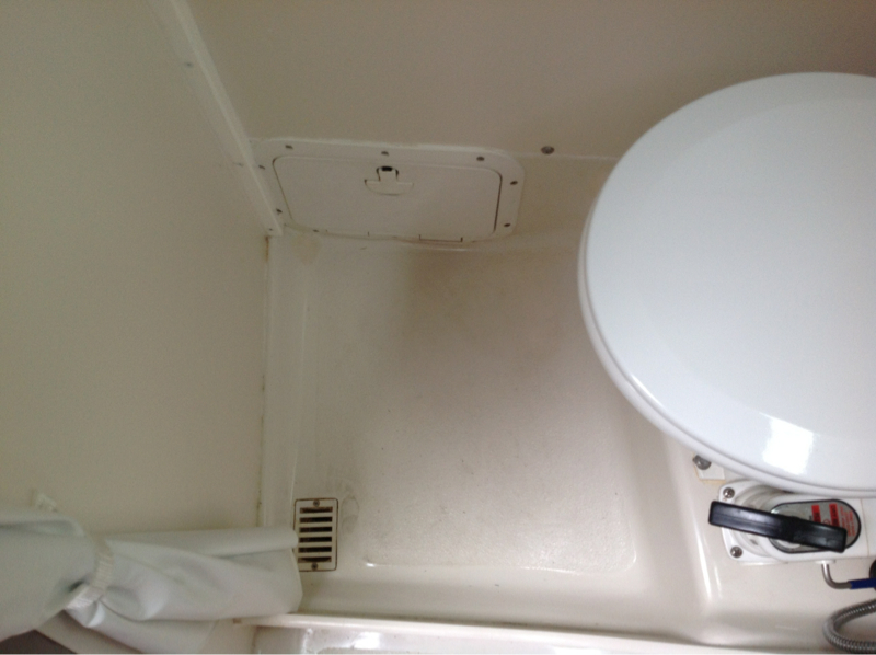

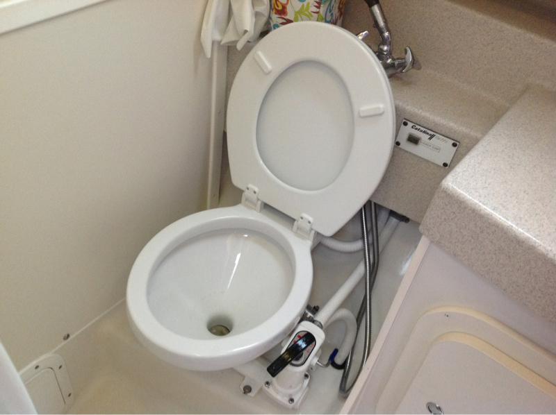

my W&C was holding together, but i needed some more real estate. so i swapped out the W&C compact bowl for a Jabsco regular (household size) bowl only. those extra 3 inches are great. and the measurement you are looking for, 15 inches of knee room from bowl to wall. i hope it works for you.

Hi Pan ....... thanks for the response. Did you have to move the base mounting closer to the edge? When you lift the seat up is there enough room for the seat and lid to fold back and not fall forward?

You are welcome. Regarding the edge, i did not move the base, I used it just where it was. As you can see, the seat cants back a bit and stays up on its own.

Well got it installed. Went with the Jabsco Regular, more comfortable. I had a number of discussions with Caribbean Cruisers and they swear that Maintenance, Maintenance and continuous Maintenance is the KEY. They said that the best cure was Mineral Oil and Vinegar. Some of the Heads where well over a decade old.
