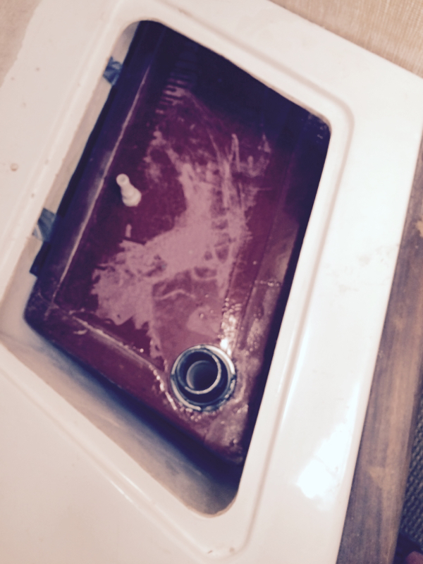

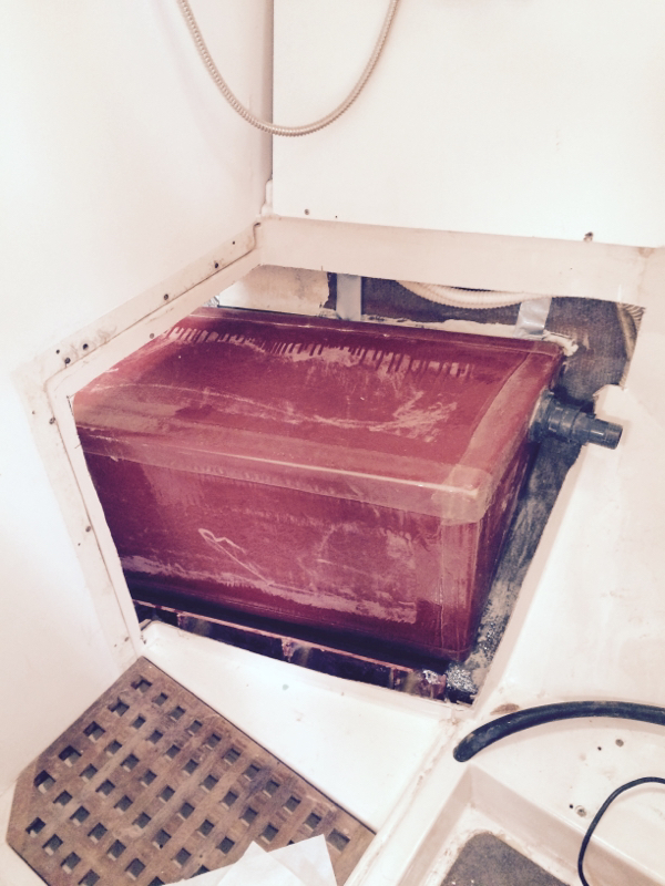

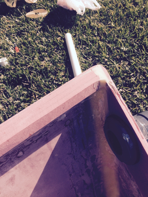

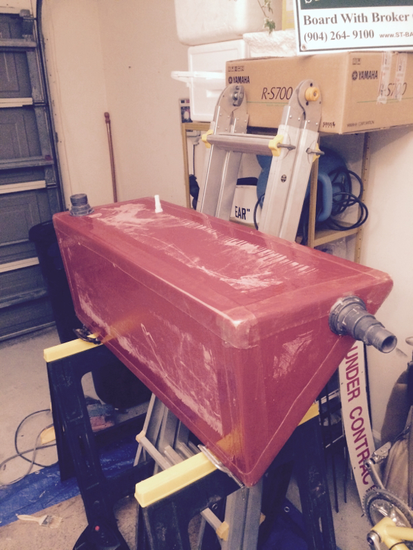

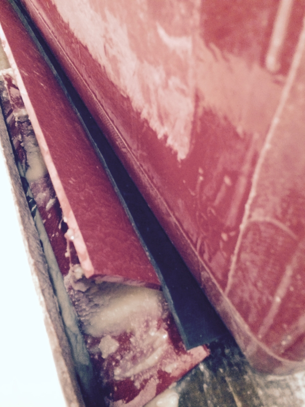

This project started in ernest in October. Today I finished the fiberglass tank and thought you might like to see it. I'll post more photos once it's in the boat.
Oh, another change in plans - I didn't install an access port. I figure it is one more place to worry about a smell escaping from. But I did reinforce the top with an extra 1/4 inch plate (inside) and have reserved space to cut a 6" hole and 9" cover in the future.
And the pictures also show the extra internal lip I made in the back (acute angle side) to help set the top.

I am in the producing a fiberglass tank similar to yours and I have a few questions.
How thick did you make the tank?
Did you line the tank to make the interior smoother therefore cleaner when empty?
What kind of fittings did you use for the inlet and outlet?
Thanks

Sailorjack,
Good luck with your tank. I used 1/4" manufactured FRP panel. Very strong material. I installed two internal baffles to reduce sloshing, but mainly to strengthen the tank structure (keep joints from flexing). May have been overkill, I feel good with them. I recommend you look at this link from Good Old Boat, that's where I got my basic education on stitch & glue.
http://www.goodoldboat.com/reader_services/articles/sanitation.php
I did not line the inside of the tank. It will never be clean but it should empty well enough.
Tank fittings are Spears SCH 80 CPVC tank adapters. I bought them at the local plumbing supply store. The body and gasket are installed FROM THE INSIDE, see manufacturers instructions.

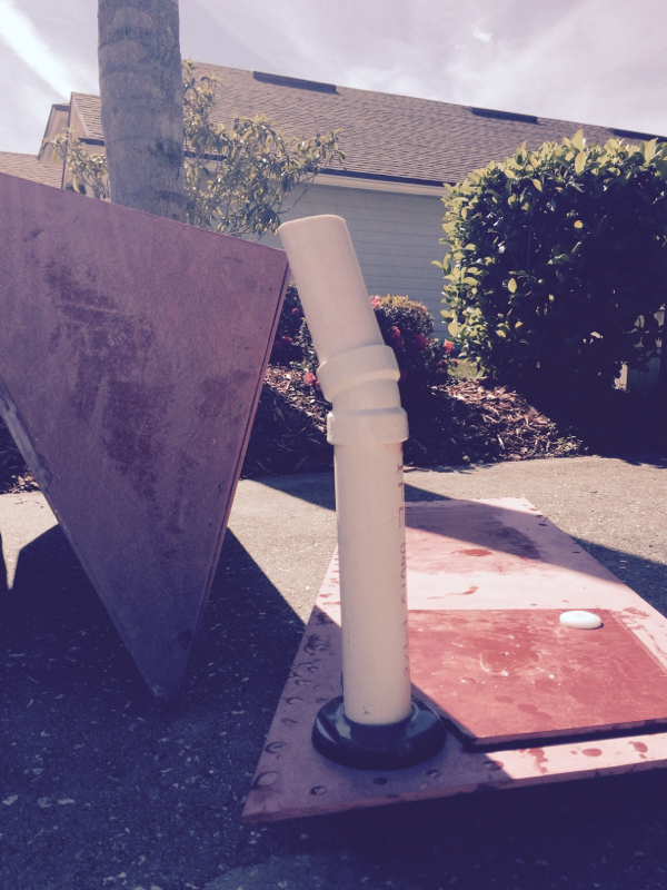

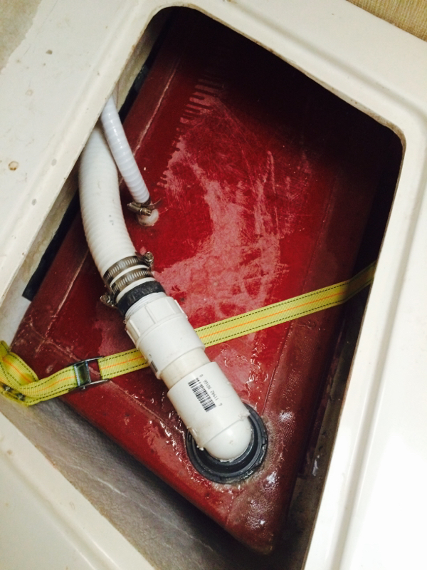

All,

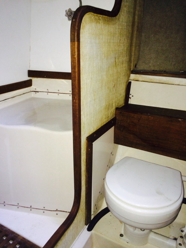

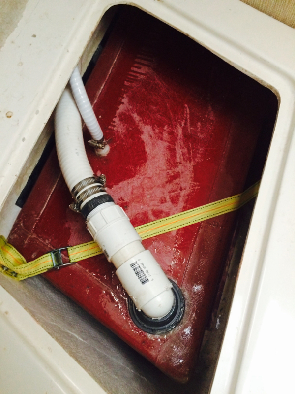

I am finishing my tank installation now. Tank, hoses, deck fitting, shower seat, shower wall, and head have all been installed. I'll post some final photos.

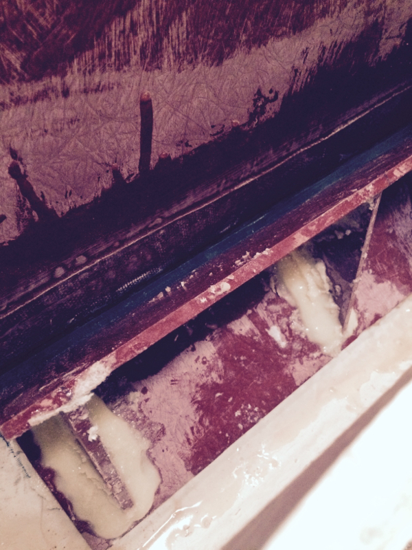

Two things I don't have photos of: the shower seat repair detail and the tank tie-down detail. I used the same 1/4" FRP that I used to build the tank and cut in 2" wide strips to backer-block the shower seat joint. Screwed together at 4" spacing, the joint is very strong. When I first planned out the project, I feared cutting out the seat. Now that it's done, I'm not unhappy with the way it turned out. The seat HAD to come out to remove the old tank. I can hide the scars with teak molding someday, probably never. Just seal the seam with latex caulk.
Also, no picture of the tank tie down. I will use a 1" wide lashing strap with cambuckle (from Harbor Freight). Screw the strap ends to bulkheads on either side of tank and ratchet it down snug.
Thanks again to all the knowledgable boat owners who post to this forum. I have more projects planned, thanks to your help and inspiration.

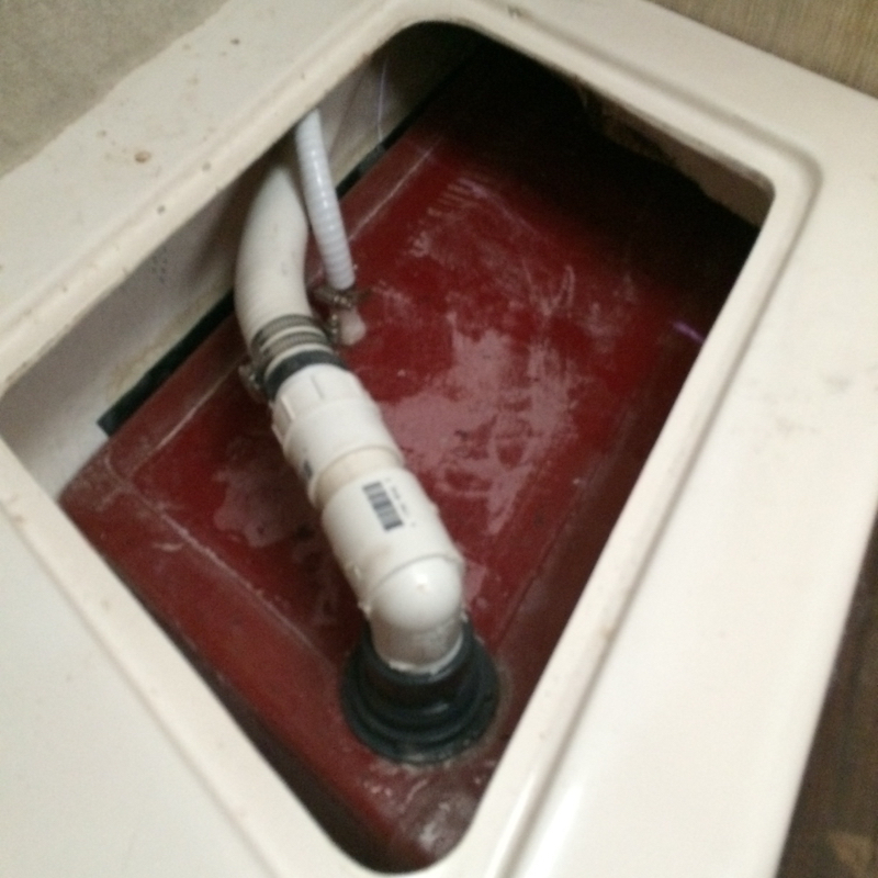

One last photo. Here's how the tank is strapped in place. Note in earlier pictures that the little floor I built holds the bottom of the tank against the hull.
