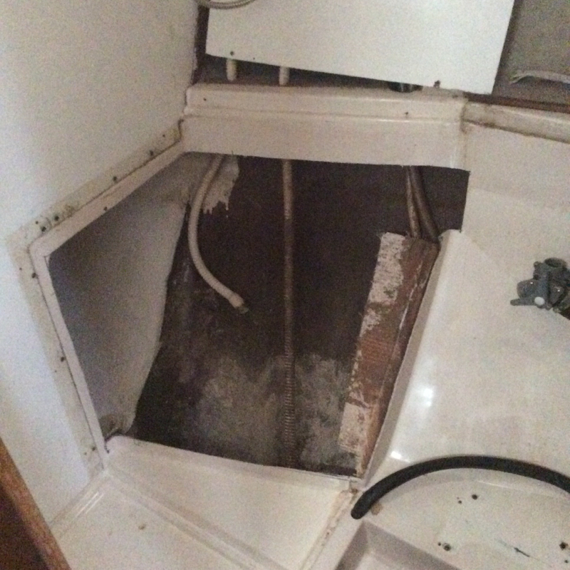

The original aluminum holding tank gave out on my '82 H 37. I want to replace the tank with a larger one. My preferred location is under the shower seat and extending into the starboard locker (I have an AC compressor in the center v-berth locker so all the suggestions about putting it there do no good for me).

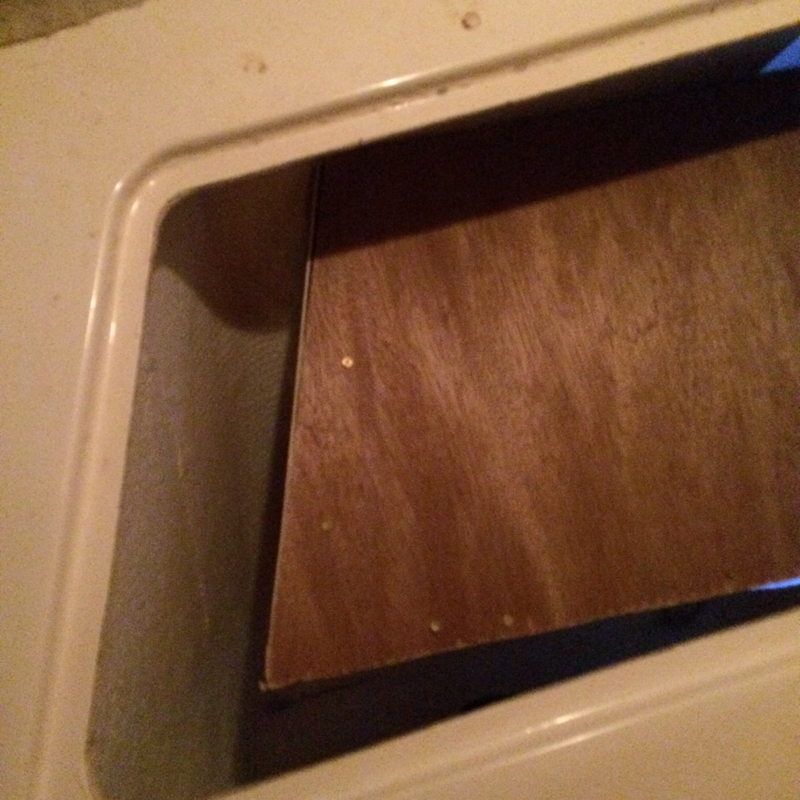

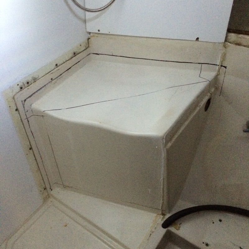

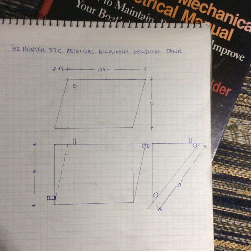

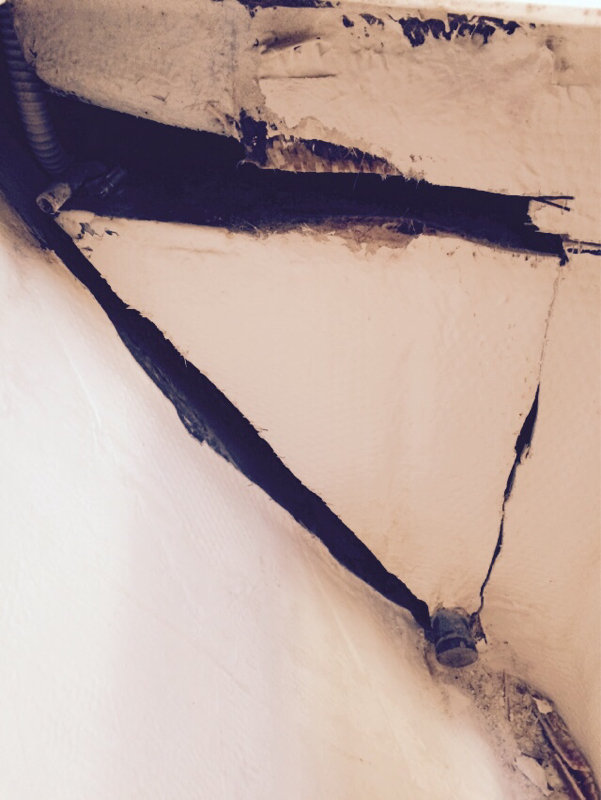

I started by cutting around the tank from the forward locker (photo 1). The tank would not come free. It was obvious that it was tabbed in under the seat. After lots of research on the forum, eventually I decided to go forward and cut out the shower seat (photo 2). Oh, and I temporarily removed the partition between the head and shower and the cabinet. Whether this is a good idea or not, time will tell. At least with the seat out I could release the tank from the hidden tabs of fiberglass that were holding it in place. If anyone wants to know original tank dimensions, I have a measured drawing of my original aluminum tank (photo 3).

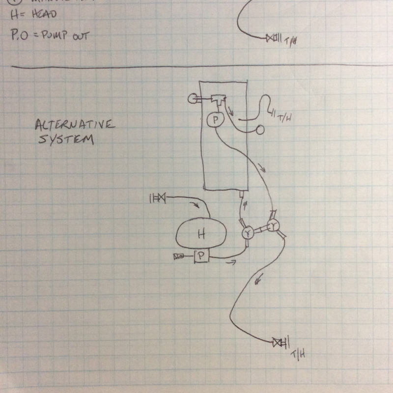

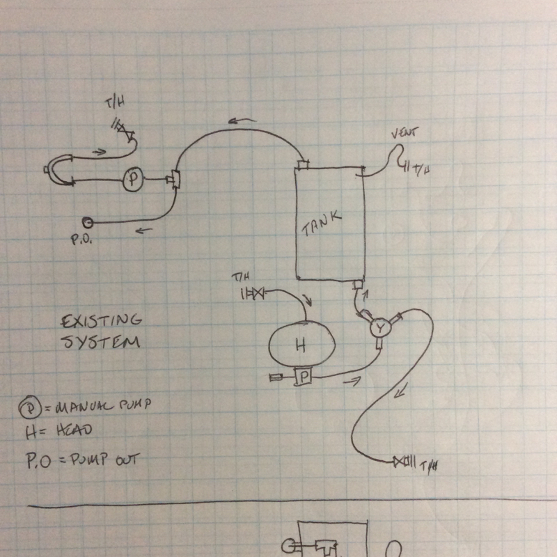

And since I'm designing a tank, it's time to rearrange the plumbing too. Photos 4 and 5 are existing and alternative plumbing designs, respectively. This will get the hoses out of the port hanging locker and port v-berth locker. I won't try to describe all here. If you have time, take a look at the drawing and let me know what you think.

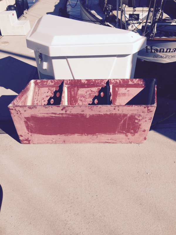

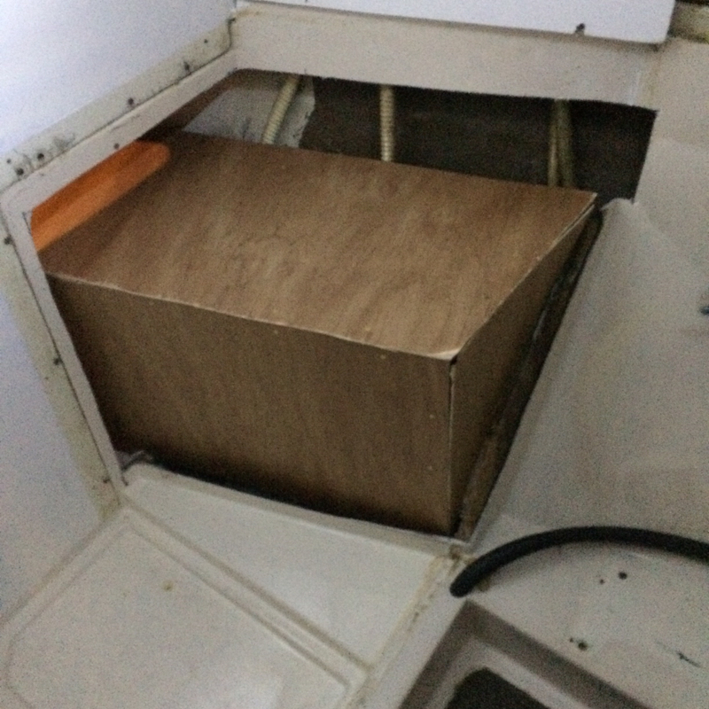

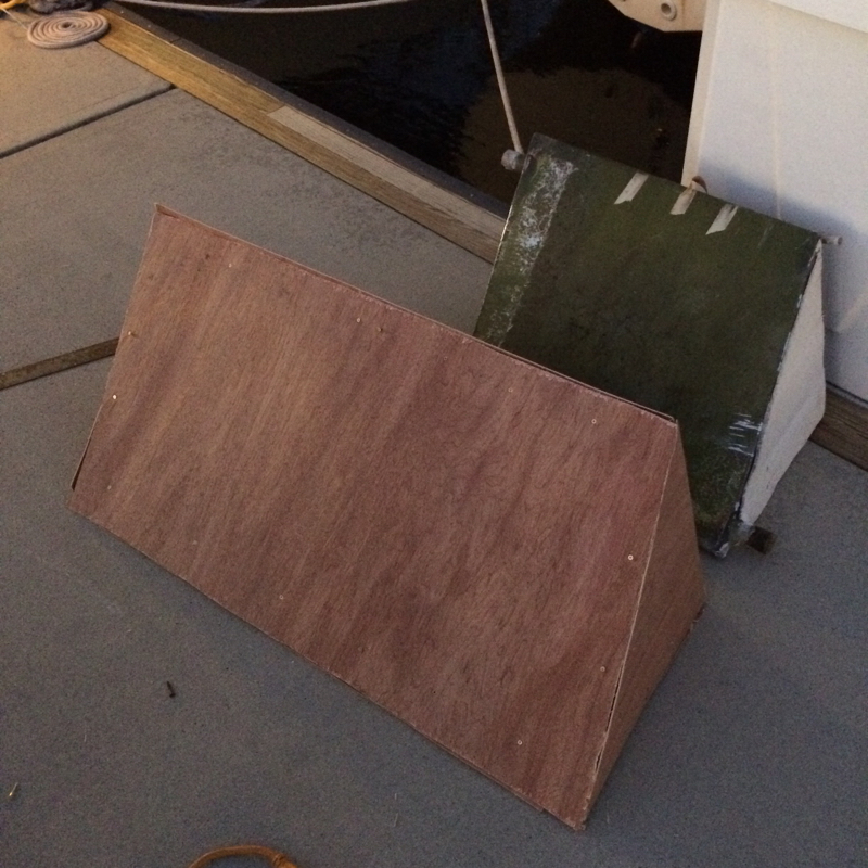

But before ordering, must make a full size mock-up to make sure it fits. And I did that today. Photo 1 shows the mock-up next to the original aluminum tank. Photo 2 is the mock-up in the original location. Photo 3 is the mock-up extending into the starboard v-berth locker. Photo 4 is the shower seat fitted in place over the mock-up. It all seems to fit better that I hoped for.

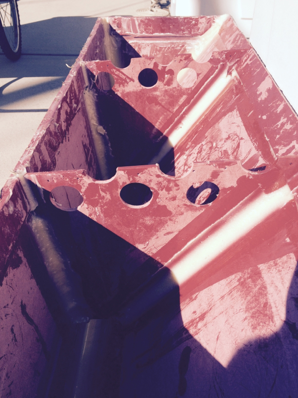

Hello again. It's been months since I started this project so here's an update. I finally decided to build a custom tank using 1/4" fiberglass panel stitch & glued with West System. I decided not to go with a custom welded aluminum tank even though it would have cost less, been A LOT easier, and I'd been done by now. Though I regret that decision every time I sand fiberglass, at least nobody can accuse me of taking the easy way out.
Two photos of the tank in progress are attached. I followed stitch & glue advice I found online at 'this old boat'. You can see there are two internal baffles. I also added an extra 1/4" strip around the inside at the top to give more support and internal surface to glue the top to. After the top is on, I'll reinforce all external seams with fiberglass cloth and epoxy.
The top will have access port. I have worried over wether or not to include this port and have finally decided to do it.
Final step will be to secure the tank to the hull. I think I'll tab in some small supports for the bottom to rest on and then glass the top and bottom of the tank to the hull. These connection will be accessible and can be cut if the next owner needs to remove the tank. I'm not doing this again.
One more piece of advice to those who may want to do this project. The dimensions shown in my first measured drawing did work on my boat but the tolerances are pretty close. I got brave when building the tank and didn't exactly follow the mock-up. I was surprised how close I came to the tank not fitting! Lesson learned is that customizing something new into the boat takes a lot more care in planning and construction than following and original design.
I always enjoy all your comments. You can see that I was persuaded away from aluminum tank. I won't regret that decision after I'm done. My tank will be bomb proof. Thanks again for all comments and wisdom.

Looking back, I see I never gave the dimensions for the new tank. I'll just tell you that I simply increased the length to 48" overall. That worked best with construction using a 4x8 sheet. Seems to have been the right length so far.
Jun 2, 2004
5,802
Good looking tank, nice work. Wish mine were new. Still original aluminum.

Doug, you did an awesome job on the fiberglass holding tank. I still have the original aluminum tanks all round. Though I have no leaks (yet...) I am looking at ways to coat or line the existing water tanks and the holding tank.
