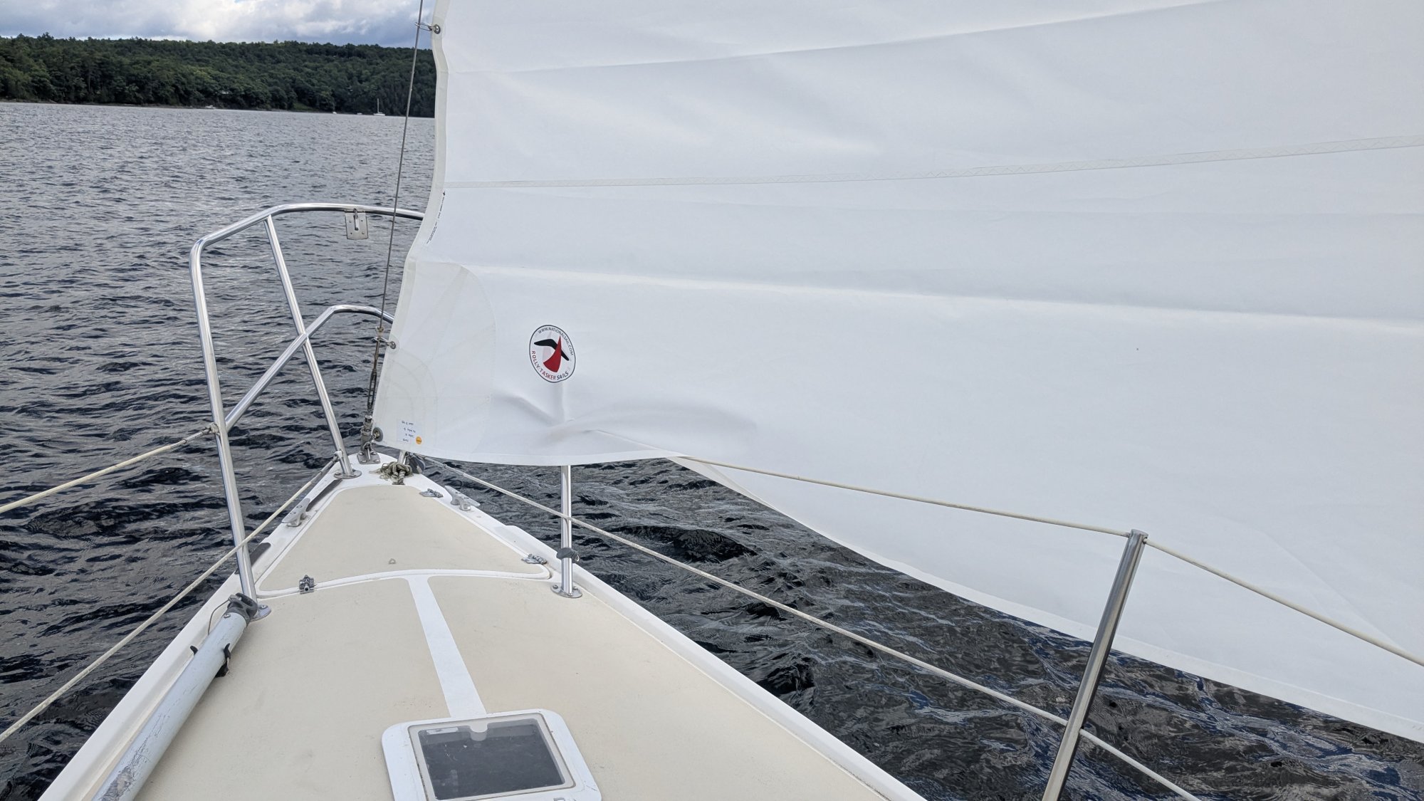

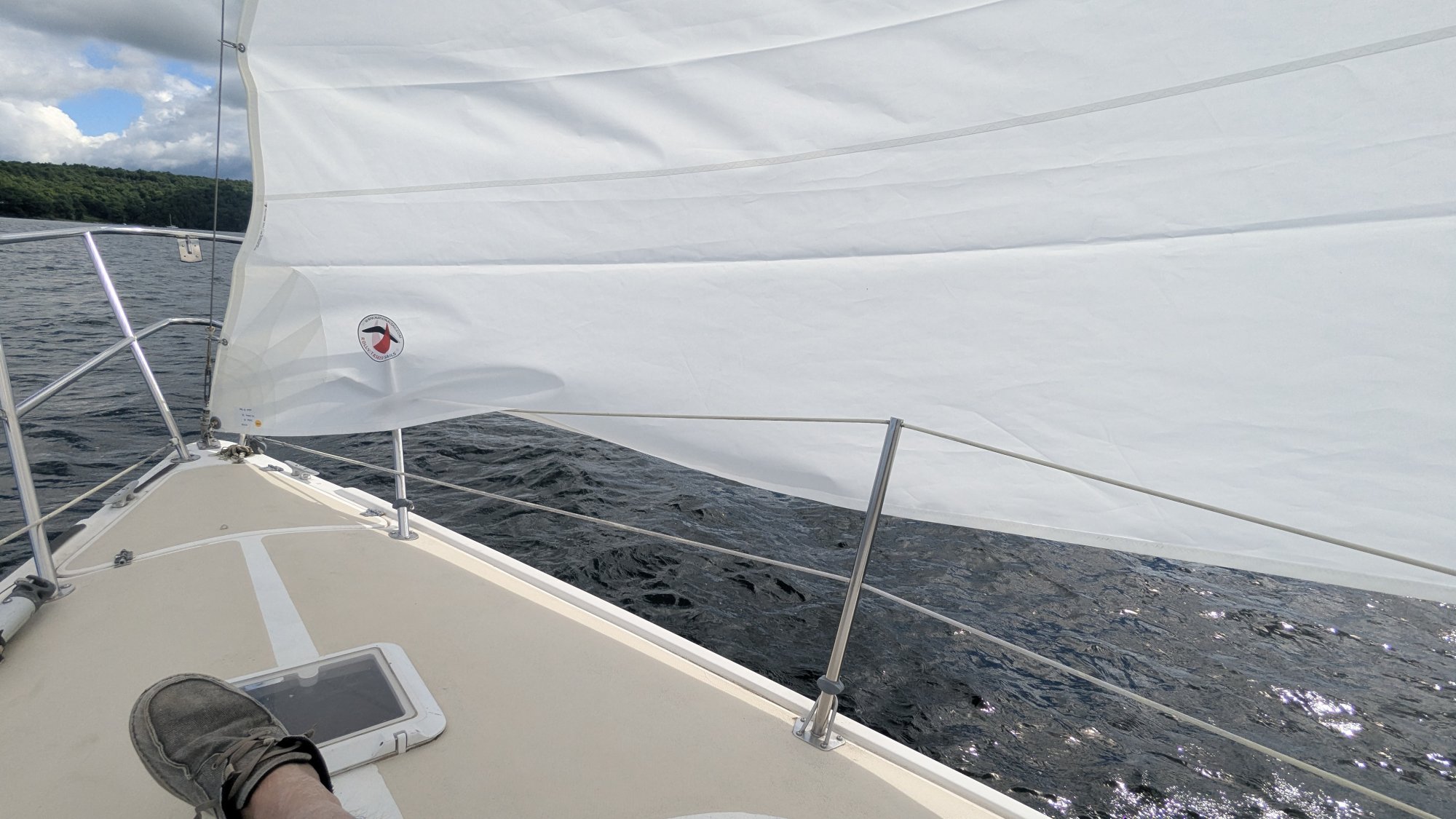

I bought a stock hankon headsail for a Catalina 27. I put it on for the first sail and it's hitting the bow pulpit and lifelines. Would adding a pendant and raising the tack off the deck help with this issue?

Unless it is not all the way pulled up to the top of the stay, it's a "deck sweeper", intended to be at deck level.
Likes: Timm R Oday25
23,455
What is the situation at the head of the sail? Photos? Of course you can add a pennant at the foot.
8,070
It looks to me like the sail needs halyard tension. Is the top of the at the sheave or stopper? If so, I think it may be too long.
Nevertheless it is a deck sweeper and interference with the pulpit or lifeline is normal. If I had a nickel for every jib I've seen with an imprint of a lifeline on it ...

When that sail is fully raised, it looks like it won't interfere with the lifeline anymore. Why isn't it fully raised?

It was fully raised. I wasn't sure if it's normal for a sail to rest against the lifelines like that. I guess it is.

To me, it looks like, when close hauled, the sail should be inside the lifelines when trimmed. That will give you the best performance when going into the wind. Of course, off the wind, it will have to drape over the lifelines as you ease it out. I assume you have genoa tracks on the deck inside the lifelines. If your boat does not have inboard tracks and there are tracks outside your lifelines, then either the sail has to be modified so the clew is higher and the sail is not a deck sweeper anymore, or you can add a pennant per your suggestion. Your photo shows that the luff of the sail has not been raised the full extent. If the head of the sail is topping off at the top, then the leading edge of the sail is too long and needs to go back to the sailmaker for a proper fit (to shorten the luff). If you just don't have the sail hoisted to its full extent when you took the photo, then that is what we are seeing. Personally I would not put a pennant at the tack if there are inboard genoa tracks.

The foot of most general purpose jibs is below the lifeline at the tack. This allows for a larger sail and more power. Some sailors have the sail cut with a higher foot, mostly for visibility or for use as a storm jib.

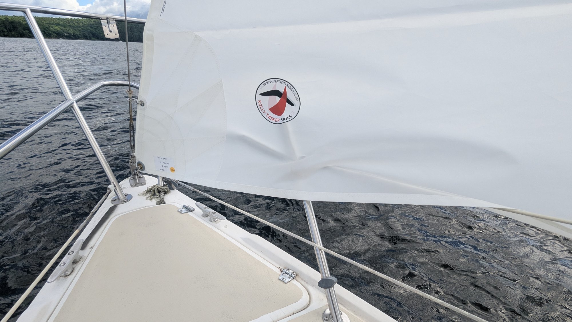

Your sail is not set correctly or it is too large for your boat. The luff should not have deep scallops in it. The luff should be fairly taut. Make certain you have the sail fully hoisted and post more photos of the sail and the top of the sail so we can see if the sail is fully hoisted.

Thanks. These were sloppy photos. It was pretty windy out there today and and I was getting tossed around a bit when I took them. I'll take more/better photos and post them. Thanks to everyone for the help.

With the scalloped luff you boat will not point as a masthead rig should. Masthead jibs really like a nice clean entry to perform well. In light wind some speed wrinkles are OK but not scallops.
In addition, if you can’t tighten the luff you cannot move the draft forward which is generally good for upwind performance. I don’t want to get into the weeds but a draft forward shape is generally considered easier to helm and forgiving. A very flat entry points better but is twitchy. On Average a draft forward shape is desirable for recreational sailing. When I say draft forward I mean the deepest draft of the sail should be around 60% forward.

If I were you I'd contact Rolly Tasker and tell them your sail is too big. It doesn't fit... the vertical hoist is incorrect. Regardless of the pulpit rail's interference, the sail is NOT hoisted all the way. That is a big problem and you will have serious performance issues if not deat with. \
Before you call, measure your sail, Luff, Leech, Foot and LP (luff perpendicular). Go to the rolly tasker website and read everything in the "how to measure your boat for sail's" section. Get yourself educated on how sails are measure and constructed. Then take a few pictures showing the sail completely.
When you call, you must be ready to present your evidence. Rolly Tasker is the largest sailmaker in the world, based in Thailand, I believe, but they have reps in this country and you should be able to get adequate service... they may offer to re cut the sail or send you a new one. I would insist on having the recut sail or at least a new sail's dimensions verified.
Good Luck..... be firm... I think they will help you.
PS Looking at the website I notice they have a few additional boats associated with the Catalina 27's Standard/OEM jib.... this could be the root of the problem.
12,998
I think we need to see the top of the sail before we give that advice. We don't know how much room still remains before the sheave.
