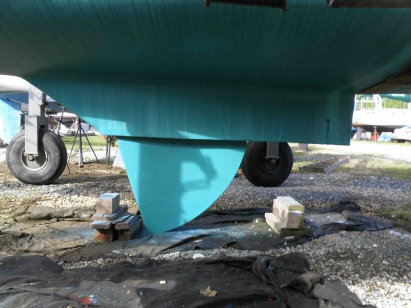

This is what a keel/centerboard looks like
If the boats lateral resistance and ballast is in the moving appendage then it is a swing keel boat.
