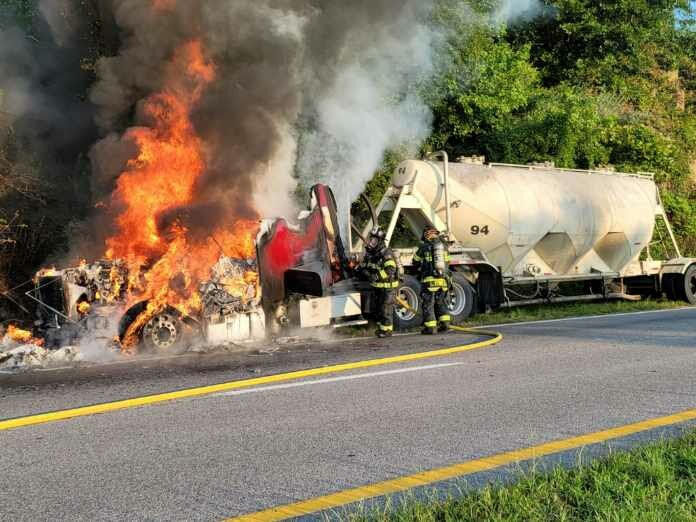

I've personally seen a number of diesel trucks burn to the frame in minutes, before the fire department could do anything. At least one fire started while we were sitting around after work, after the truck have been off for an hour. A battery cable chafed near the fuel line, started sparking, melted through the DOT-rated fuel line, and up she went in minutes.
It's not going to explode. It burns very nicely.

I'm surprised. You can throw a lit match into a bucket of diesel and the match will simply go out. I'd like to understand exactly how that truck went up. Maybe the fuel was very hot?

Actually, it is reasonably common.
Soak some into a rag and light that. For example, if the fuel gets in insulation or over some wires, it will go like crazy. It just needs something, anything, to make a wick so it can start. And after just a few minutes of burning, there will be plenty of heat and vapor.
