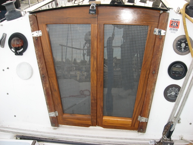

thanks...yes i do if you go to Zarcor site and read there measuring instructions and also watch there video on instillation it will be come very clear how to make them (that cuts out a lot of self engineering on your part)...i will say this there are a lot of variables in making a trapezoid shape so go slow and double check twice before you cut anything or you will waste material and at 20 bucks a board ft that gets tough ...also make sure you have sharp router bits and saw blades as teak is very hard on tools don't know weather it is the pepper smell :D or silica content but it is hard on them
Yep, I did my own engineering and messed up. The opening on our boat isn't symmetrical.
I managed to save it with some scrap teak, but I didn't know about any video. Here is a pic:
I think in Japan when a craftsman makes a perfect item they always create some kind of flaw.... they say there is no perfect anything
