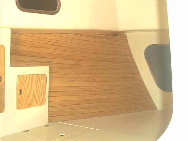

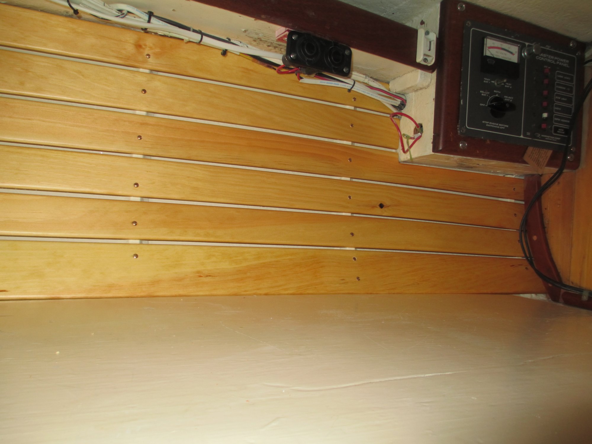

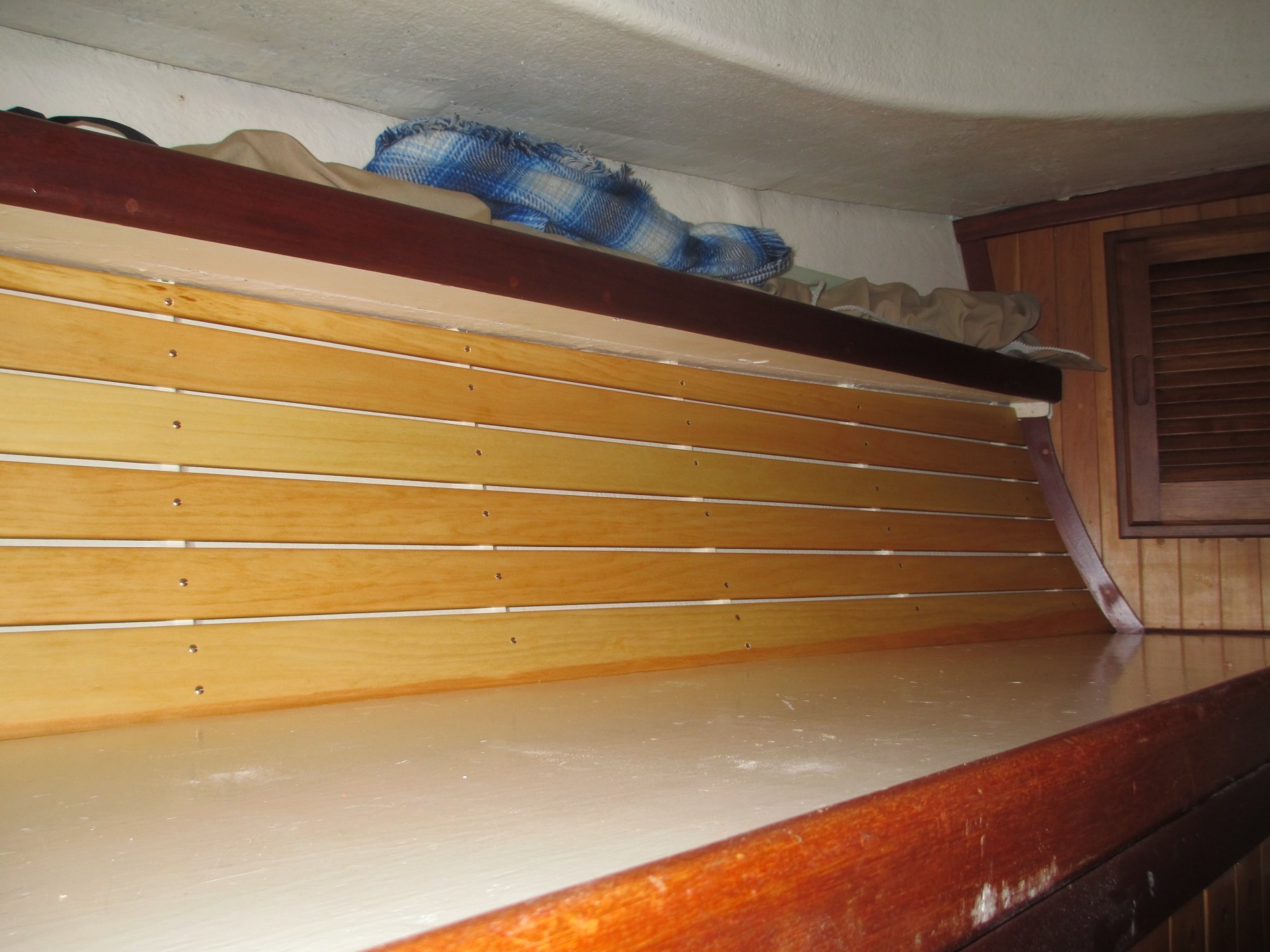

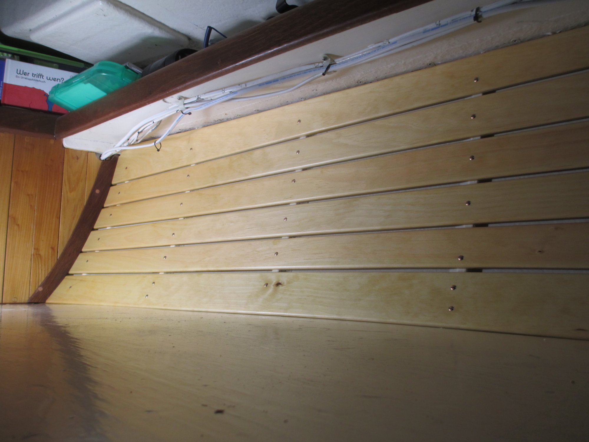

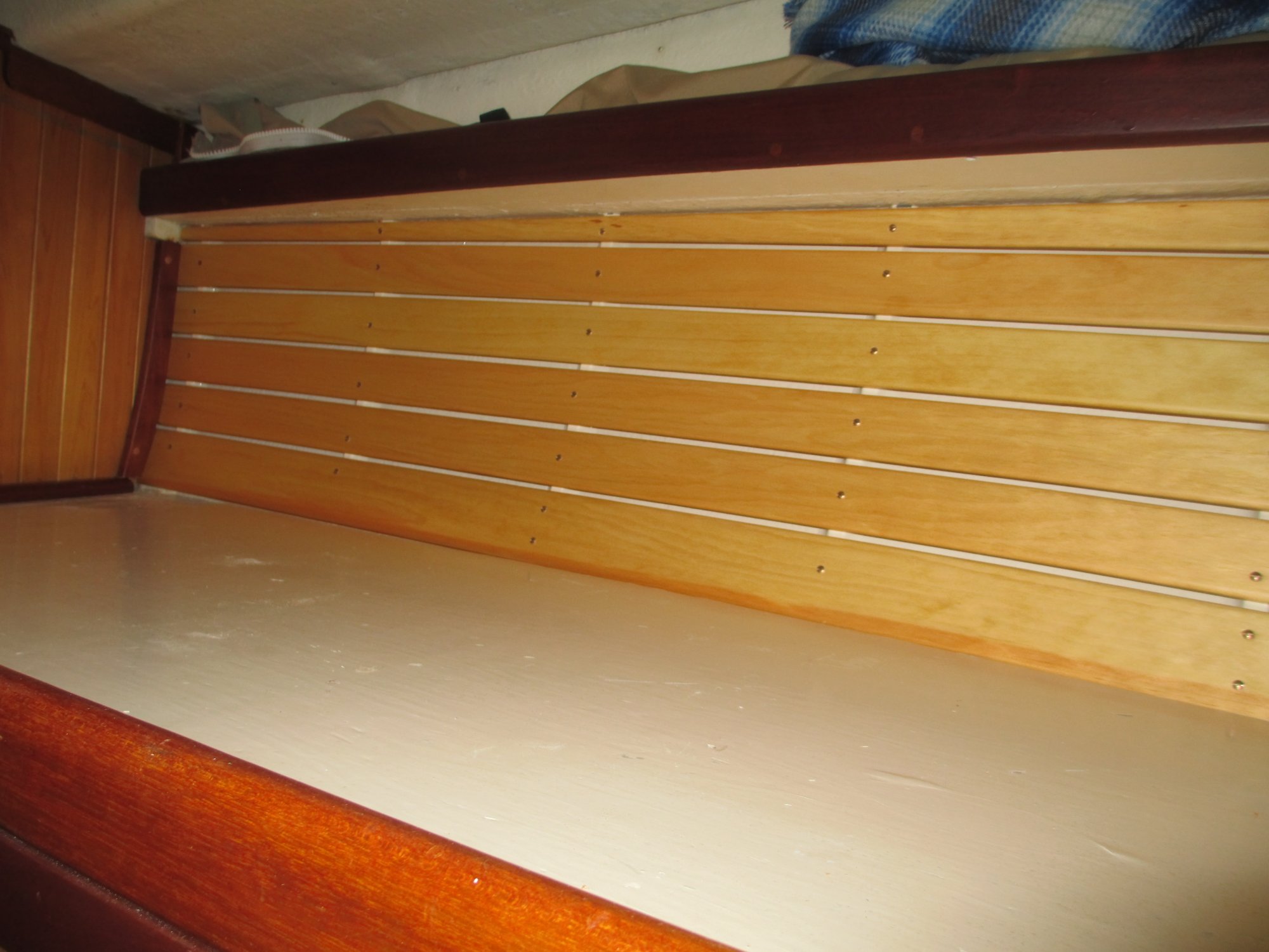

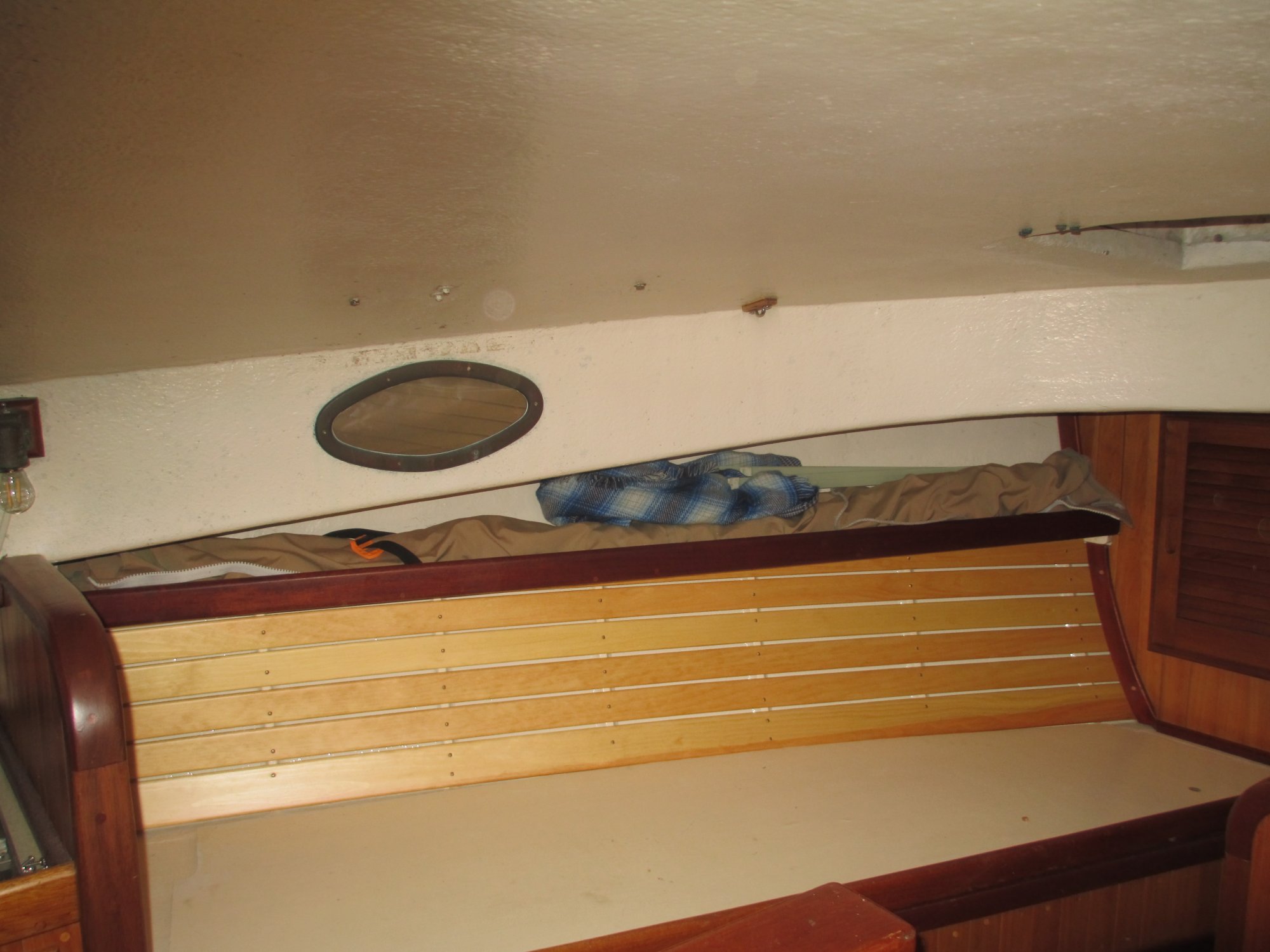

Not the underside of a roof, but the slats along the inside of the hull. I had this done by the wood guru at my yard (I’ve got 3 kids and a job so no way I could take this on).
Stripped interior gel coat where stringers would attach, bonded with 5200, then fully glassed in stringers. White pine planks with epifane rub looked varnish, bronze screws countersunk so they are flush. Went with the pine as my boat already had a fair amount of darker teak inside, want to keep it light and makes a nice contrast I think.
