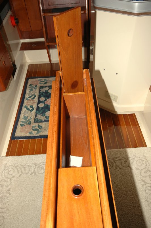

I'd point out that if you're going to do the in-table storage compartment ala MaineSail, that you can make the insert serve several purposes. On my friend's boat, we drilled holes that allowed the insert to be flipped over and used to hold the condiment shakers and cups in the center of the table when we were eating.. Flip it back over to have a flush table insert. :)
