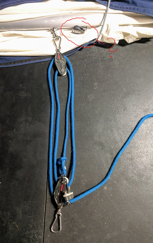

These are guarantied to be stupid questions, but I'm a 1st time sailboat owner with no IRL people to ask.. I believe I figured it out, but wanted to see if I'm making some mistakes in how I set up the mainsheet on my recently acquired boat. I got it on the water, but not been able to raise the sails yet. Possibly this weekend. There's been a myriad of little things I've fixed that it didn't quite seem like the PO knew what he was doing (and if I notice you know it's stupid..).
The boat has mid-ish boom sheeting. And there is a U-shaped ring (forget the name) near the mast, I assume for vang attachment?

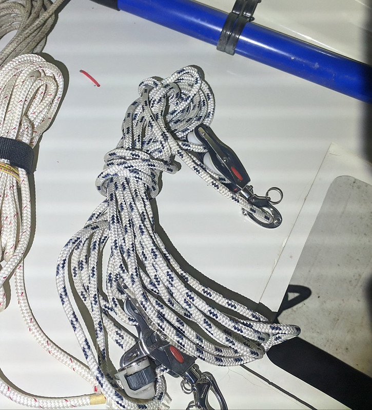

- It came with two sets of lines/blocks things. So I'm thinking sheet, and boom vang. Does it matter which is what? See photos. It does look like solid blue was used as mainsheet. The other was buried under a bench, unfortunately don't have a better photo.
- Solid blue is attached with carabiners. Works, but doesn't seem quite right to me.. Should I replace with shackles, or does it not matter? (Had a "WTF?!" when I saw the price of snap shackles..) The other at least came with shackles
- There's a block on the boom, just aft of the mainsheet attachment point. Seen in the photo of solid blue. Any idea what this could be for? I'll have to investigate this further once i get the sail set up.
It looks like both are 4:1 with similar sized blocks, so the only difference would be the length of the line. You'll probably want the longer line for the sheet so that you don't run out when going down wind.
Those carabineers don't look good to me. I don't know what load they're rated at but I'd be concerned using them with 4:1 blocks that could generate a good amount of force. I'll defer to other trailer sailors on what works best for rigs that get removed and reinstalled frequently, but I'm guessing that's not it. Something that looks like that from Home Depot advertises a working load limit of 280 lbs, which doesn't sound adequate for a 4:1 block.

Ok I'll give this one a shot as I am a long time trailer sailer. The answer to your question is yes the 2 block and tackles are the vang and Mainsheet most likely. The set with the snap shackles should be the main sheet and the other the vang however check the length as the vang is likely much shorter. Snap shackles are $$ but you can buy cheaper ones at a horse tack shop or Amazon. There made in China and cheap so don't use them on critical things but a vang is a good place as if it come apart the mainsheet will certainly protect it from hurting anyone. Another good place for a cheap one is the Topping life (heck you could use the carabiners). I would though remove the carb beers and not use them on the blocks since there not the locking kind. If you do want carabiners inplace of snap shackles go to REI and get some good quality rock climbing ones. I have a hand full of them I used to climb with that have a 5K lbs working load and a breaking strength of 25K lbs. I have even used my old ones to pull cars out of the ditch in the snow. People always laugh when I pull them out but hey there rated for it! They all have double locks on them though and you cannot buy them at the local hardware store.
As to the attachment point I may be mistaken but the track in the boom should be for your sail. Likely the block (picture with blue line and ? in it) is the outhaul for the foot of the sail and a line should attach to that swivel which appears to be on a slide. I am sure once you put up the sails everything will make since.
Thanks. Length of line is a good point. They both appear to be more than long enough, but I'll certainly uncoil and compare. The blue one is also pretty ratty looking so wouldn't mind switching.. I have the boat in a marina so don't need to take the sheet on/off all the time, but since it's right in front of the companionway it would be handy to be able to detach it and get out of the way when not underway. I'll use the snap shackles I have and maybe get some cheaper ones for the vang. The carabiners don't seem adequate. At least they're not rusted I guess.
And not to be vain, but the carabiners also look ghetto and out of place :) A theme with getting this boat ready is my constant annoyance that people don't spend and extra 5% effort to do things right, rather than half-assed:banghead:(really the same is true for my house as well).
