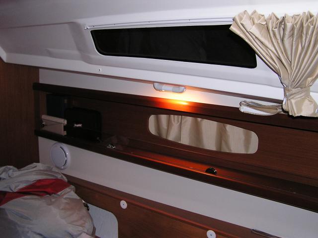

Nice. What hardware did you use. Am I seeing correctly that the guides cover the holes from the old fiddle?
Feb 21, 2010
353
Beneteau 31 016 St-Lawrence river
No, I will have to plug the old holes with some coloured wood paste & sand to perfection or as close to that as I can. The old holes were too far inboard; Since I was fastening from the top it was easy to go closer to the edge. Also the end-pieces are on the edge of the vertical ends to the shelf. I used a bracket as shown on this link. http://www.buyrailings.com/pd-productid-1990-sku-2884ZN5-ref-NXTAG.htm the size wasn't perfect so I used a little foam tape on the inside of the bracket. In the forepeak I did a paper template of the shelf and curved the plexiglass sheet to follow the outline of that shelf using a heat-gun but watching that the lexan didn't bubble.
I had bought more lexan than needed but finally it didn't bubble and all is safe...
The pieces are 3in. high and the thickness is 6mm or about ¼in. It is easy to cut the lexan with a good table saw so buying a piece 1' X 8' and cutting it to size was the best way to go.
