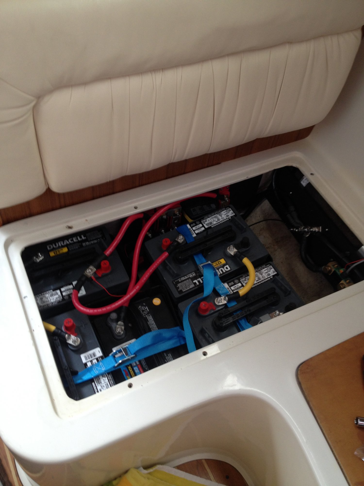

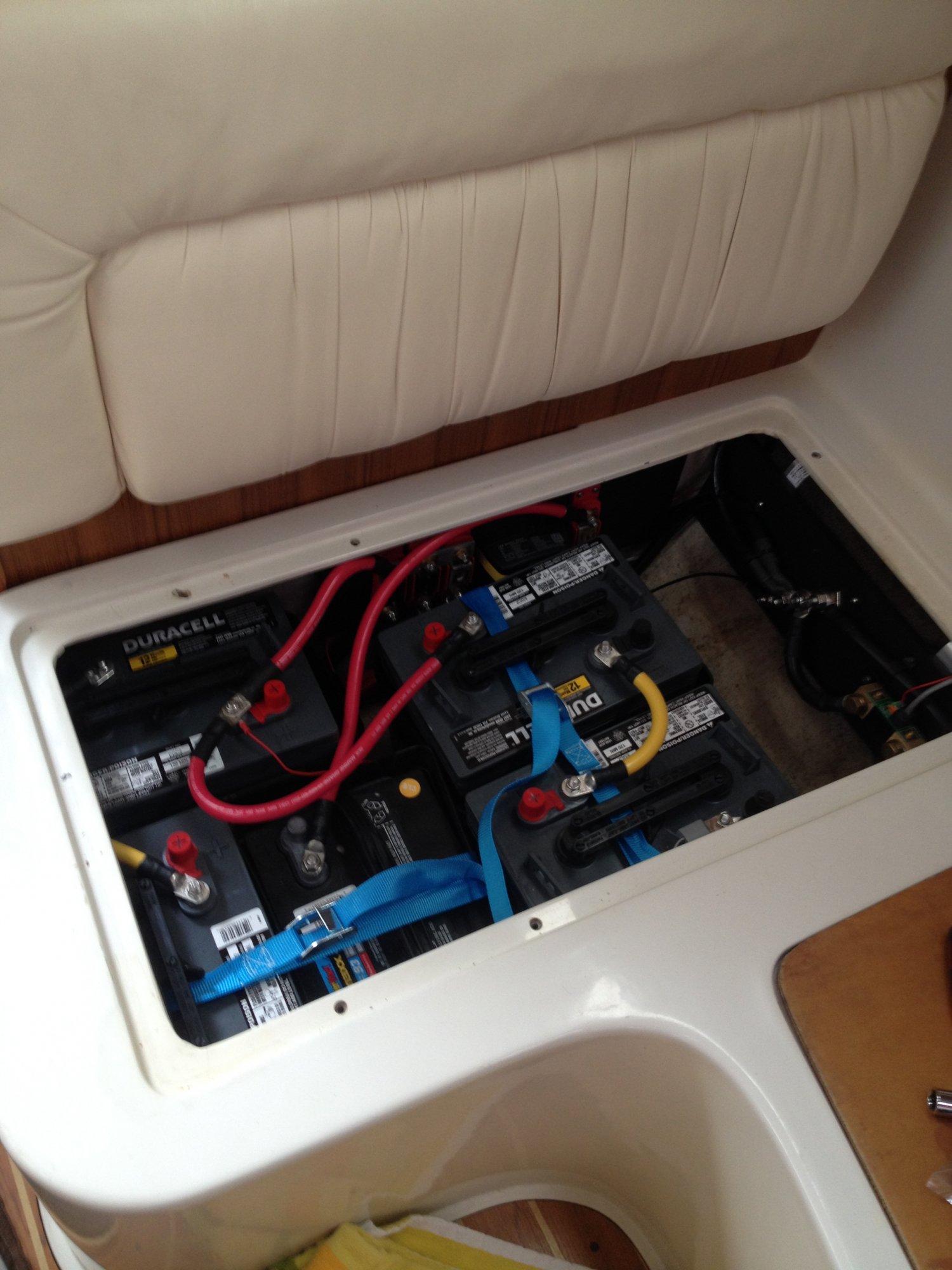

With the 310 I don't see a way that you could totally vent it external, you would have to have a sealed compartment for the batteries and a vent external. I do not see that this is an issue in my opinion. I am not an expert on battery gassing, but if this was an issue I am sure Catalina would have looked into it. In all of my sailing I have seen many battery setups and have not heard of an issue with this. This is only my opinion.Tom J: What did you mean? Into the cockpit lockers? Are they vented?

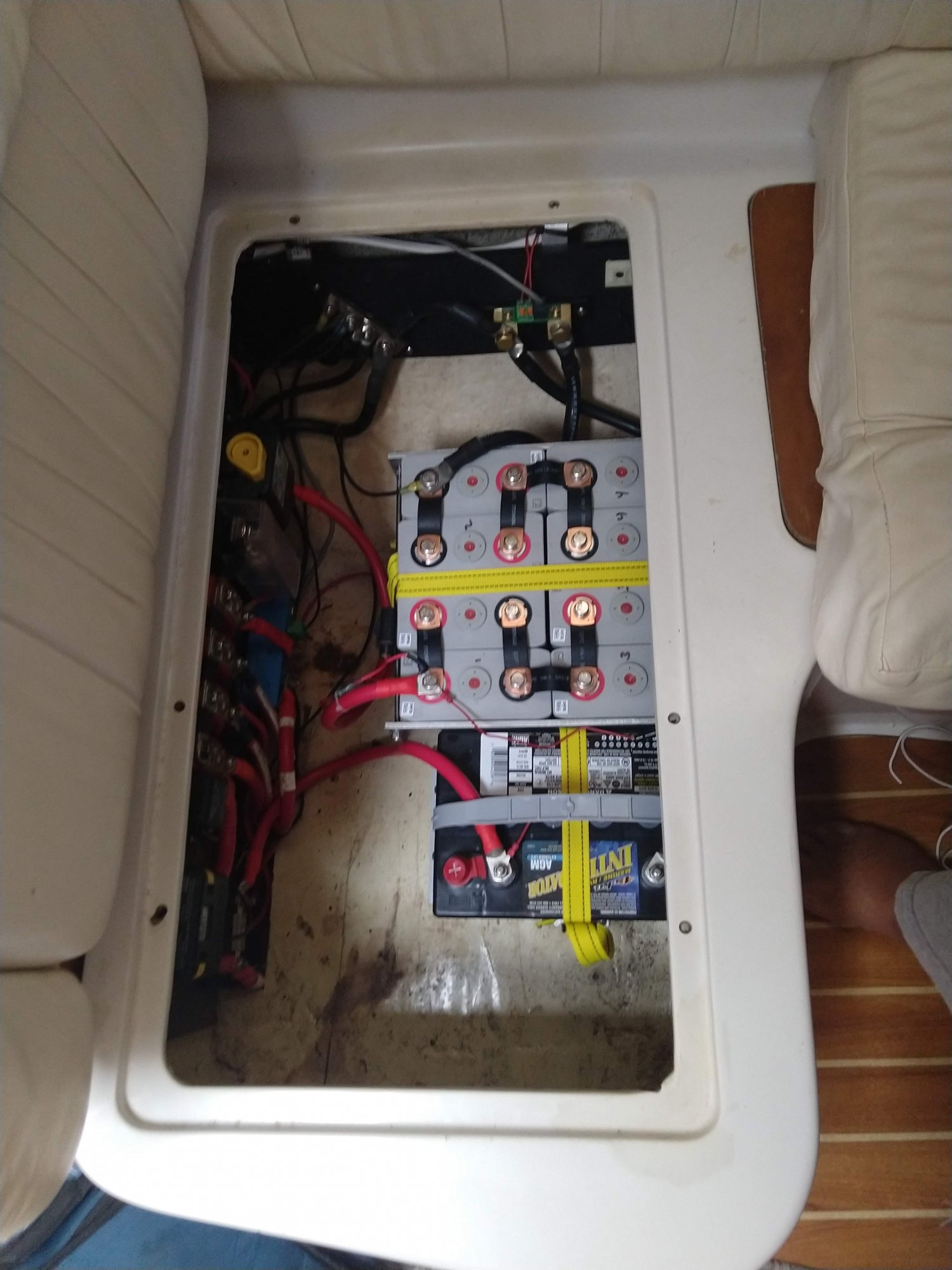

The battery compartment on the C310 is not sealed. The aft end of the compartment is open to the bilge and the area under the saloon and aft cabin. Very convenient for running wires to and from the batteries.Tom J: What did you mean? Into the cockpit lockers? Are they vented?

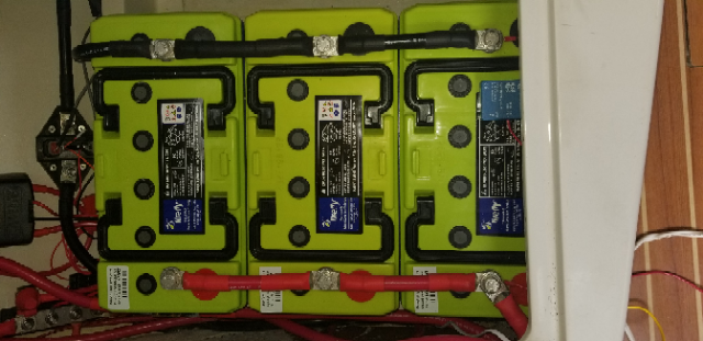

this is exactly the system i want to build out.. since lifep04 is happiest between 20% and 80% charged you get a solid 160AH out of that setup and it should last for 1000's of cycles at that rate.. What charger are you using?I was able to get four GC2 and a group 24 deep cycle installed in the compartment. However to do this I removed the fiberglass tray the factory installed. I then used separate, dedicated battery boxes for each battery. I trimmed down the boxes, removing handles and anything else not necessary to get them to fit. It did take violating Mainesail's guidance on orientation for two batteries. I did this with the two closest to the centerline, one was the group 24. I never had any spillage or issues.
I also for a battery watering system because some of the vents were partially covered. I checked the water levels weekly.
I installed the batteries in April of 2014. We started cruising in September of 2015. For the from 2015 to December of 2017 we didn't have enough solar and abused the batteries. We also did not have a suite case generator most of that time. So we lived between 85-50% for over 2 years. With that they lasted 5 years.

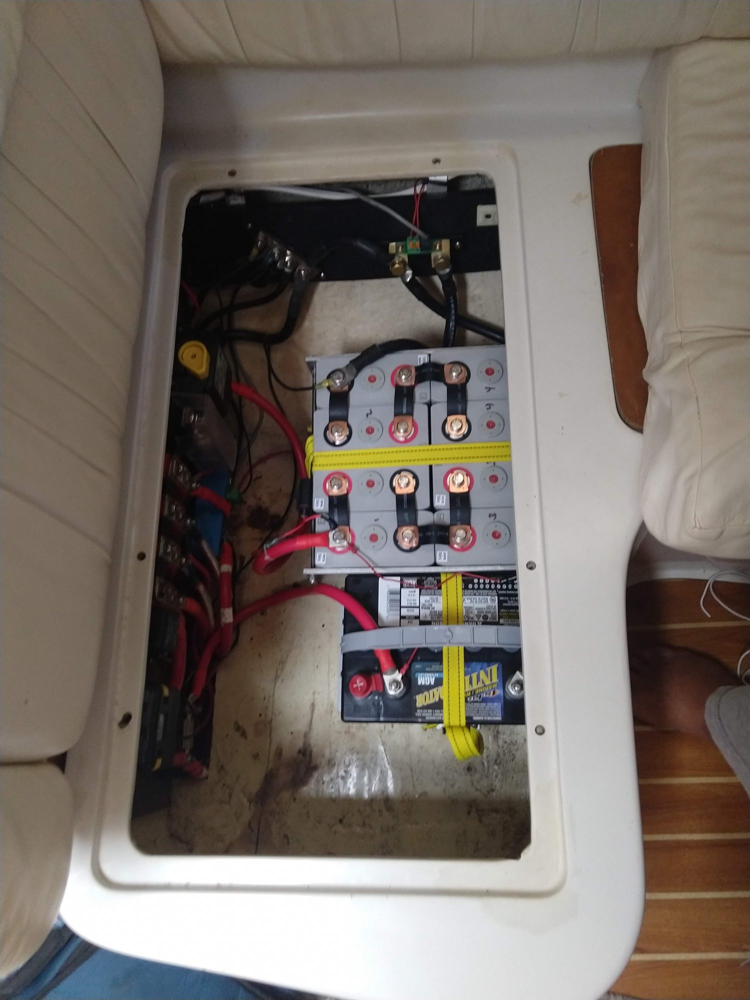

This is my new system. I have 200 Ah usable of LiFePO4 batteries from CALB cells. I love the new system and I am extremely happy with it. But I am hesitant to write it up. Lithium DIY is not for everyone and I don't want to give the impression it's easy or cheap. Anyone who is interested should read Mainesail's article on the technology until it makes sense. Let me know if you get there because I will probably have some questions.
Good luck and fair winds.

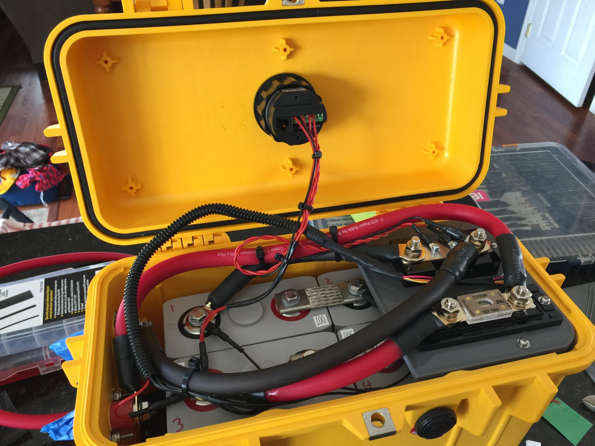

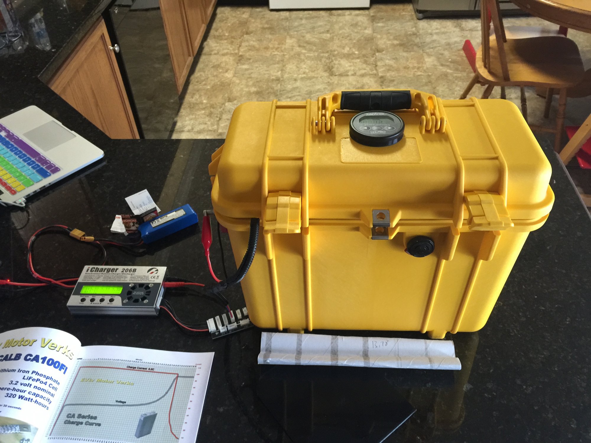

I'm well acquainted with LifeP04 batteries... a couple years back i built a travel pack which i speced to be able to run at 200Amps so i could run a 2000Watt inverter to power anything i needed while at the boat yard or on the hook somewhere. Here are a few pics of the case.. Like you, i didn't have a BMS back then due to cost and their inability to do anything over 20amps back then.. i do see a number of new systems out there that can handle 100+amps now.. i was able to run the AirCon on board for 2 hours off this pack before the alarm sounded on it..
unfortunately we moved last year and the pack sat in storage for too long which allowed the voltage to drop too low on the pack and now the Cells are no good.. Expensive mistake.
I used this for everything.. from powering a trolling motor for the dingy, to the AC on board, running tools in the boat yard, as emergency power during power outtages at the house during storms to keep the sump pump and fridge going..

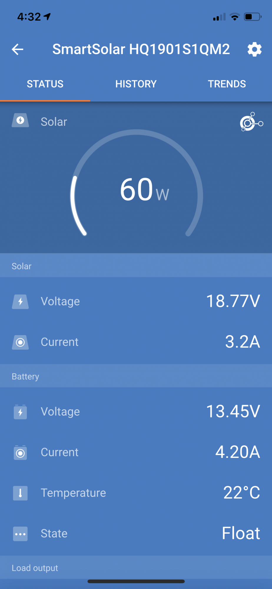

Thanks Jesse for the info. I had heard about the Balmar but wanted to only deal with one App etc. I didn't know there was a bluetooth version. Do you know if the Victron app can accept the info? I'll look into it. Thanks. Your Posts and blog have been a great help. BradThe info from the Victron app for the solar controller will be limited to voltage and time spent in bulk, absorption and float. So it's not the same as battery monitor that has been properly configured.
On the Victron Battery Sense, there are two models, a blue one and a black one. Go for the blue one. The black one is very limited in range.

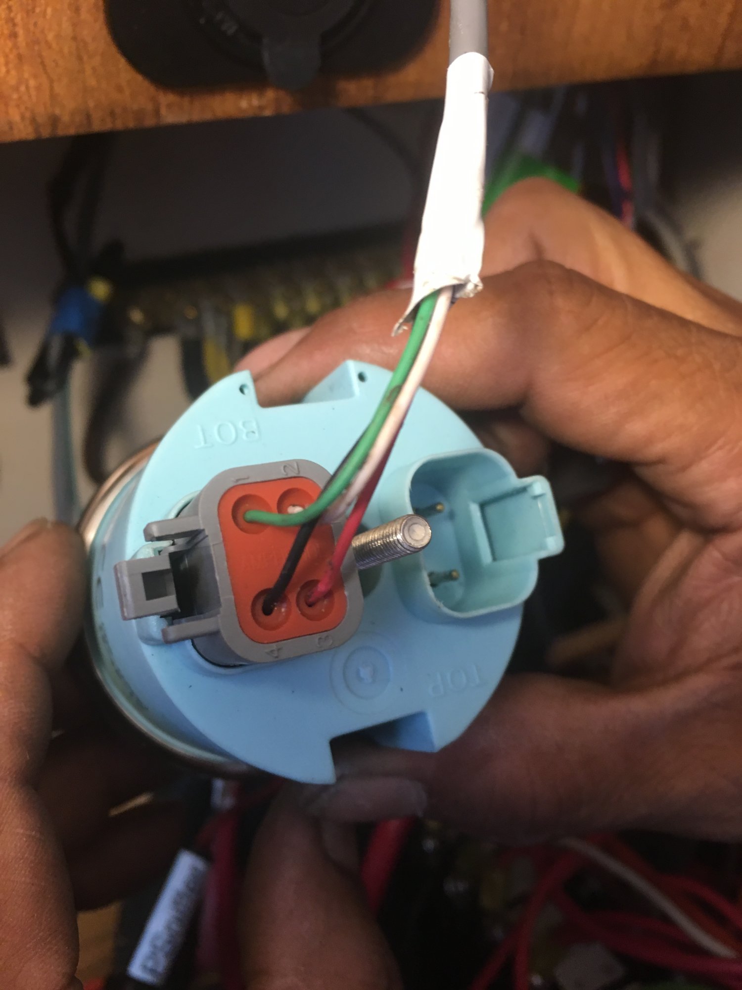

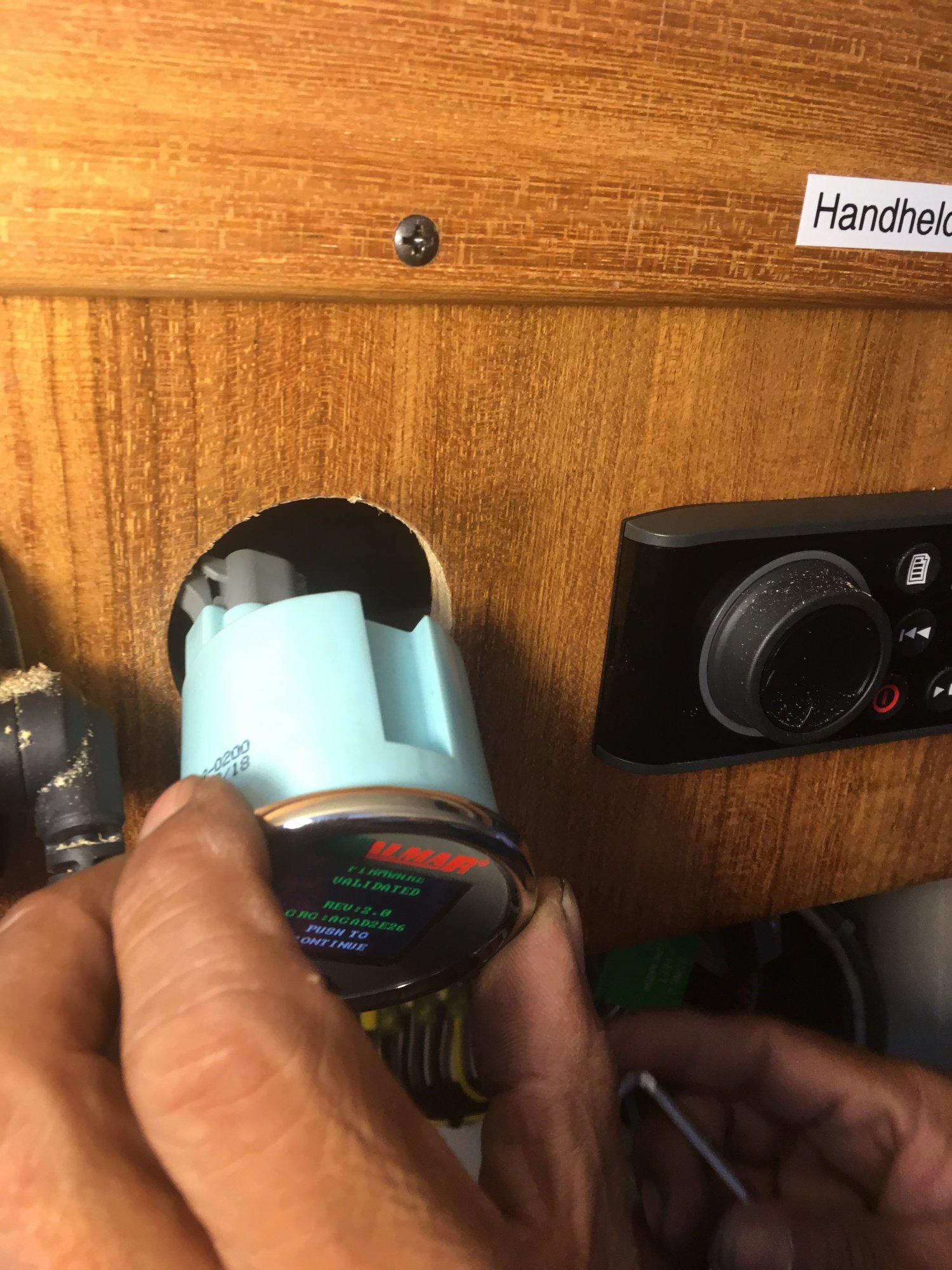

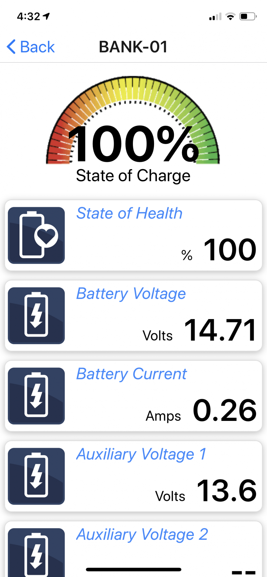

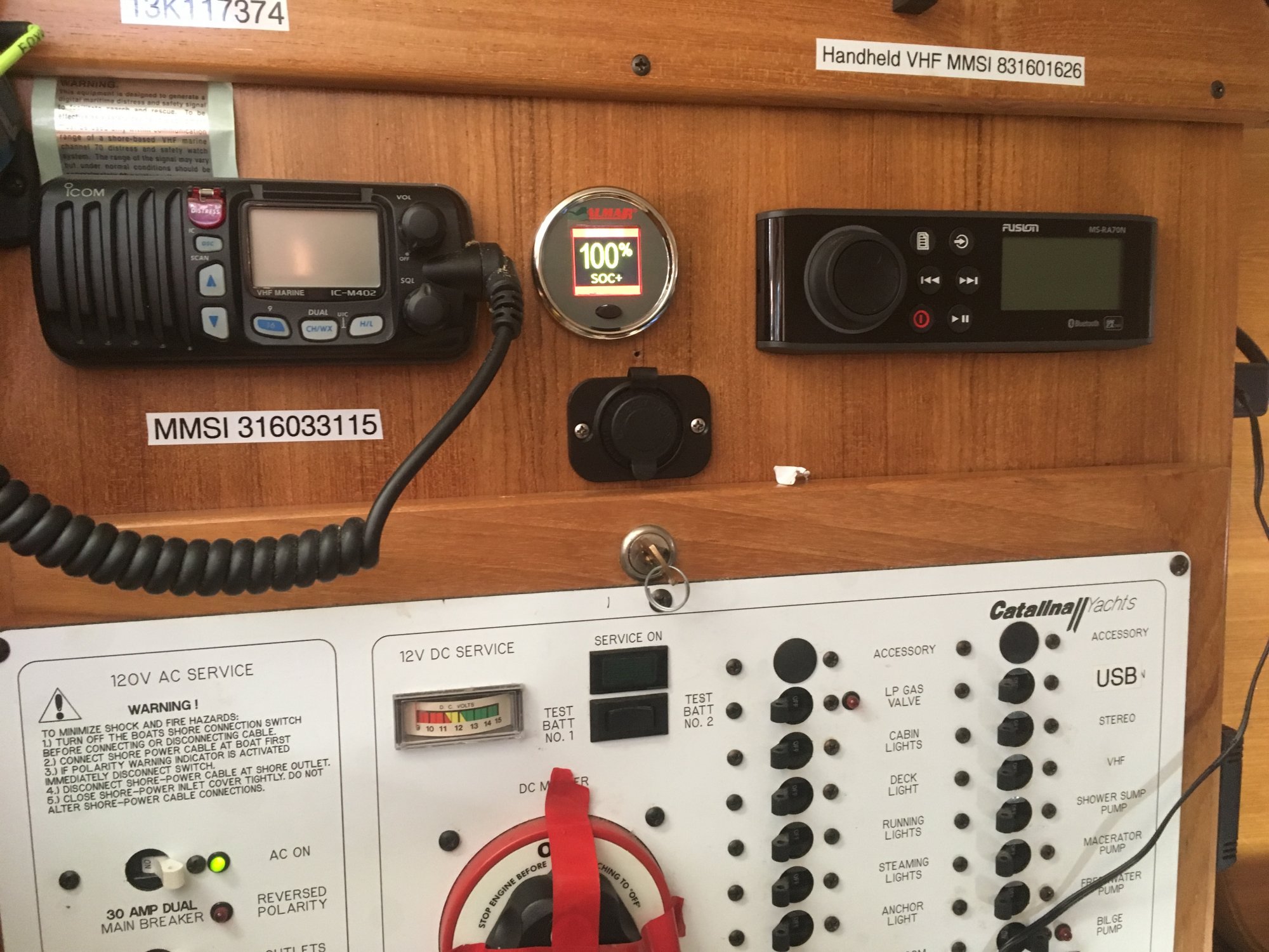

I recently had the Balmar battery monitor SG2000 (the one Jesse mentioned) installed. The SOH or state of health is pretty nice and much more relevant information. There's a blue tooth add on which you can buy separately that plugs easily into the back of the SG2000, that relays the information to your free Balamar app on your phone.The info from the Victron app for the solar controller will be limited to voltage and time spent in bulk, absorption and float. So it's not the same as battery monitor that has been properly configured.
If I were buying today, I would go with the new Balmar battery monitor. In addition to the standard info like Amp hours, watt hours, time remaining, etc. it has a state of health function that is pretty unique. They have a Bluetooth model.
