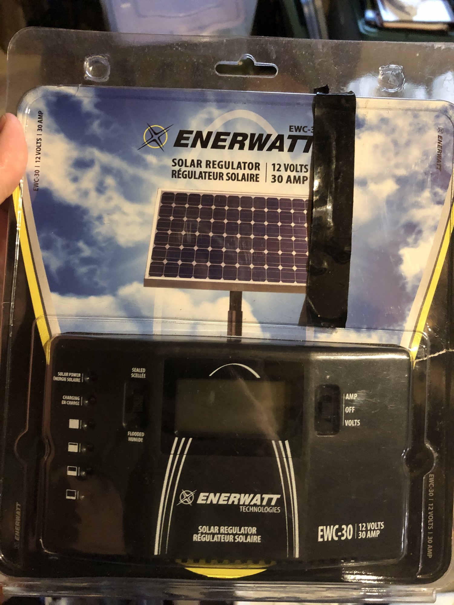

Our concern with off gassing stems from our existing set up which is constantly setting off our CO detectors on hot days when we aren't at the boat. The 2xFLA GC2s are 5 yrs old.
If they are doing this, something is wrong with the PV controller or the batteries. What model PV controller..?
Thanks for the reply. Its an Enerwatt EWC30. Ive attached a pic of the spare the PO included.

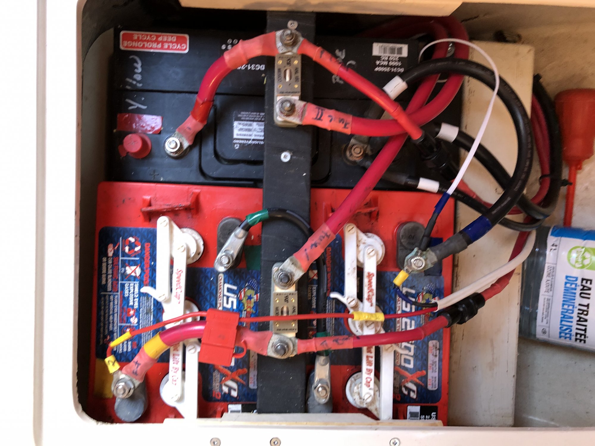

I thought I would help clarify the discussion with a picture of the existing installation. Note the orientation of the GC2s is in the wrong direction and the group 31 is maintenance free vice FLA. The red GC2s are forward port side.
