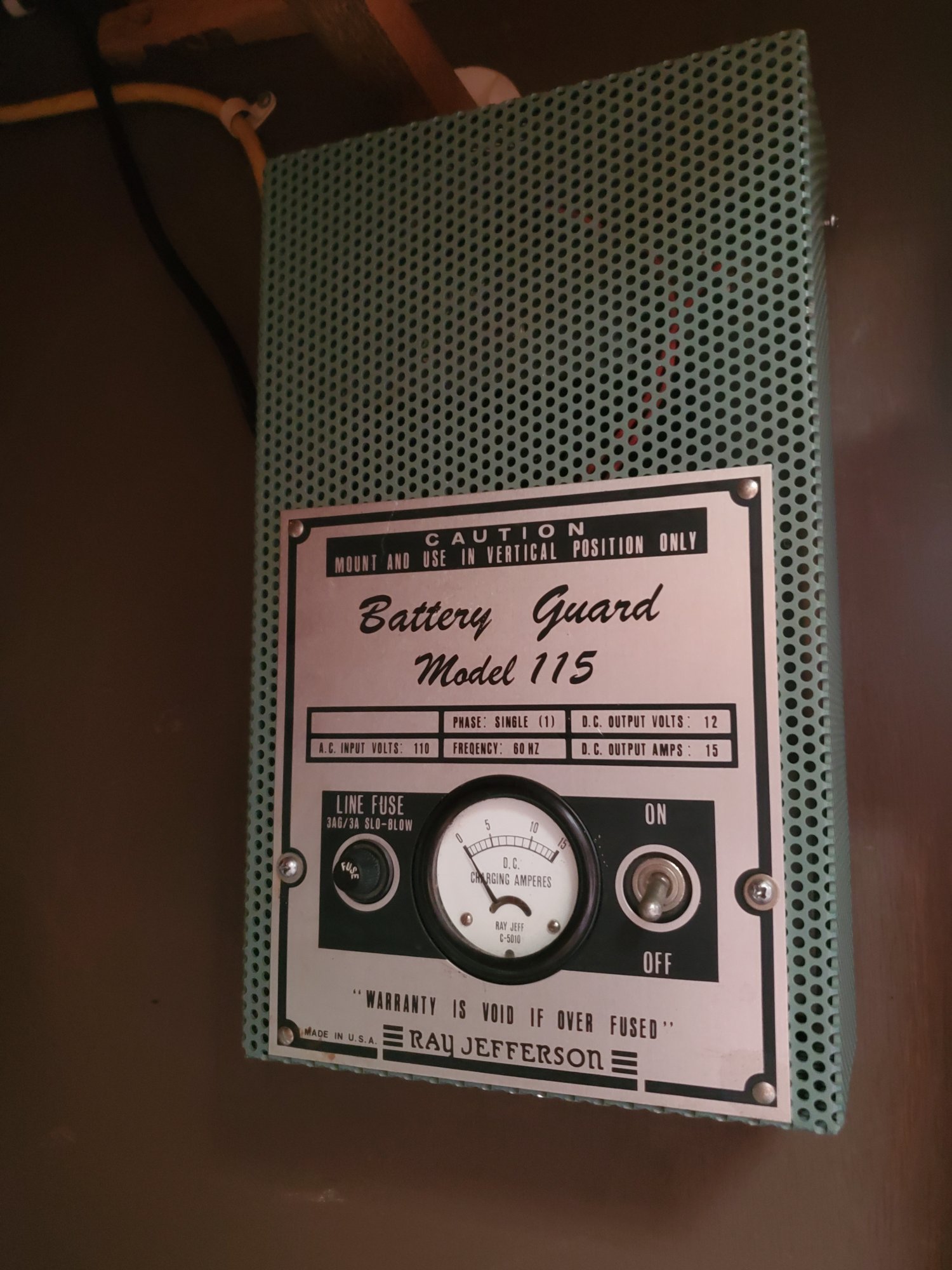

I know, this has been gone over many times and I've read Main Sail's deep cycle battery page. But I'm going to ask anyway.
My new-to-me boat has what appears to be the original charger in it
As much as I appreciate antiquities (I have a cabinet full of vintage film cameras) I am sure I can find a piece of equipment that would be kinder and gentler on my batteries while bringing them back to full charge quicker. My local marine store only sells Xantrex which I've seen maligned on various boat forums. I have 250W solar so I don't need to rely heavily on shore power charging but I'd like to have a way to top up when at the dock.
I also need new batteries. I have one group 31 in one bank and two group 31 Crown 31DC130 in the other bank. One of the batteries in the two bank is completely shot and the other is the same vintage so probably on its way out. The single battery is getting old as well so will need to be replaced soon.
So, replacing charger and batteries, which way would you go? Flooded, AGM, Lithium, 6V, 12V??? I can probably find the height for a couple of GC2 but it will take some re-configuring. How about the charger, Sterling ProCharge, Xantrex, Marinco, Mastervolt, ProMariner? Not needing a lot of shore power charging, can I get away with a 20A charger if I go for 200~250 A-Hr per bank?

That charger is an antique. The Ray Jefferson brand is long gone and was never seen as a high quality brand, sort of an economy. They have now morphed into Ray Marine through various buy outs and near bankruptcies. Interesting information but adds little to your decision making except to convince you to place the charger on display alongside of those cameras. Becarefull when removing it, it will be heavy. Don't be surprised if it weighs in around 30lbs (14 kg).
The Sterling/Pronautic chargers are highly rated, have built in charging profiles for different battery chemistries and a custom profile. Binacle Marine in Halifax carries them. A 30 amp charger would be better for a 200-250 ah bank. Rule of thumb, 10% of the bank capacity plus some extra to run dc loads while charging. The cost difference between a 20 amp and 30 amp charger is not all that much.
