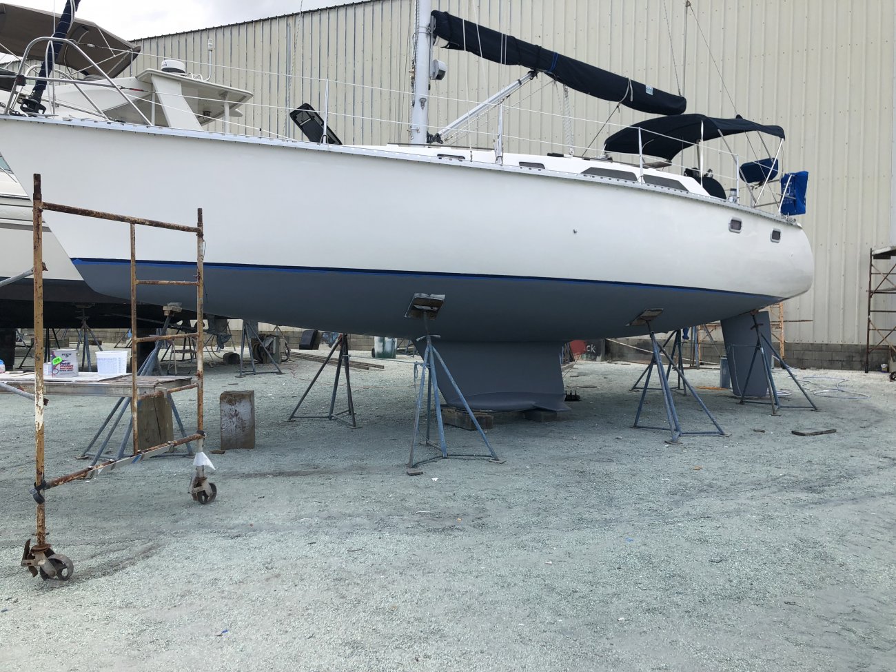

With just the pictures to look at, the hull looks like it needs paint removal and re-coat; I don't see blisters. The keel looks like it has cast iron rust blisters ; it could use barrier coat after a good cleanup..

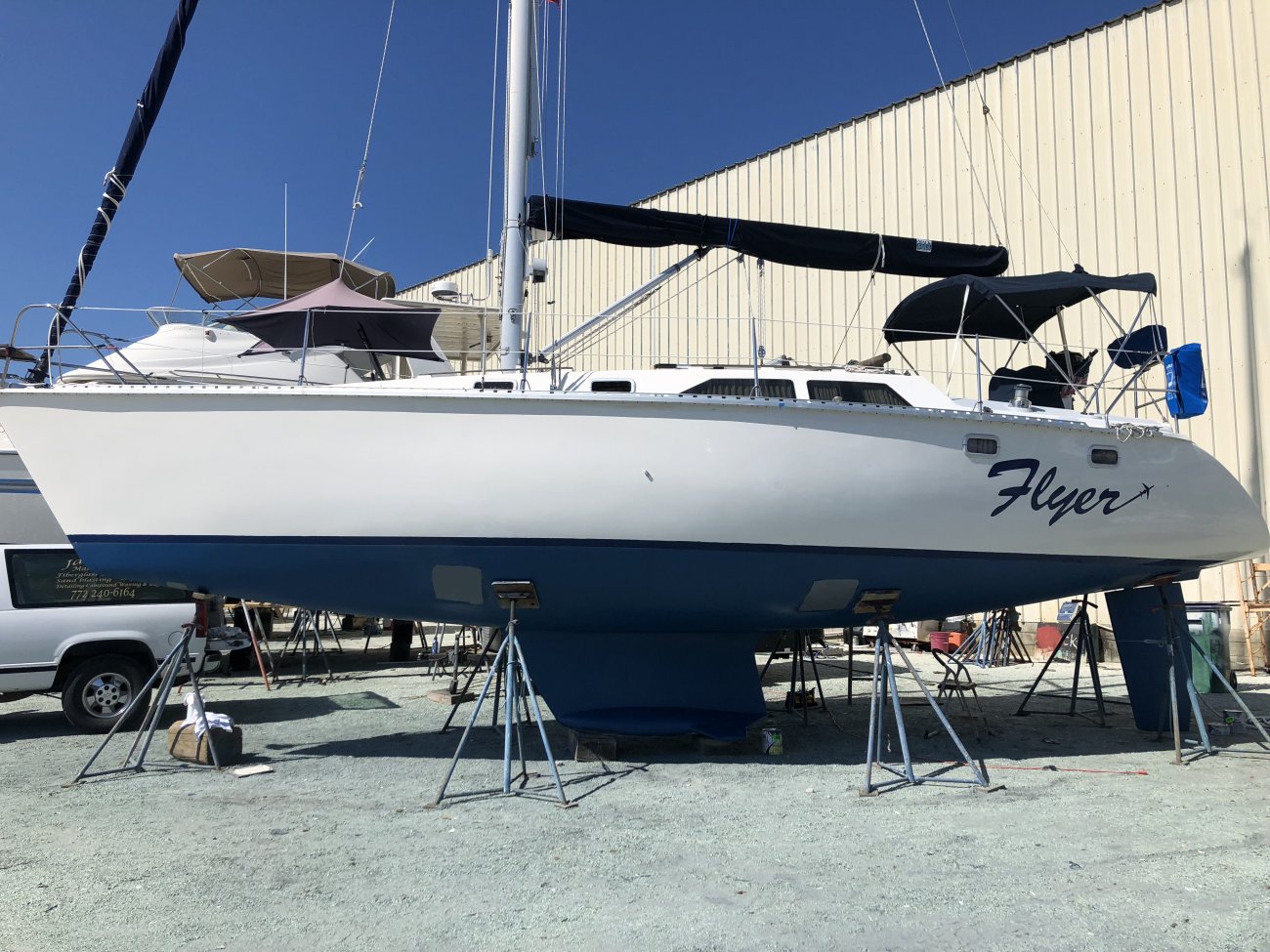

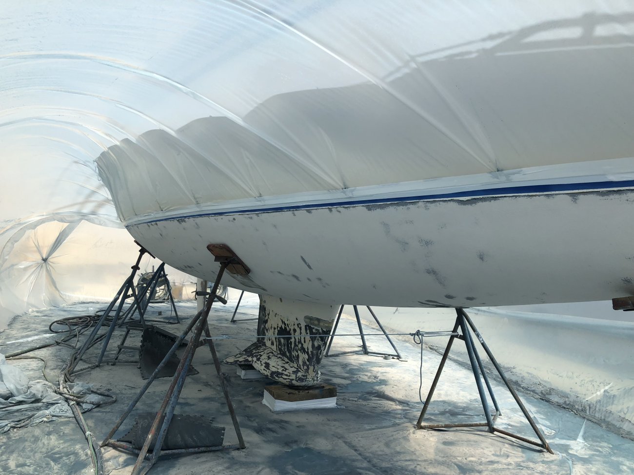

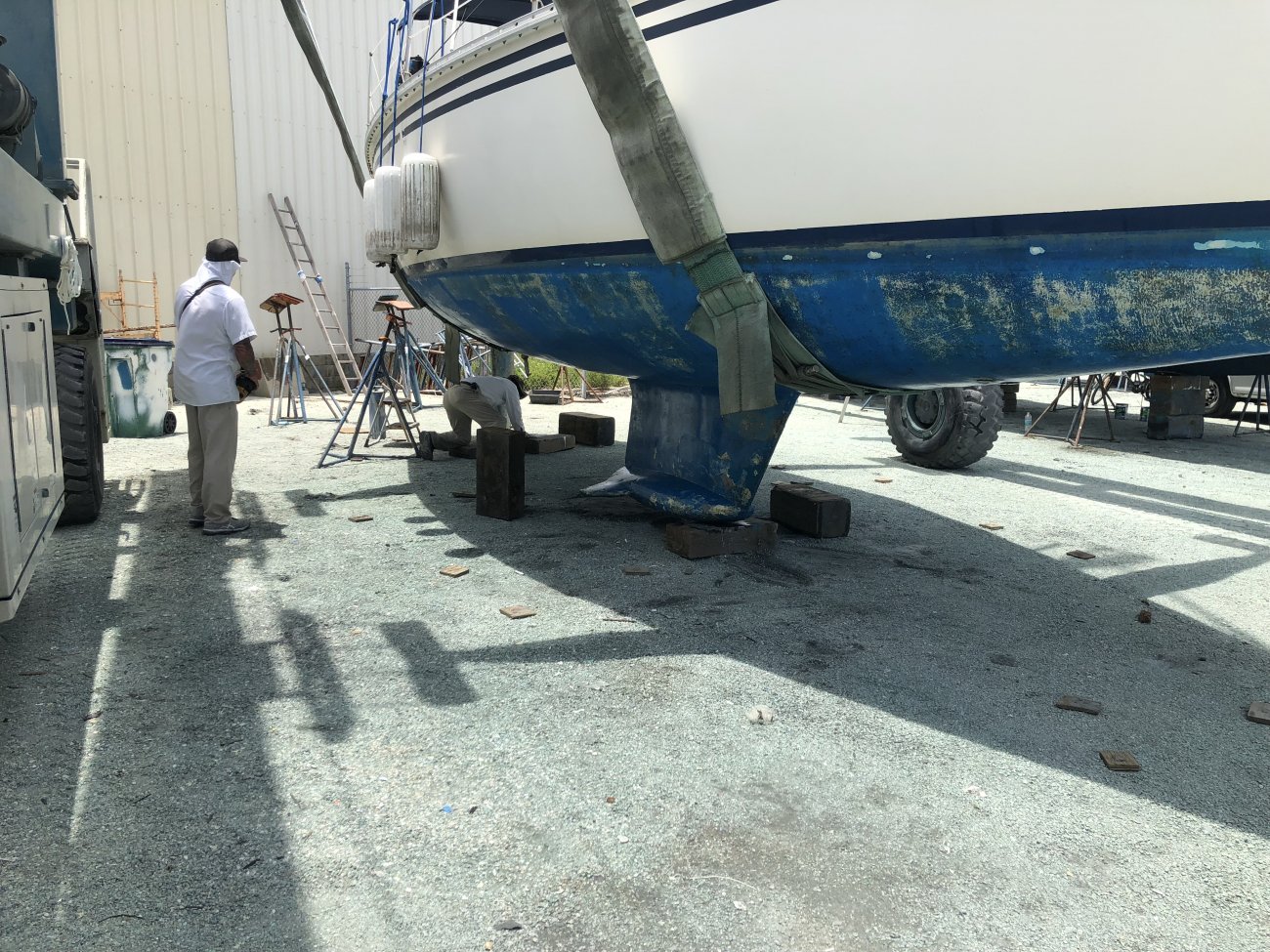

I had the bottom blasted and did a barrier coat last year. The bottom of my boat looked similar. I did some minor patch work on my keel. Did all the work myself. I didn’t want to wonder what the condition of the barrier coat was from the PO. I am keeping the boat for a while so I thought it was worth it. Barrier coat was gray and finished with a blue finish coat. I used Pettit Epoxy Barrier with Pettit SR-60 but I am in warm weather year round. Your mileage may vary. Good luck with your decisions.
