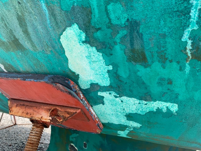

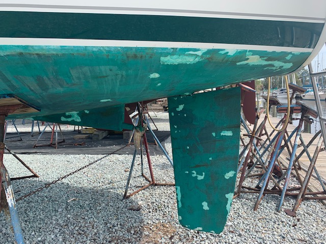

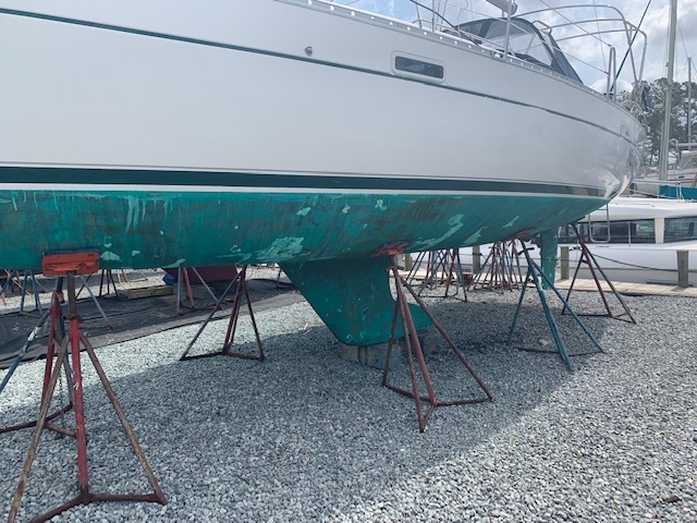

Beneteau 331 (2003) just hauled for annual maintenance including bottom paint. Yard says, "After looking over bottom, tech concluded current bottom paint is flaking off, recommendation remove remainder of bottom paint, apply 5 coats barrier coat and apply new bottom paint." Perhaps needless to say, very pricey. We're near Pamlico Sound and, in addition to annual bottom paint, diver visits 3-4 times per year. Is this a reasonable recommendation?

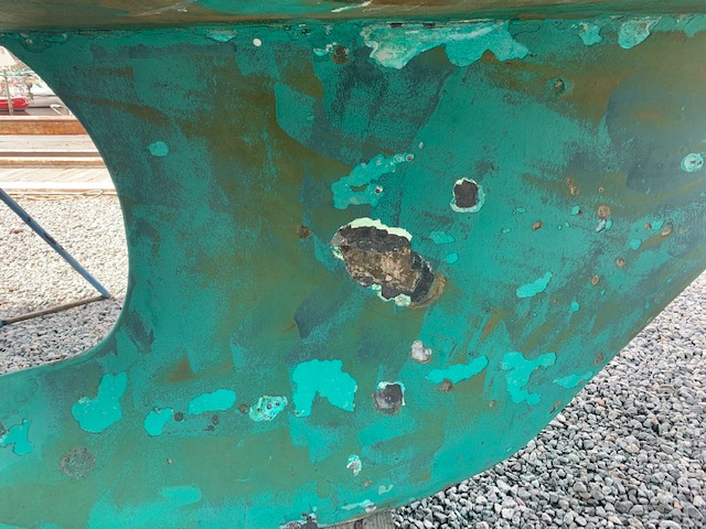

The spot on the keel looks like the barrier has failed. I believe most Beneteaus have a cast iron keel, if yours does, that spot is not going to get better it will corrode and the bottom paint and barrier coat will fail on the keel.
Minimally the keel should probably be stripped to bright metal, properly prepped and barrier coated. If it is a lead keel a spot repair is probably OK. If it is cast iron, it will be best to do the whole keel.

Yep Refish, it is time. You want two plans from the yard. One for the hull, and one for your cast iron keel. The hull is pretty straightforward per their recommendation. The iron keel requires either spot repair or complete removal and specific rust treatment, then barrier coat and fairing as required, and more barrier to final prep for bottom paint. The final plan will depend on the yard resources. With a blast system they could prep the hull with a walnut shell media and the keel with more aggressive media. But you have to be sure you are dealing with qualified experienced personnel. You can also bring in a specialist, lots of them work out of a mobile trailer system. Warning, if you don’t do the iron keel correctly, you will most certainly be doing it again. There can be no shortcuts to a very specific order of prep and finish. Make sure you have an iron-experienced tradesman.

Do you want to race the boat, or do you care if it's slowed by some extra drag? The answer to that will help determine your course of action. Certainly the paint isn't in great shape, and just piling more on top isn't going to make it go away, but it's not the worst I've seen and structurally it's not a problem. If the yard saw any signs of blisters I'm sure they would have mentioned that, so I'd assume you don't have an osmosis problem. Given that, you shouldn't need new barrier coat unless you do something to what's there now. Certainly removing all of the existing paint would be in that category, so if you go down that road then you'll need the new barrier coat.
As for the keel, I'm not convinced that it is iron. If the coating of the iron were chipped down to bare metal it would rust very quickly, but all I see is metal. I'd guess it's lead, but I don't know for sure what Beneteau used on that model. If it is iron the only effective fix will be to get anything loose off and apply multiple barrier coats.

With regards to the keel.. You need to check the composition of the keel. Some 331's of your vintage had lead keels and some had cast iron for sure. I believe the shoal keels were lead and the deep keels were cast. If it is a lead keel, clean it up and recoat with antifouling paint; if it is cast iron, follow Gunni's advice to blast and epoxy coat prior to applying antifouling paint.
