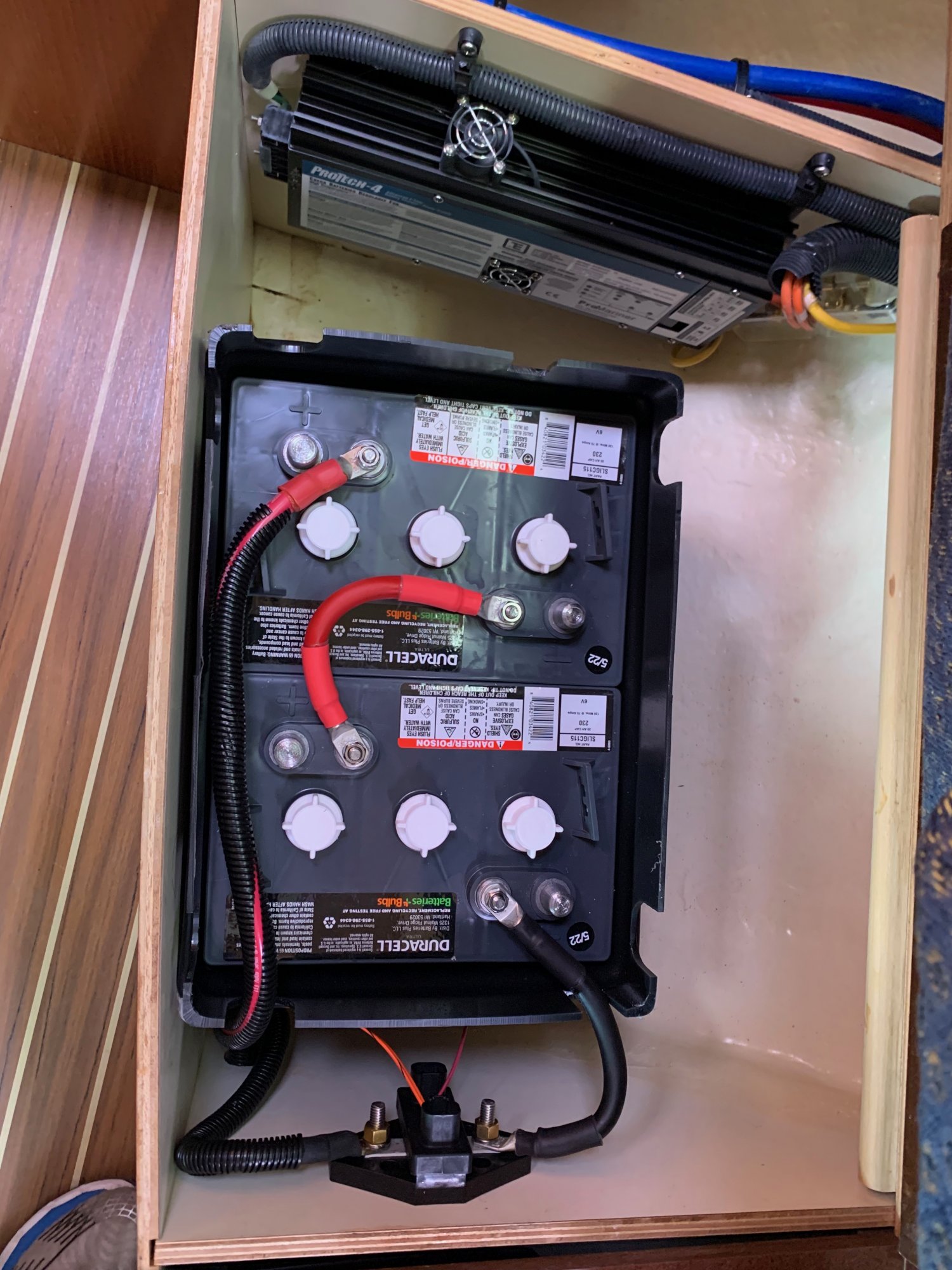

I've just replaced a Group 27 "deep cycle" house battery, which got ruined in just 2 years*, with a pair of 230 AH 6V golf cart batteries (flooded LA), and I'd like to keep them in good shape. I currently have a 2004-vintage Protech 4 charger installed, which is wired separately to both banks (house = now the 2x6V bank, and start = group 24 flooded lead acid). I'd like to buy one of the chargers in your article (say the 15A Victron IP65), but it looks like I'd need 2 different chargers to charge the 2 banks. Is this right? Or perhaps I can just keep the Protect for the starter and use the new Victron for the house bank.
I guess I'm assuming that the Protech 4 is 18 years old, and perhaps (?) not optimal. The documentation that came with it seems to indicate that it does "fast charge", absorption, and float stages. I think it claims 14.8V for fast chargers, and 12.8V for float. I'm not seeing anything listed from absorption. BTW: our boat sits in a slip most of the time between early May and early November, plugged in to shore power with the charger on.

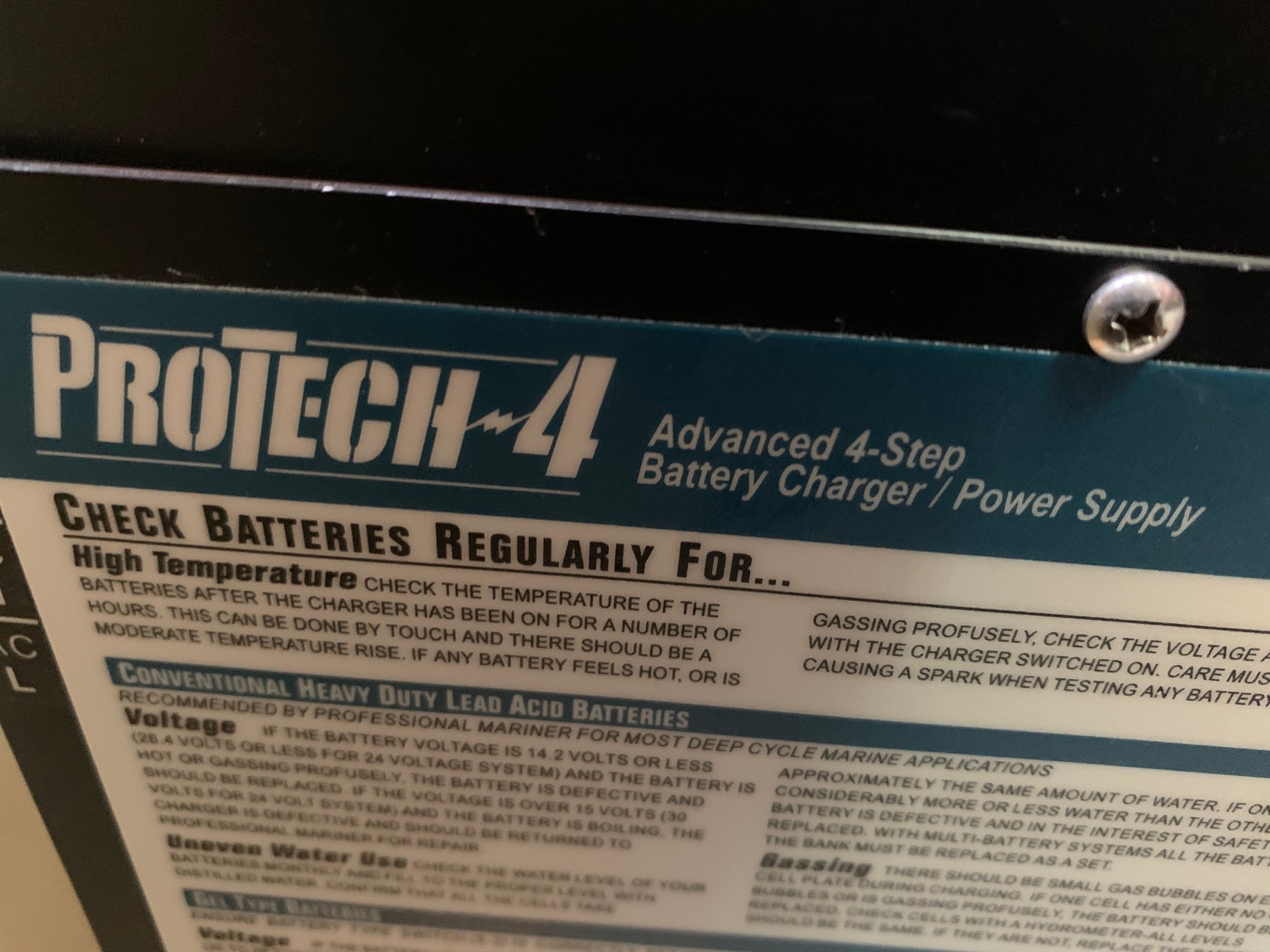

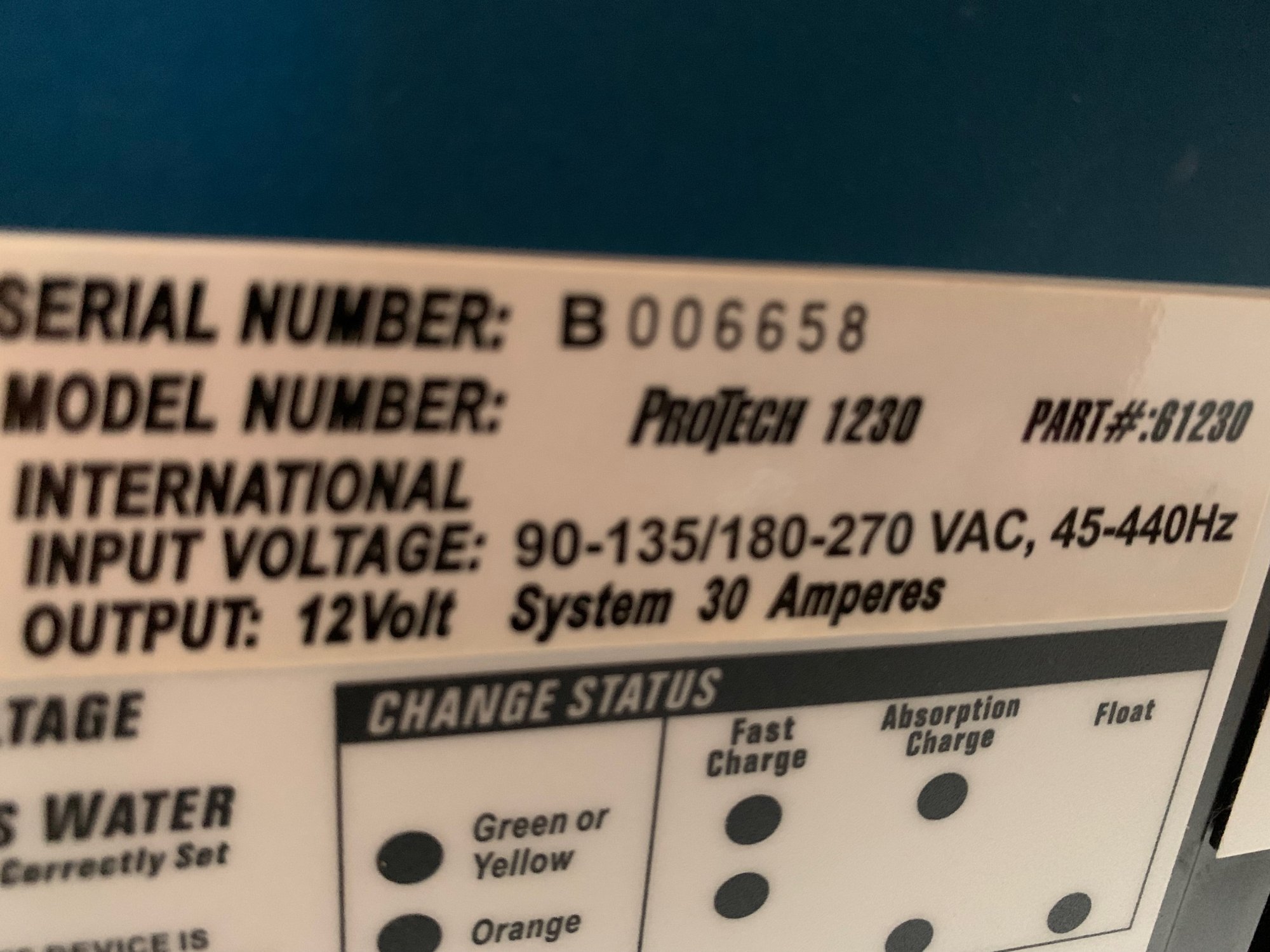

I think you're probably right about needing a bigger charger. I did look more closely at the existing charger I've had since 2004. I think for its day, it was probably a pretty high quality bit of gear. Here it is:
So the existing one has a 30 amp capacity, does multiple banks (which can mean different things: does it charge both banks at the same rate, regardless of what each bank needs?), and has setting for standard lead acid and gel batteries. (I just put in regular flooded lead acid, so fancy options aren't relevant at this time to me). It also has switches to allow 1, 2, 3, or 4 hour absorption times.
So the interesting part, to me, is that I now have a Balmar SG200 monitor installed (as of Sunday), so I have some hard information about what's going on during the 3 different phases. (Not sure what the "4-step" referred to. It supposedly does fast charge, absorption, and float stages.) I've already noticed that during the absorption phase, I think it was 14.3 volts with decreasing current. And then in the float stage, it was 13.3 volts with 0 amps. During absorption, I could definitely hear a boiling noise coming from the brand new GC2 batteries, but even during the float stage, I could hear a much, much quieter hiss from the batteries, even though the Balmar says there was 0 amps moving. My slight concern with this is that they're on AC power 99% of the time for 6 months, so I don't want them to lose water too quickly. But over the past 18 years with a group 24 and group 27 battery, I've generally had to re-water only 1-2 times a season.
Anyway, now I'm thinking I should probably just stick with the charger I already have installed for now. How much am I going to spend to make life perfect for a pair of GC2 6V batteries which cost $300 total, when the existing charger looks reasonable?
To answer your question:
The alternator output (60 amp std. equipment (Hitachi?) for the 2GM20F) goes to whichever bank I have the 1-2-both switch set for. Which is almost always the house bank on a trip. No ACR. Whereas the Promariner Protech 4 charger charges the 2 banks independently, I think.
