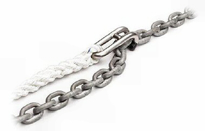

Regarding a snubber, we bought one from Defender made by cs Johnson. It was all made up and at the time on sale. We have been quite happy with it. Picture below.
