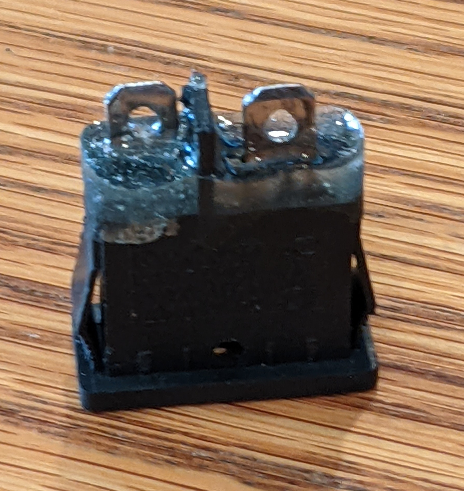

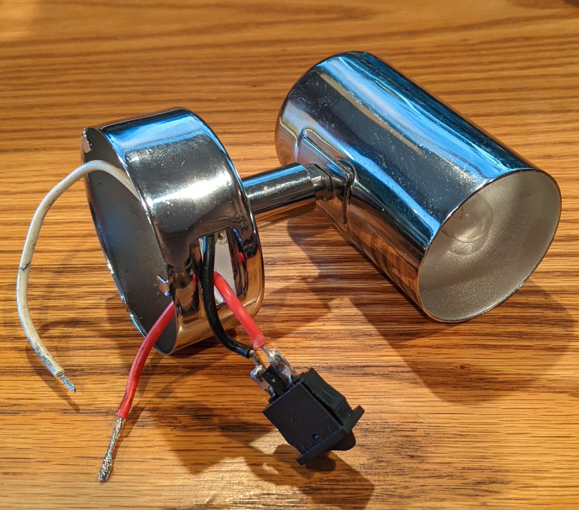

One of the reading lights in the forward cabin of our 2007 41DS has a switch that is intermittent. I looked at the DigiKey and Mouser sites and couldn't find a panel mount rocker switch as thin as this one is. Eventually, I'll probably replace the lights with LED light but I'm not ready to do that yet.
Does someone have one of these sitting around that they'd be willing to sell? Or, does anyone have a tip about where to look for an item like this?

You know, there's a possibility you can take that switch apart, clean the contacts, and put it back together. I've done this to similar switches. I'm surprised you can't find one on Mouser or Digikey, though.

Sometimes, a squirt of silicone spray and exercising the switch can clean it up.

It turns out that the terminals were loose in the switch housing so they would move around, interrupting the circuit, when the switch was jostled. I have it working for now - I wrapped some masking tape around the end of the housing and drizzled in some epoxy to hold the terminals securely. I also cleaned the contacts while I had it apart and adjusted the spring leaf to apply more force to the contacts when closed. So far, it seems to be working.
I love when that happens! Nice job.
