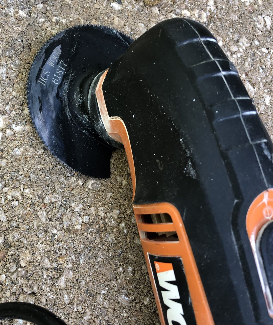

So just a quick update on my project. I ordered my 3/8 thick 24 x 48 plexiglass sheet, from e street plastics. Great folks, great product. https://www.estreetplastics.com/. I ended up cutting it with a vibrating multi tool with a semi circle cutting head.

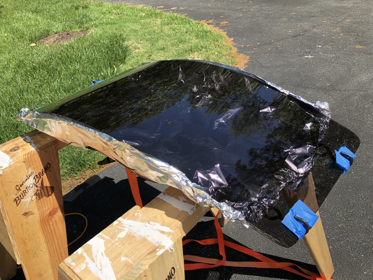

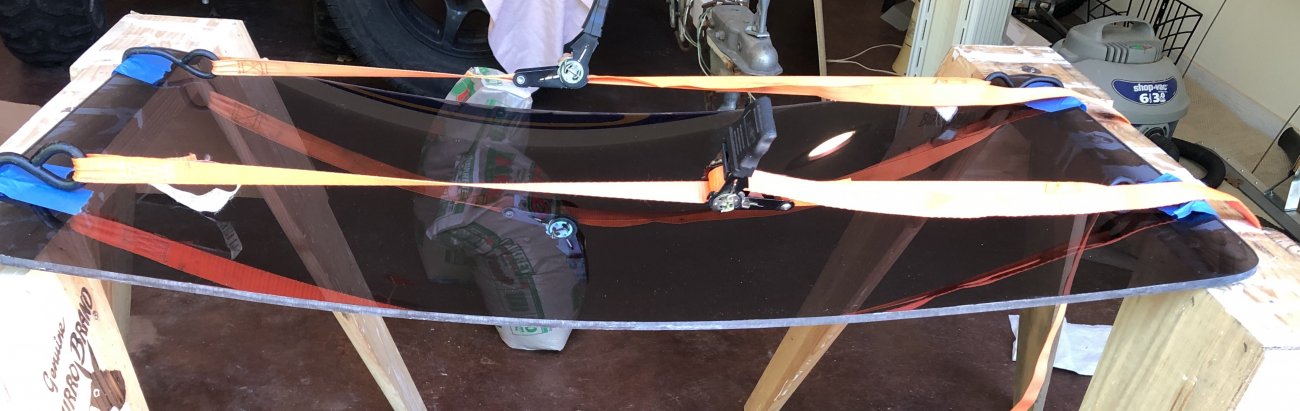

I’ve decided not to drill holes or use screws. This means that I will have to put a pre bend in the window. Without the pre bend most of the caulk would be expunged from the center areas where the pressure would be the greatest. To get the prebend I used ratchet straps a and a heat gun.
I got about an inch of bend using the heat gun but stoped because too much would be as bad as not enough. I’ve created a bit of a solar oven closing in the bottom and let this sit in the sun for a couple days.
Bend came out great. I’ll install it some time this week.

Neat trick with the solar oven. Thanks for posting.
I would have expected that you would have needed a metal flat edge across the hooks on the straps to prevent getting divots in those areas. I love learning something new.

Funny you say that. Actually you are correct. On the second day as I was looking at the window, I noticed the rainbow like circular colors around the hooks meaning some distortion in the plexiglass. I changed and added what you say but it was wood. Took a 2x4 used a date blade to cut a 7/16 inch wide slot and lined 100% cotton gauze in the top. Width of the slot was critical so I would not have to make it too deep as I didn’t want the wood going too far out onto the top surface of the plexiglass. Unfortunately I didn’t take any pictures.
Nice catch.
