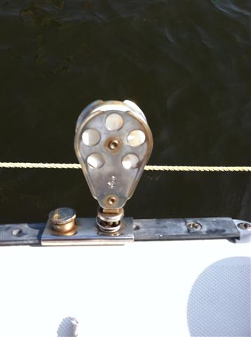

Here is a photo of the block on the genoa track which looks the same as the jib sheet block except it is on a car instead of base.

Yup. That's very similar to what is on my boat. Sometimes the sheaves have a larger hole in the pulley than needed. For instance, I replaced the sheave pulley on my mast head for my Main Halyard. The hole size was 1/2". All I needed was a stainless steel bushing that would fit in the hole and of course the inside diameter of the bushing being narrower allowed me to use a narrower diameter bolt. I was able to buy these bushings or ferules off Rudy where I bought the sheave.
All I had to do was cut the bushing to fit in the mast head.
In fact, I took my mast head off the mast and brought it to Rudy and we were able to match up a sheave to fit.
I'm sure that these stainless steel bushings can be bought at WM or any ship's store.
