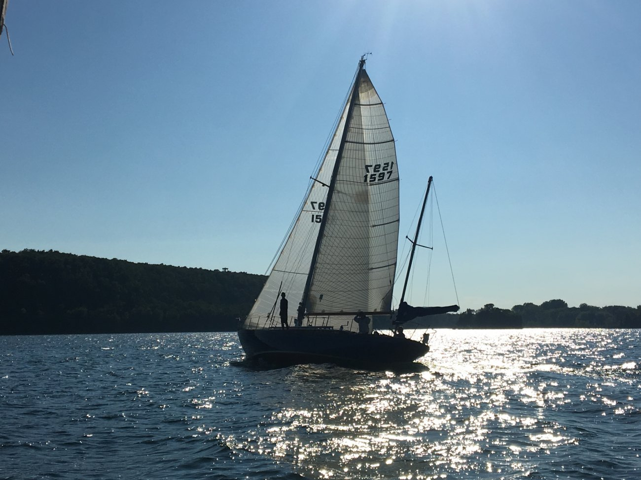

i was up visiting (buying a spinnaker) Al and Sara yesterday. he has built me 14 sails over the last 35 years. was thrilled with everyone of them. yeah, i'm a huge fan of his product.
i have 4 sailboats at this time. the first thing i do with a sailboat is put new sails on them. i fix the other things after that.
Al built these sails for me. we've been buds a long time
