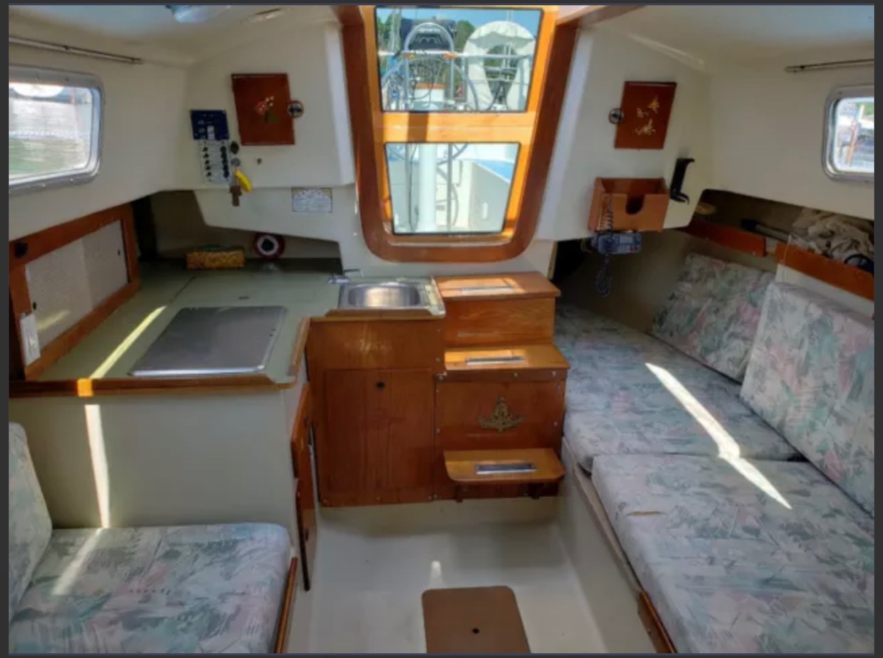

Hey everyone, spring is almost here, I wish!
looking to upgrade my galley in my Pearson30
Need new countertops, thinking about removing the pressurized alcohol stove. I currently use a butane une burner stove. Looking for ideas

Do you have any photos of what you are starting with?

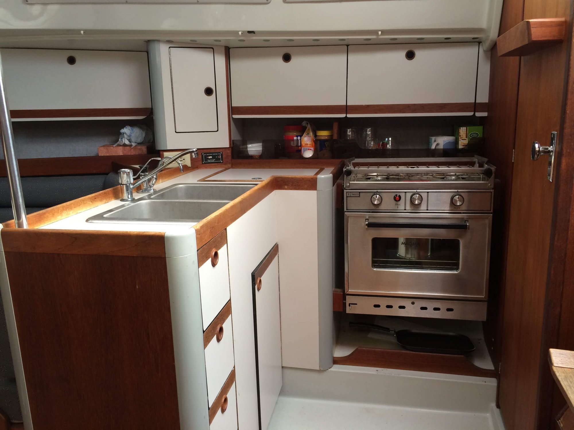

My O’Day 322 has a pretty functional galley and I cook on her a fair amount.
My to-do / wish list for the galley includes:
- New faucet (current one is as old as the boat I think)
- Remove the icebox pump (small hand pump next to main faucet). It doesn’t work, and I have refrigeration.
- Use the space from the icebox pump, and some sort of filtered water tap there.
- Replace the white Formica counter surfaces…not sure with what…Corian would be nice, but expensive.

Assuming you get dirt kicked into your sink from feet/shoes, I'd add a larger divider. Something flexible might help mitigate trips as people walk down the stairs. If you feel that your short on space, I suggest creating a board that goes over the sink. Perhaps a cutting board would be handy

Plus 1 on the sink cover. Not sure how extensive your plans are but be aware that the sink is near the boat centerline to keep it from flooding when heeled; you likely cannot move it to the side.

Not a lot you can do about the layout, I don't think... a flip-up cutting board/counter surface on the forward face of the cabinet would give you more working space. There are some slick prop mechanisms out there for that sort of thing, though a simple wooden strut works too. Another on the engine box side might also work..
If you can sacrifice some berth space you might consider expanding the cabinet forward into the starboard berth/settee area (maintaining a 'two seater' for the table. This would allow more storage space as well... you might get away with extending into the floor/sole area by 6 inches or so for even more volume and small storage down low.
Alternatively you might bridge the gap between the engine box and the portside hull/shelving, leaving space below to allow someone to sleep with legs stretched aft ..

It isn’t very big and not functional at all
You didn’t say what your plans are for the use of the galley…occasional overnight trips?
I don’t see any gimbaled cooker, so I assume not cooking under way. No oven either, so assume you will cook all your means on a burner. As cooking needs are minimal, ditch the large cooker for a small butane unit as you have done. Maybe move the sink (get a bit larger one) to fit where the old stovetop was, and just keep flat step to set the butane Cooker when you want to heat something up,

I have upgraded the icebox to a fridge last summer, I will spend most of my summer on her ( that’s the plan anyways)
I do have a magma kettle bbq to help Witt he cooking, I was thinking removing the cooktop and it’s cabinet to make room for deep drawers

One thing that is unusual on your boat is the sink location nearly under the companionway. On my similar size boat there is a peninsular further toward the bow that contains the sink. The sink is still near the boat centerline. This is just to make you aware and not a suggestion. To make such a modification to your boat would be a huge undertaking.

That sink location is tough, if it were my boat I would move the sink to the starboard counter and add an easy to access through-hull or in-line valve to close off the drain when sailing. I would then make the stairs full width. The cooktop can be replaced with a portable butane stove, stored when not in use - fine for light duty.

What counter material would you all recommend for my galley?
The cheapest would be laminate, but I am also looking at epoxy covered plywood or stainless steel
What would you all recommend?
should I get a second burner to make a more useable galley or just keep the one butane burner?
I was thinking of some « drawers » to house the burner’s on sliding /locking tracks and on top of one of the burners a plate/dish storage and on the other I was thinking of a drawer
by removing the actual alcool stove it gives me room for a good size drawer
And I was thinking about removing the bottom door to make a bigger opening and install a deep drawer for pots and pans.
In front of the sink I was thinking of a drop down drawer for sponges and such.
let me know what you guys think about my plan so far

I made a new galley counter from plywood covered with formica with teak fiddles (from Defender) - looks nice and matches other countertops on the boat. Sorry, I don't have any pictures. SS is hard to work with but would look nice. I like the drawers - much easier to access than reaching in through a door. You can get very fancy with epoxy if you're looking for a project:

We cruised southwest FL for 6 yr and then southern California for another 4 yr in a P30 with that very galley arrangement. Except that we had a thick wooden cover for the sink that fit it snugly, no sliding; served as a cutting board/work area. Had a finger hole for removing it. A two-burner Origo alcohol stove was set in the stove depression at starboard. I don’t see it on yours, but the ice box was pumped out using a Whale foot pump at the base of the cabinet and that connected to the sink drain. So, quick and easy to drain ice melt and replace. The very large icebox held enough fresh stores for easily more than a week. We also had a hinged shelf there at the starboard settee that could be raised and locked. Another work station. The offset steps allowed someone to work at the galley and not block access to and from the cockpit. Actually, it was very functional. Although b/c our trips were short we did not do much hot food preparation while underway. But hot breakfasts/dinners at anchor, no problem!

Forgive, but there is no reason to widen the steps, or move the sink. Cover the sink with a 1/2” wooden plate, fit it snugly; not a problem. An Origo will cook just about anything you might wish to make in a skillet or pot while cruising. Have a kettle grill aboard for steak, fish, chicken breast, etc. Can bake potato in the grill. Full use of “the galley” depends to a certain degree one’s cooking skills and the practicality of the meal plan, etc., and auxiliary equipment.
Seems to me that adding this one thing would greatly improve the functionality of this galley. I have just such a flip-out shelf on my E26 galley, just forward (to the right of) my built-in 2-burner Origo. (My galley is on the port side.) Very important for food prep.
These work quite well. If the boat is currently fitted with a pressurized alcohol stove, I think I'd swap it out for a two-burner Origo. That's what I've got on my E26 and am happy with it. I also have a one-burner portable butane "chafing" stove. Although they also work just fine, I prefer the built-in. I don't normally keep it aboard the boat, but if I ever felt I might need an extra burner I could always bring it along and toss it a locker until needed. On a 26 footer storage space is at a premium, so that's why I don't normally keep it aboard. In practical life I find that the two-burner Origo does everything I need.
Really, I don't think this galley is all that dysfunctional. Adding the hinged shelf would add much-needed counter space for food prep and improve things greatly. And it is an easily accomplished mod. Between that and a decent built-in stove I think it would be very serviceable.

It’s been a while since we had the P30, but I think we did have some pad eyes around the Origo stove that allowed us to strap a pot to the burner while cooking, if needed. Also, there was a strap that could be attached to pad eyes across the front (inboard face) of that cabinet so the crew cooking could buckle-up if needed to free the hands.
