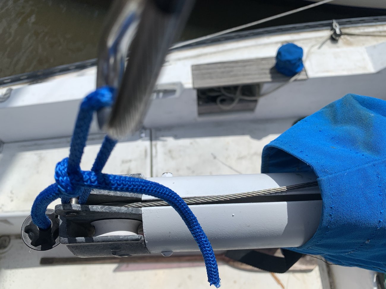

There is a cable coming from the top of the mast that hooks onto the back of the boom and supports it. Looking at the owners manual, I believe it is called a boom lift.
On the boat I just acquired, the cable was tied onto the back of the boom with a small piece of para cord that broke on our first outing.
I’m trying to properly rig this and would appreciate it if anyone else had photos or descriptions of the proper way to rig this lift to the boom

After taking a closer look at the boom, I’ve actually figured out that there are two pulleys at the end of the boom. One for the topping lift and one for the outhaul. The run inside the boom and cleat at at the mast. Unfortunately, the previous owner let these rot away and was using paracord to attach the boom to the topping lift cable on the mast. I am going to have to dismantle the boom and rerun these lines.
Currently the weight of the boom is being suspended by the leech of the sail. Ugh!
Thanks, I’ll take some photos of the redo to share.

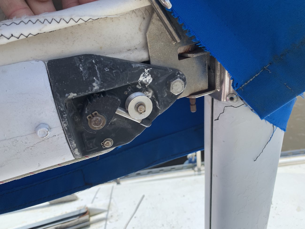

@nickvillaume that block and cam cleat are for a reefing line that passes through the boom from the leach of the mainsail. The line first ties to a ring on the aft end of the boom, passes up through the first reef cringle on the sail, then down through a sheave on the aft end of the boom, then through the boom to the goose neck on the mast.
