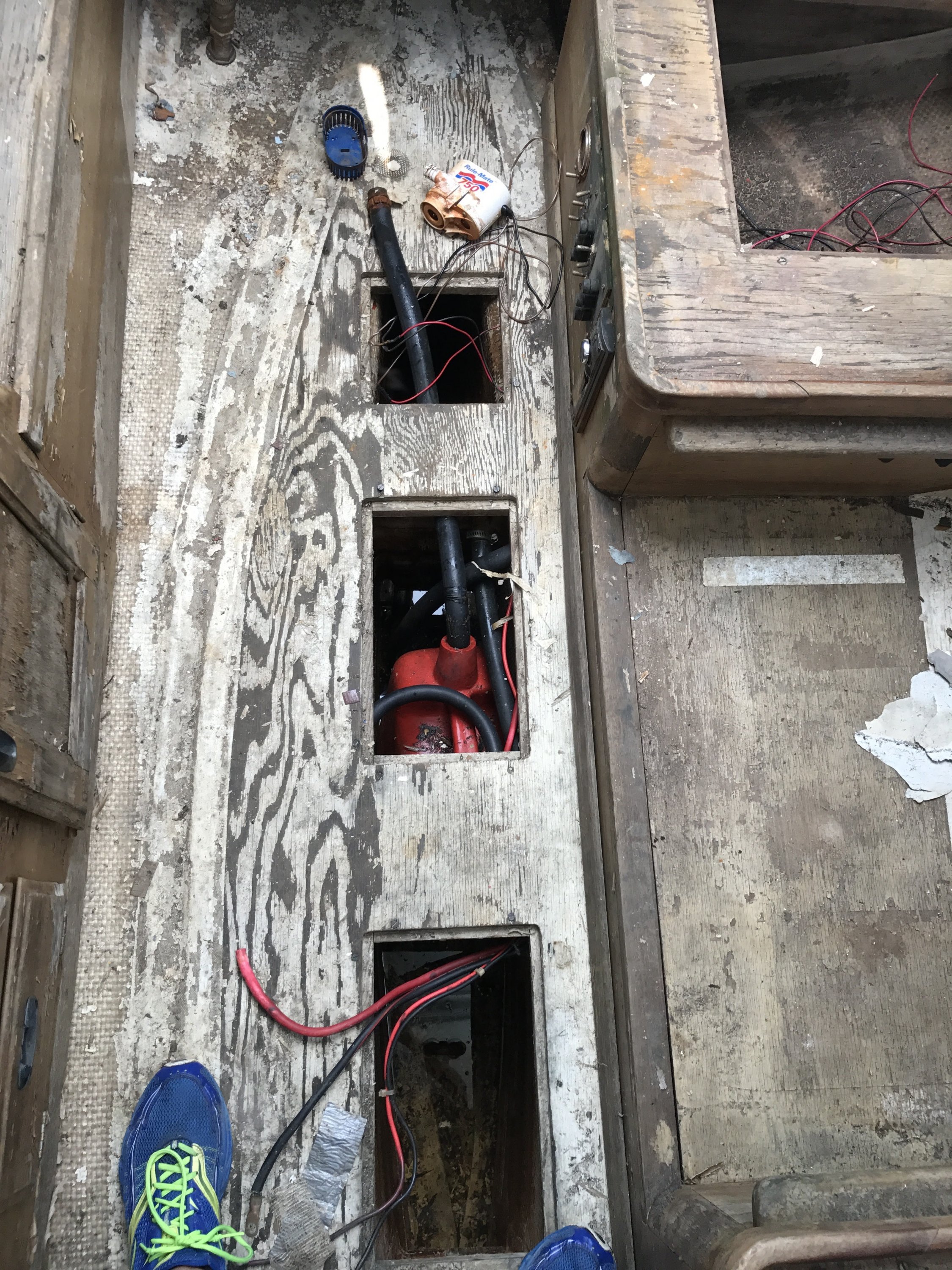

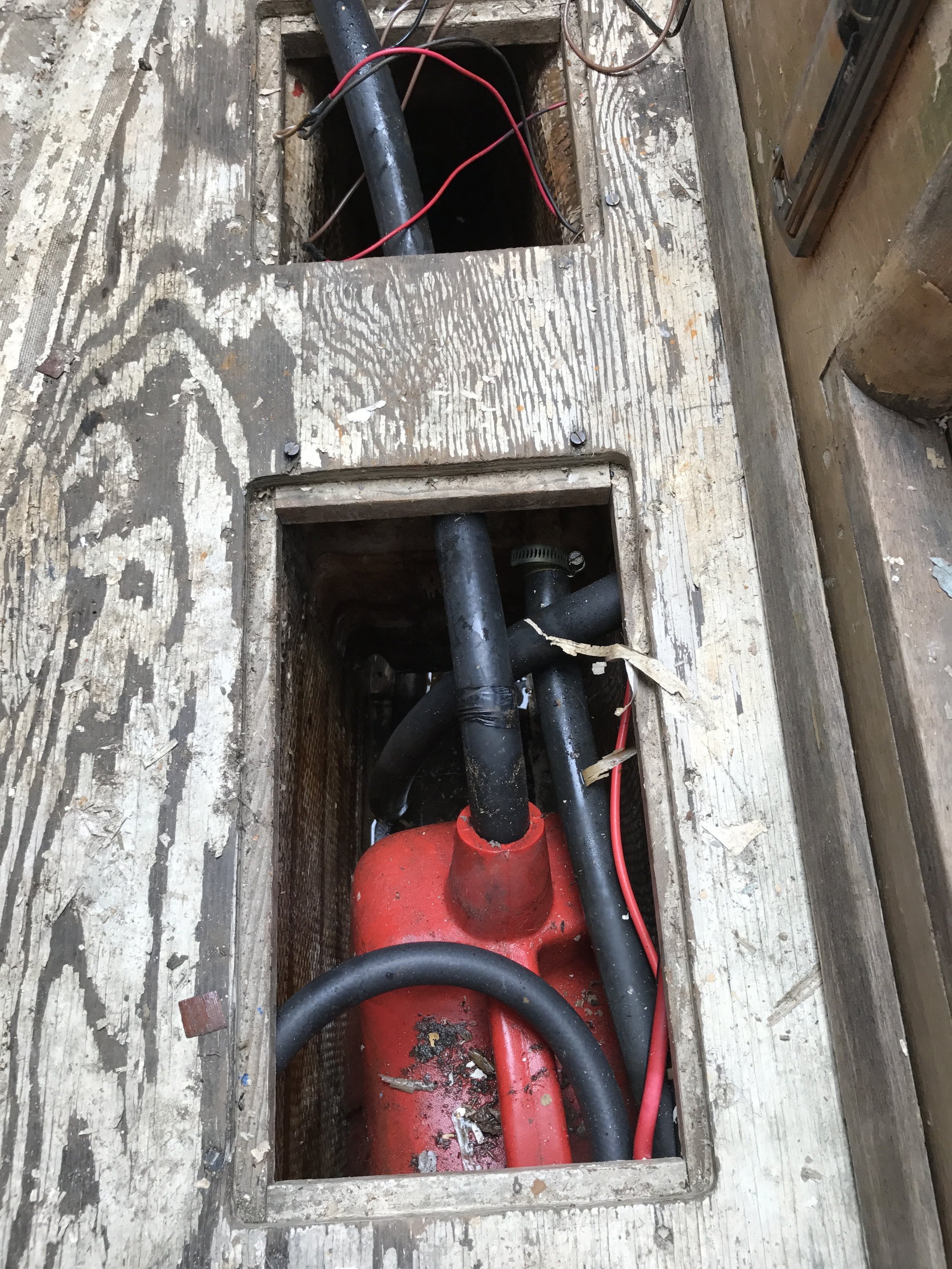

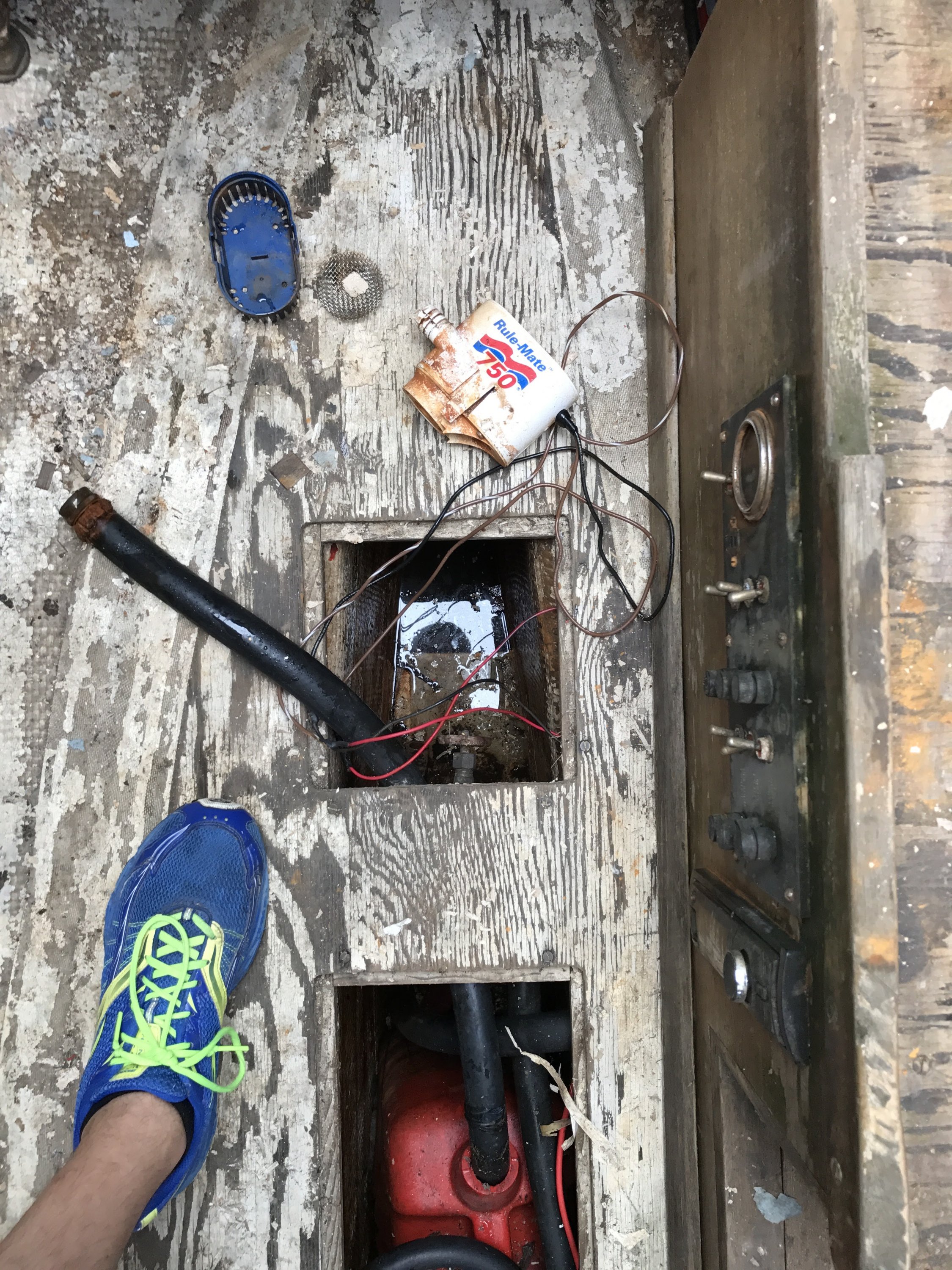

I've not found much previous online regarding my question... This has 3 through-hulls on each side of boat, one along the top of the fixed keel (facing out), and the other 2 up higher on the bottom of the body (facing down), but all UNDER the water line. As I've removed the old bilge pump and purchased a new one, I'm not sure exactly how this system of hoses and big red plastic jug works, especially with the through-hulls under water line. Is this what people refer to as a 'Loop' system?
Also, in trying to find where the hoses all go, one of them goes directly side-ways and under the wood floor (i'm assuming to the through-hull in the side of the keel). Not sure how I would even get to that to check it or replace the hose without removing the floor. I would assume that the hoses and fittings would be good to replace since they are relatively cheap and easy to replace. But I'm not sure on that 'easy' part.

Trace the various pipes. Perhaps you can pump water or air into the boat. If you open then close tha valve you might get an answer to which pipe is under water.
My bilge comes out above the water line not below.
14,219
Have you visised the Cal 25 Owners Association website? CAL25
Bilge pump hoses should exit above the water line.
Some thoughts. The head can have 3 three through hulls, a sink drain, head intake, and head outflow. The head outflow should be fairly large, 1.5".
The galley sink will have a drain and through hull.
There are 2 cockpit scuppers that probably drain below the waterline.
An old solution to draining water from the ice box was to drain it into the bilge or into jug in the bilge. The hose going into the jug could be for that.
