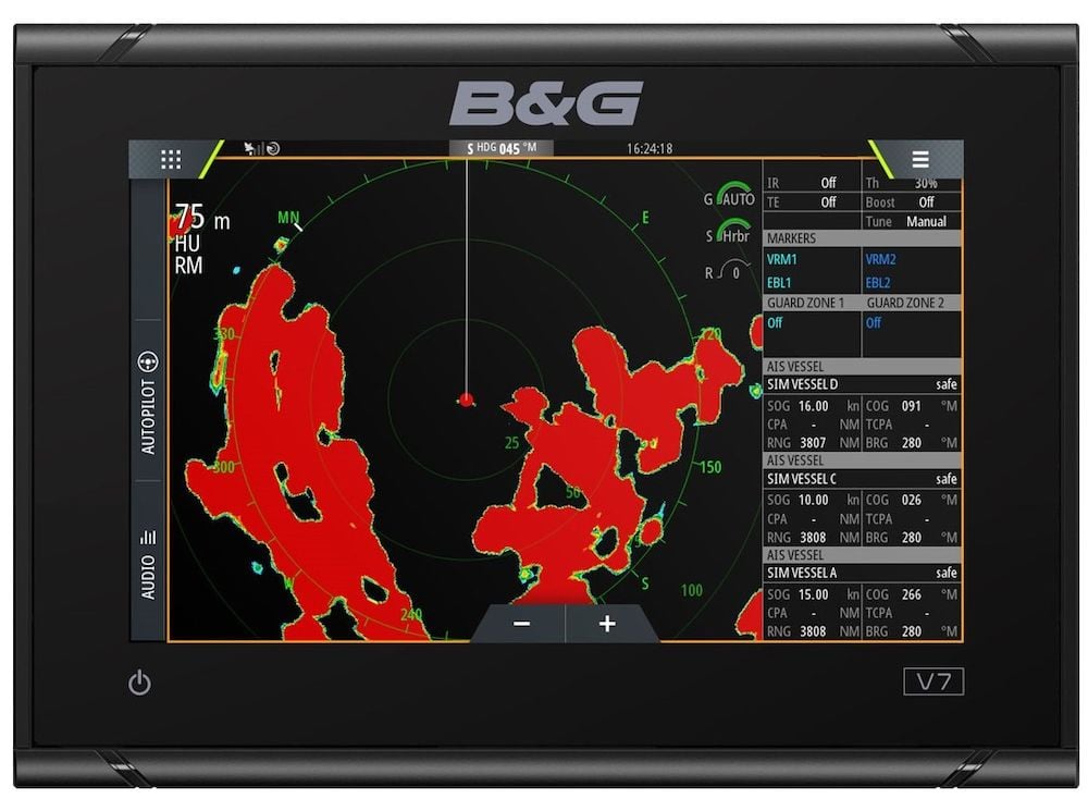

I found a sale on a B&G Vulcan 7" for $600 and am moving it to the new boat. It is GREAT, especially after a Garmin 541. The menus, set-up options, and lay-out are much more intuitive for a sailboat than any of the Garmins. Plus, it can live at the nav station below and mirror to a common iPad at the helm or anywhere else. (My helm is covered by a bimini so wetness is not much of an issue.) Because it's real NMEA 2000 and NOT in the limited Raymarine Seatalk architecture, everything hooks up with no problem. The Standard Horizon AIS plays seamlessly on it.

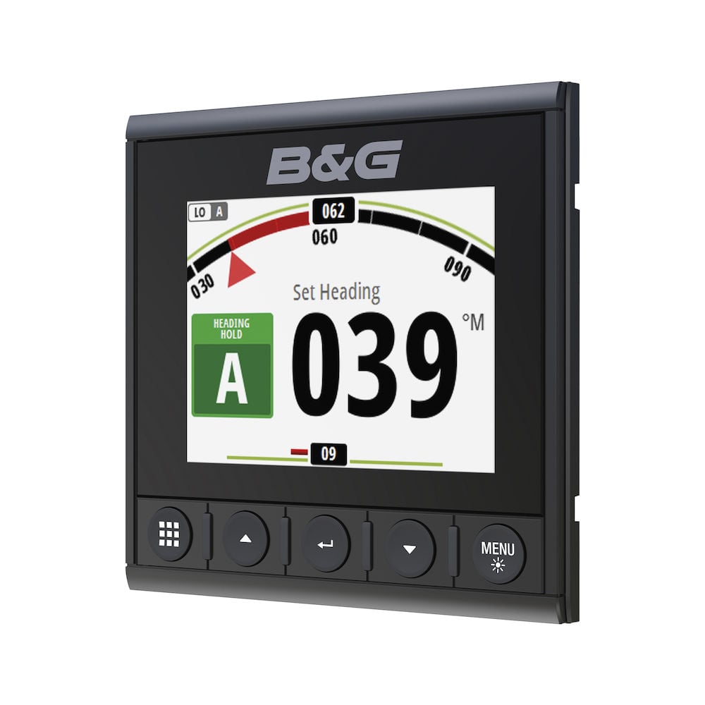

If I had to do it all over, I'd probably hold out for the Zeus version at twice the price because it is the same thing with physical buttons and knobs. Again, the B&G was designed for sailing. But the Vulcan/iPad combo does fine as-is & I hope to add a B&G Triton2 display at the helm soon.
